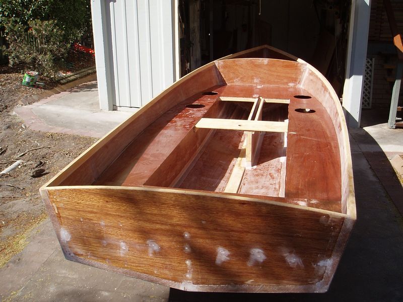

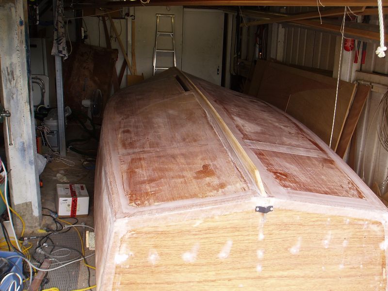

wardm Posted September 23, 2007 Posted September 23, 2007 Just sharing some pictures of S10 #524 which I completed on the weekend as a new tender for our AZULI F40 Cat. General Spec's; Gaboon Ply Hull Foam Sandwich Blades Alum mast base/Carbon mast top (old sailboard mast) Hopefully I will get the sail this week so we can try her out. Does anybody know if there are any other Spindrifts in Australia ? Quote
P Doug (WA) Posted September 24, 2007 Posted September 24, 2007 Very nice looking boat. Wish you a good sail and hope you get pictures of the launch and sail. Quote
Greg Luckett Posted September 24, 2007 Posted September 24, 2007 Wow, another beautiful Spindrift. Congrats and it is a nice looking boat. I am inspired to get busy again on mine. Quote
john_banfield Posted September 27, 2007 Posted September 27, 2007 Nice boat. Are you in Sydney? I'd love to have a look. We live in Darlinghurst, and just ordered the 11N plans. Cheers, John Quote
wardm Posted September 27, 2007 Author Posted September 27, 2007 Sorry, we are in Brisbane. I just received my sail yesterday, so I hope to try her out this weekend. I will try and post some photos of her sailing next week. Quote
