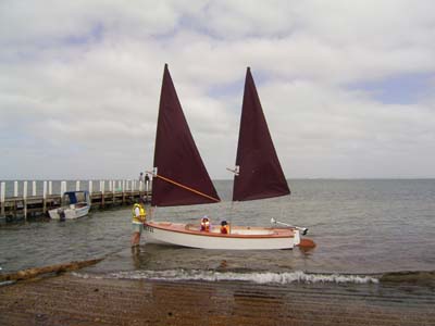

Peter Batchelor Posted January 19, 2006 Posted January 19, 2006 CS17 #122, Kirsty Ann, is more or less finished (just the dodger to go), and has been launched here in Melbourne, Victoria, Australia. I built her in a garage that is 17' deep and 16' wide, with a verandah at the front so that I could roll the cradle out when I needed to gain access all the way around. Now that she is on her trailer, she fits diagonally into the garage, in an area 17' by 14'7", with a couple of inches to spare. Everything has had several coats of epoxy, and the hull and cockpit painted with Aquacote (an epoxy based high build undercoat that is quite easy to fair and a polyurethane topcoat that is incredibly hard). The deck has been painted with several coats of clear Aquacote, which has an ultraviolet inhibitor added to it. Both the epoxy and the paint were by Boatcraft Pacific (http://www.boatcraft.com.au/index.html). The bottom chine, and half of the upper chine, were fibreglass sheathed. Rubrails, sprits and tiller have been finished in Deks Olje. Everyone is very pleased with the results (me expecially), and we're looking forward to lots of time on the water this summer, and we are planning a couple of weeks on the Gippsland Lakes in March, which is why I need to get on with finishing the dodger... The info that I found in this forum made putting the boat together much easier - so a big thanks to all of the forum contributors. Peter Quote
Joe Sundstrom Posted January 19, 2006 Posted January 19, 2006 Congratulations. I just can't get enough of that cat ketch look, i'm glad you had the sails raised. Quote

Kidd Posted January 19, 2006 Posted January 19, 2006 That boat looks great! I was wondering how well that trolling motor moves her. I am planning to use one for auxilliary power when I get hull 113 finished. (This spring for sure). Is it adequate for running her up to the trailer and that kind of thing? Quote

Peter Batchelor Posted January 20, 2006 Author Posted January 20, 2006 That boat looks great! I was wondering how well that trolling motor moves her. I am planning to use one for auxilliary power when I get hull 113 finished. (This spring for sure). Is it adequate for running her up to the trailer and that kind of thing? We've used the Minn Kota Riptide 55 long shaft model, which draws 50 amps/hour and delivers a maximum of 55 lbs thrust. I've only had her in the water once so far, but the motor was able to push against a 20 kt headwind without any problem. It certainly wouldn't be any good for pushing the boat up onto the trailer though.... We're planning on using it mainly for pottering around rivers, and on the days when fishing rather than than sailing is more of a priority for our 5 year old :-) Cheers, Peter Quote
