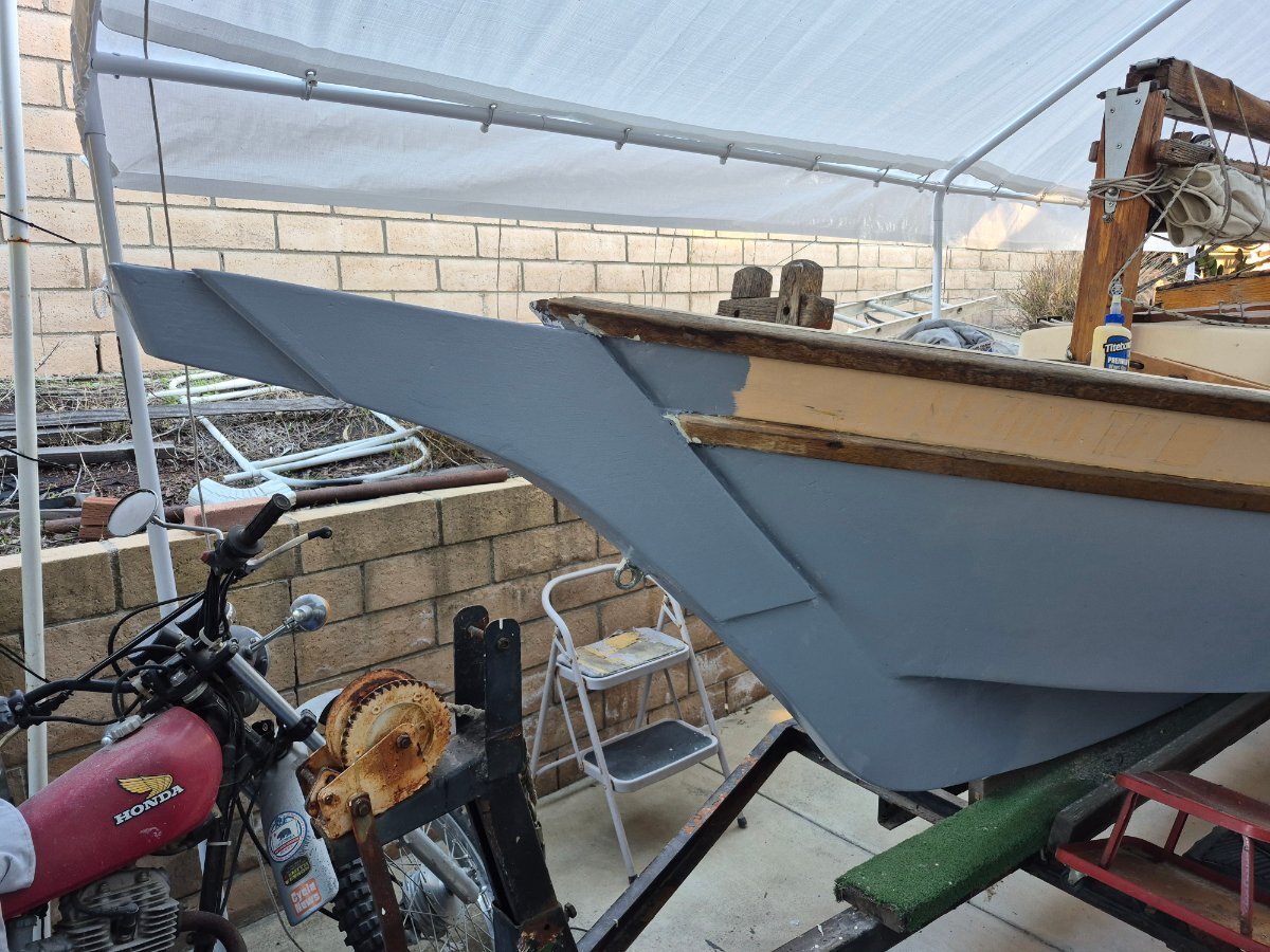

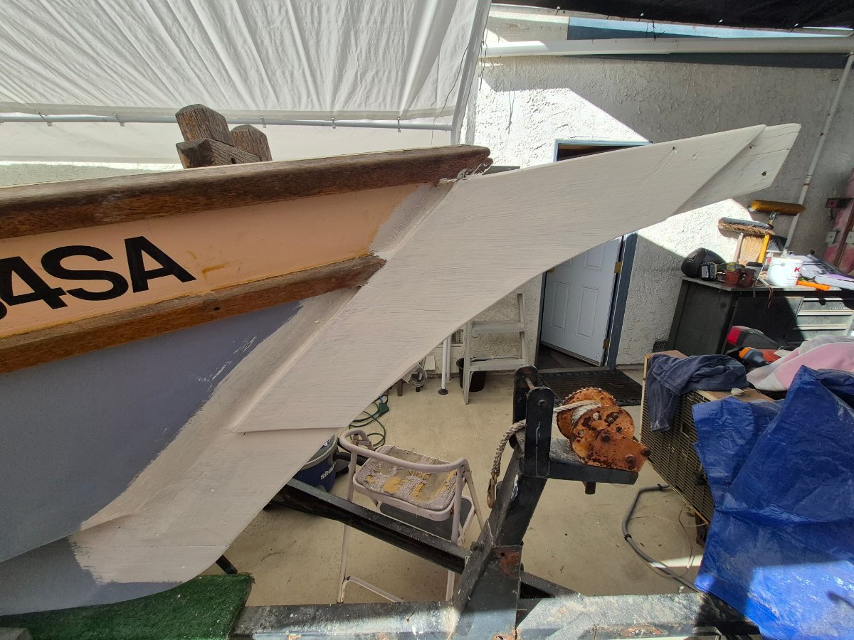

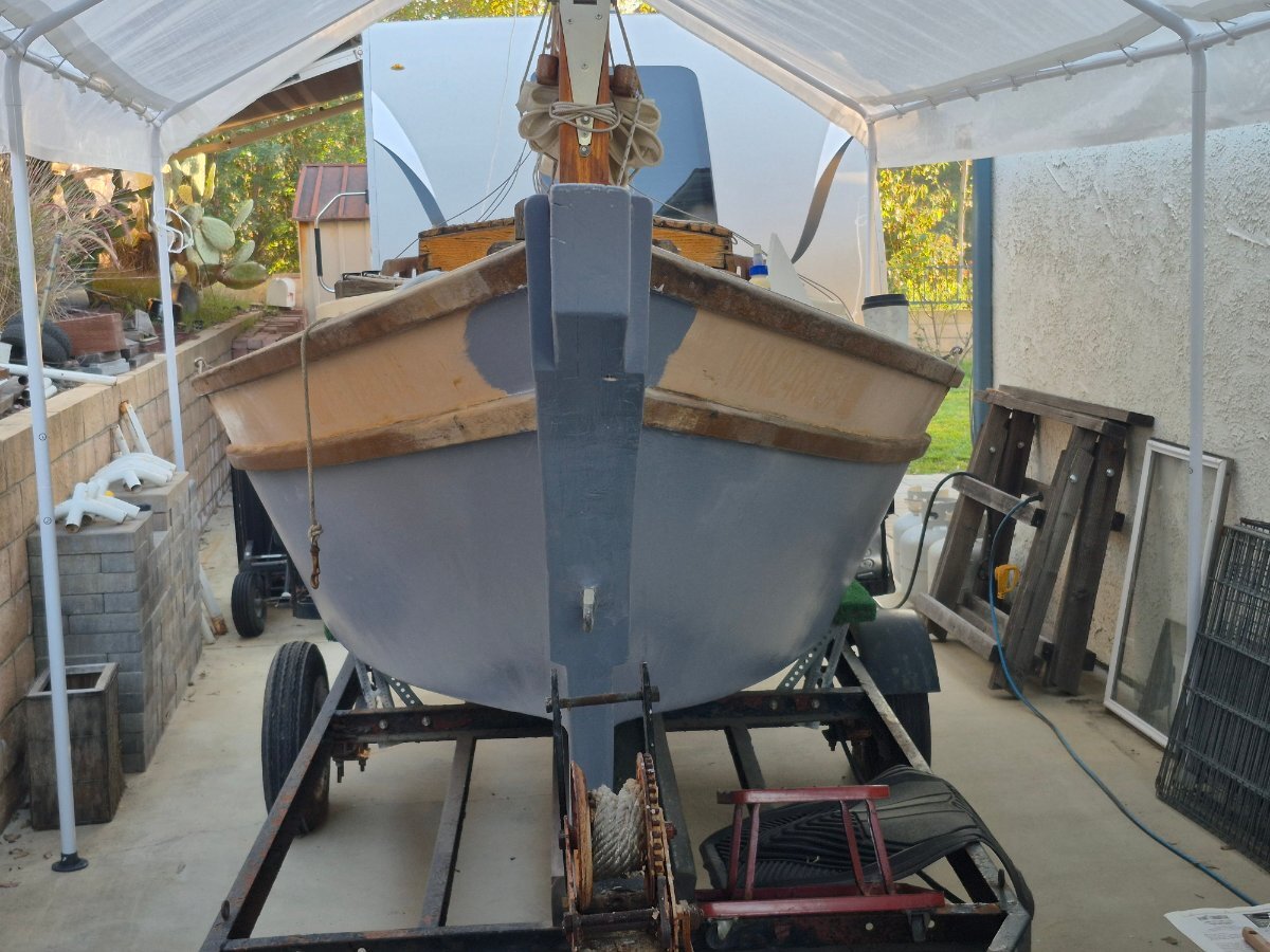

Brucel Posted November 29, 2025 Author Posted November 29, 2025 I couldn't stand it any longer, I had to paint the bow. I used Kilz primer and a chip brush. I wanted to see how the bow would look with those two boards attached to the sides. I think I can live with that look. When I remount the tail boards it might not seem like such an obvious patch. On the backside of the bow the wood that looks rotted is still hard as a rock. I can't really dig it out with my little oscillating saw; I would have to use my 4 inch grinder. I think I'm just going to cut off the peeling fiberglass and re-glass it. It's above the waterline and under the deck so it won't be visible or exposed to weather. Quote

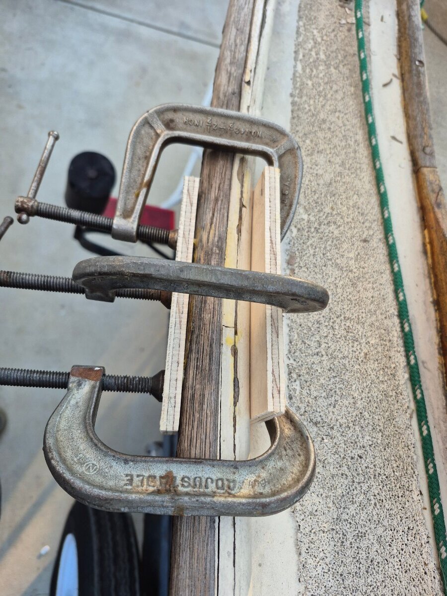

Brucel Posted December 1, 2025 Author Posted December 1, 2025 Oh-oh, I didn't think of the sandpaper aspect of that. Think I'll just stick with walnut shells as the boat is already covered with it. The real bad spot is the cockpit floor. I think I'll use slightly thinned paint on those walnut shells so I don't loose too much texture. On the back of the bow I think the wood is in pretty good shape, I've just got some delamination between the three original keel boards. I'm planning on re-gluing and sistering a permanent wooden clamp around the three keel boards. I need to find a good bedding compound that will glue and water seal the deck patch. Something flexible and paintable. With the possible flexing of the bowsprit I think glassing the bow under the deck patch would be too brittle. I intend to make leaks around the bowsprit and bow impossible; this is the only area that has water damage. Quote

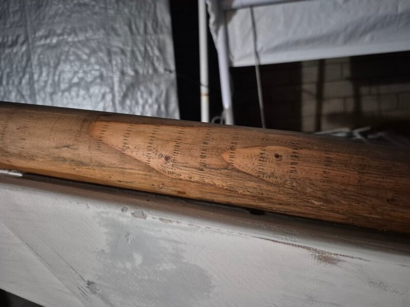

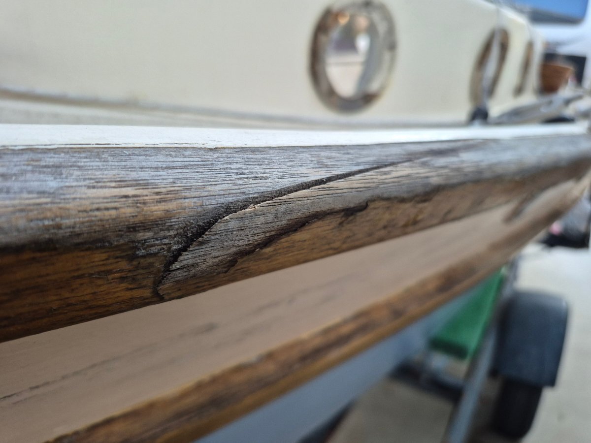

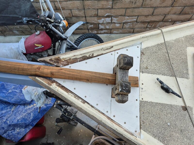

Brucel Posted December 2, 2025 Author Posted December 2, 2025 I'll take anything Aslan related, can't wait. I might have to replace the bowsprit. I used the old spar varnish on the bowsprit to test it and it really magnified the rot right in the middle. The end hole (white area) is for the jib stay and the middle hole (rotted area) is the hold down (club foot) point. I'm worried that if the jib stay is stressed the bowsprit will break. I could use more bolts on the sprit and make more water ingress points, or maybe make a new sprit. I do have a full size model. Quote

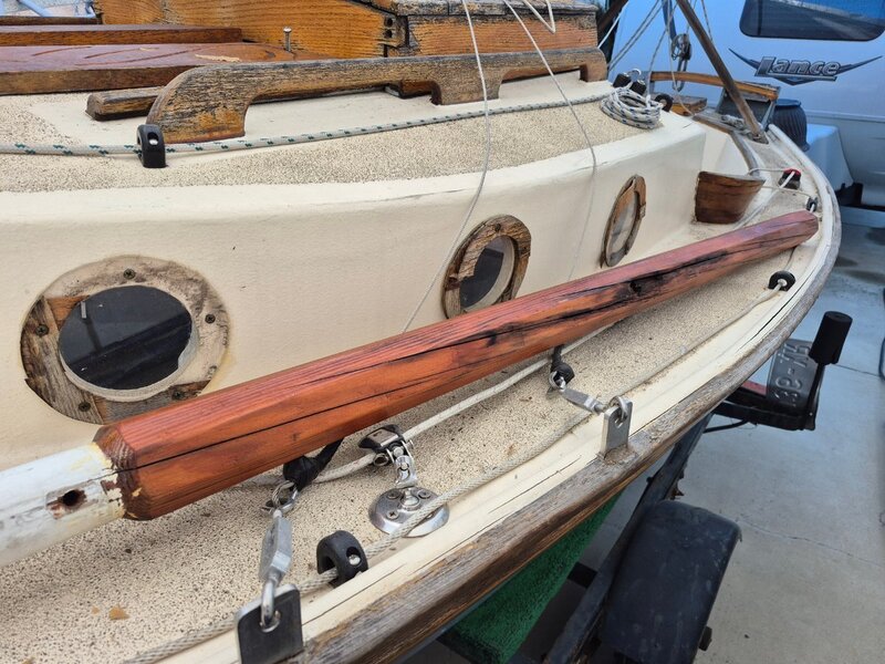

Brucel Posted December 2, 2025 Author Posted December 2, 2025 In looking at the pics you can see the the damage I've inflected on the bright work. The portholes is why I was looking for 6 inch wooden rings (see my post in mast hoops). Wood rings are measured on the outside diameter, 6 inch OD equals 4 inch ID. I thought I could stand the rings up and slice them in half for porthole trim rings. My better judgment kicked in and I bought a 4 inch hole saw. Cut a 4 inch hole in a board and trim the OD with my bandsaw, much safer. Quote

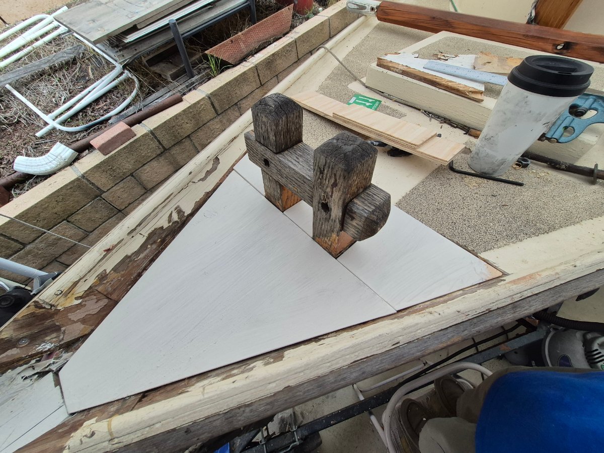

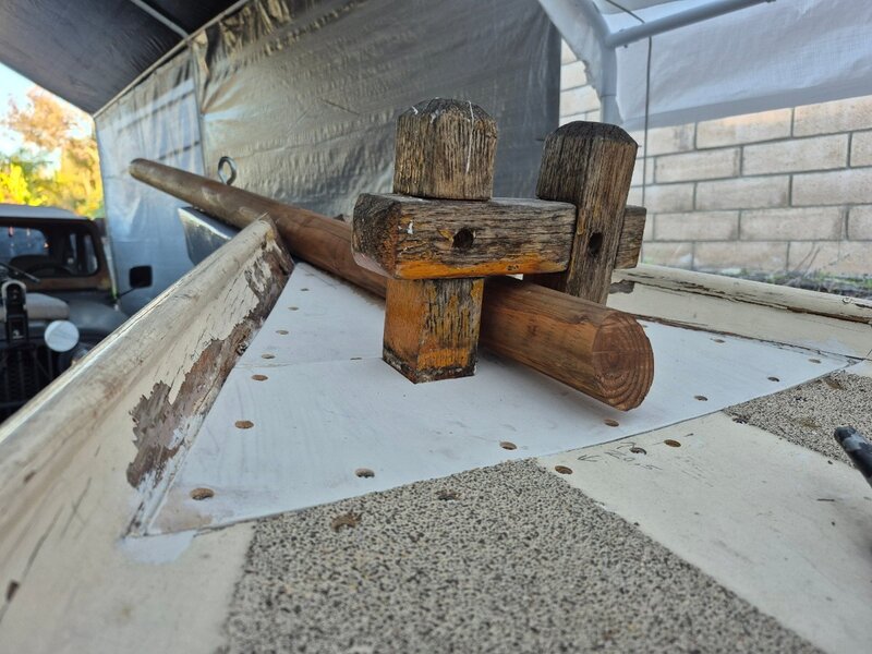

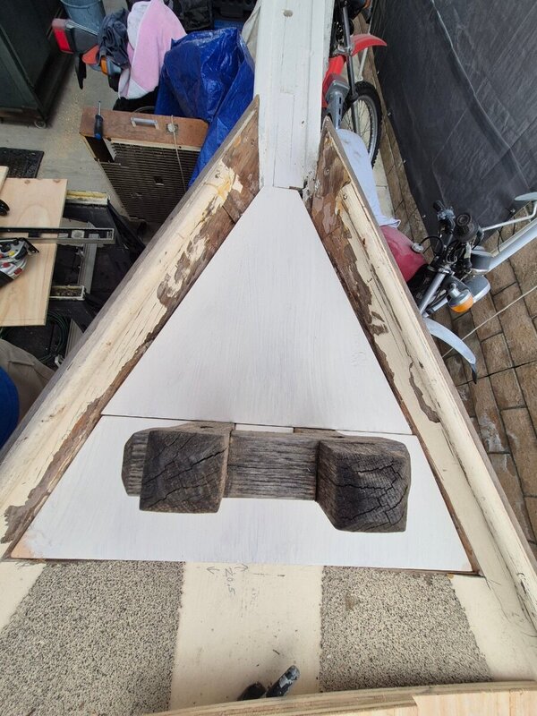

Brucel Posted December 2, 2025 Author Posted December 2, 2025 Ok, deck patches are fitted and first coat of primer is on. The two strips in the second pic are going to be joiner pieces, they'll be primed times two also. They'll be screwed to the existing deck and three pieces screwed to the patch under the bit, then screws all around. Still have to do the repair work on the backside of the bow and paint before the patches get installed. Also spread some bondo on one side of the bow to see if I remember how to do it. I do remember, but mainly I remember how much I hate sanding bondo. Quote
Frank Hagan Posted December 3, 2025 Posted December 3, 2025 I'll bring whatever I have on Christmas. The repairs are looking good. The bowsprit really isn't under a lot of tension, so it's way overbuilt. I think the original was a 4 x 4 with the edges cut off at a 45, then the end rounded down for the tip. Quote

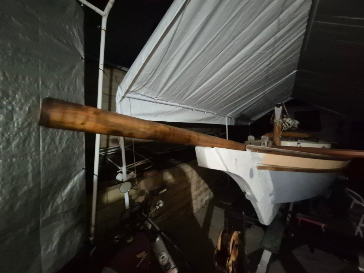

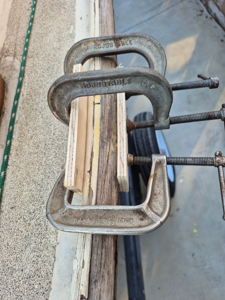

Brucel Posted December 4, 2025 Author Posted December 4, 2025 Had some successes and a fail today. Got the second coat of primer on the deck patches, spread more bondo, and did some sanding on the bow. The bowsprit is 2 1/2 inches across the flats. No wood at Home Despot is 2.5 inches square. Wait a minute, tree poles (for bracing newly planted trees) are 2.5 inches in diameter, they're 8 feet long, and they're only $ 9!!! I paw through a pile of poles and find a straight one with small knots. Score! I rush home and spend two hours sanding off the green stuff, cut it to size and put some stain on it. Dammit. To make the wood bug resistant they cut a million little slits so the green stuff will soak in. Those slits were not visible until the stain penetrated them. Now it looks like my bowsprit was wrapped in bob wire (barbed wire). Sigh. My choices now are paint it a solid color, laminate something up and trim the corners, cut down a 4x4, or build a 6 foot lathe and machine 1/8 inch off the diameter. Trimming off corners or cutting down a 4x4 will require a table saw. My table saw is under that pile of stuff over there in the corner, I can't even see it right now. Guess I should have cleaned up the garage before I started all this. Quote

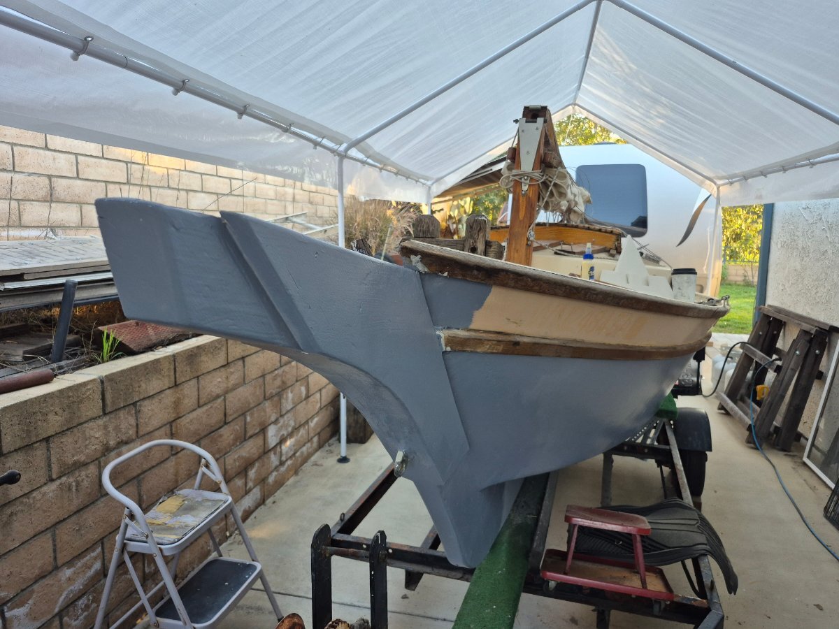

Brucel Posted December 5, 2025 Author Posted December 5, 2025 Finally some visible progress! I decided to do something other than the bowsprit. I know, I'll sand bondo! Woo-hoo! That 3M purple sandpaper is amazing, bondo doesn't clog it up like sandpaper in the olden days. Three hours later the bondo is sanded enough to put a primer coat so I can see what I need to touch up. One hour later I can see a couple of areas I'll have to re-bondo. Wonder what it would look like if she was painted? One hour and twenty later I achieved TA-DA! She looks so much better without all the fiberglass and wood showing. I'll give the paint a day or two to cure then touch up the bondo and put on the second coat. Still have to do something about the bowsprit, finish up the back of the bow, and patch the deck. Then I get to start on the bright work I let get so bad. Quote

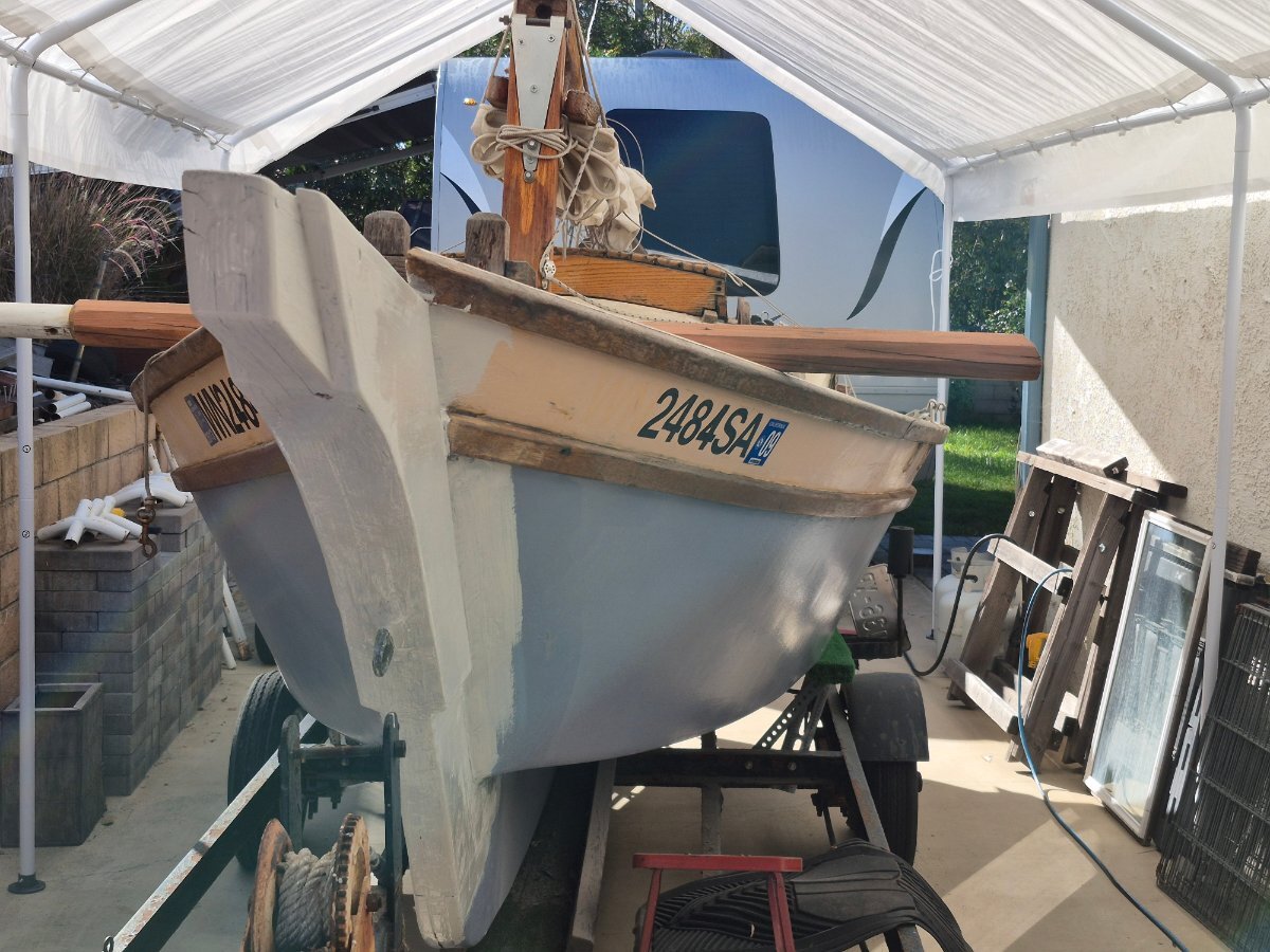

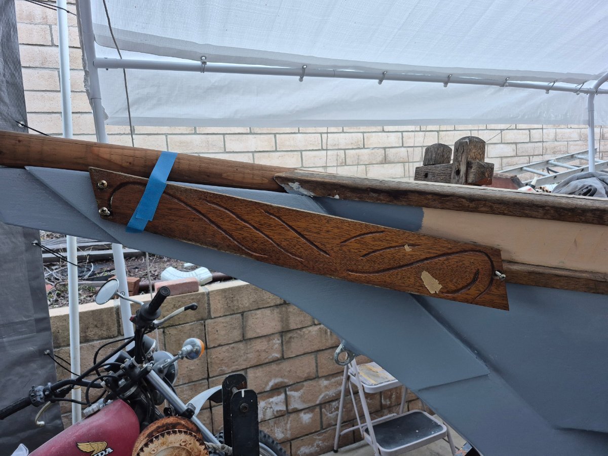

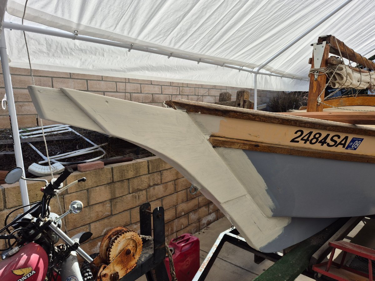

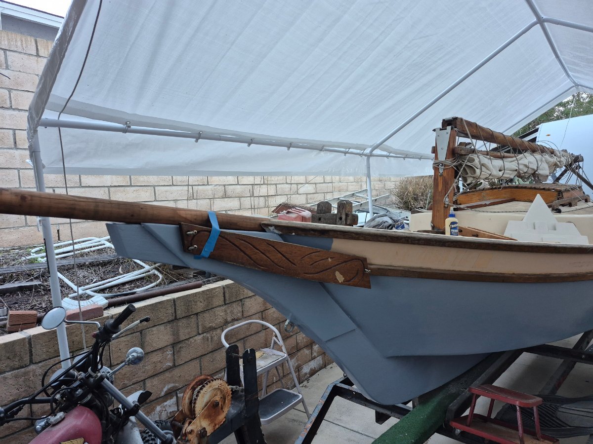

Brucel Posted December 5, 2025 Author Posted December 5, 2025 Here's how she is going to look with my "bob wire" bowsprit and the original trail boards. I don't know that the trail boards really camouflage the reinforcements on the bow. It had to be done and I'm glad my son did the fiberglass work. The fumes from resin makes me nauseous and gives me a headache. I'll never be able to do stitch and glue boats. That can be really limiting for me these days if I ever want to build a boat, so many cool boats are stitch and glue. Quote

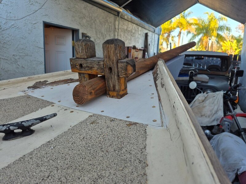

Brucel Posted December 6, 2025 Author Posted December 6, 2025 I finished the inside of the bow, I forgot to take pictures. Basically I covered the wood with Locktite PL Marine adhesive. I used the Locktite to glue and screw the joiner on to the deck, glued and screwed the aft patch, glued and screwed the forward joiner, and finally glued and screwed the forward patch. Looks like I'll be making shims for the bow point and bit. The bowsprit doesn't lie on the deck like the original probably because the forward keel extension is on a different angle since the rebuild. I'm also trying to save the scarf joint on the starboard side, it was sticking out about 3/4 inches. I glued it with Titebond II. I was afraid it was going to break when I clamped it but it seems to have survived. The scarf on the port side won't be so scary. I'm glad to be saving stuff on Aslan instead cutting off pieces and tearing stuff up. Quote
Frank Hagan Posted December 7, 2025 Posted December 7, 2025 If you get me the dimensions of the original bowsprit I can make one up and bring it down to you. It was made out of a 4 x 4 that Dad had bought for the patio cover on Parkview street, one of his last big projects, I think. I need the overall length, the length of the white tip (I think it is 7"), and the dimensions of the "hole" in the bits that it will have to fit through (I think it is about 3" x 3", but I'm not sure). Repairs are looking good so far. I think those scarf joints were held together with Weldwood Wood glue and not epoxy. They should have not separated in any case, so we'll have to blame the shoddy workmanship of that original builder guy! Quote
