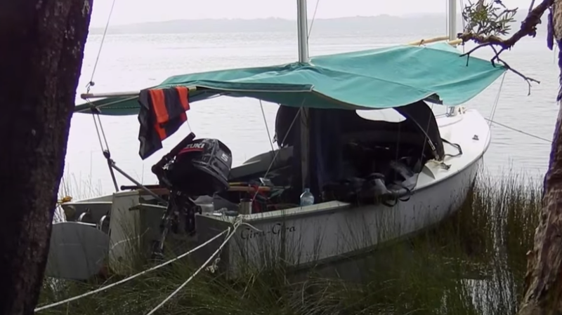

Note that on the shelter shown above in PPs post, on the Sea Pearl, the main boom is removed to allow room for the tent.  They tie the boom to either the mizzen boom or the main mast with velcro straps.  On my Core Sound, I tie the main sprit up to the mizzen to keep most of it off the dodger.
(Even though I'm just motoring in the picture below, that's how I tie up the main sprit in order to raise the dodger and crawl under for sleeping.)
ADCreHcQRq6bxhUpSf358o0AWD-IF4tO1NP0WB1XiWcPMeQR5Lz-zPkpF-KEcXFXSiLb7XVom_5QnDN0mb9iKM_MG5YdBZCxyIMPiGR5Unk5U9YMfdvm1EfijXF5IDhAYKmrIT3PMJGNSMZhvRmnKv0EYpEGTYZTp1IvMziNGI2nYJrQQb_-jbkKufbjY2EjKW211zkt5L0cTCh0CwK7lauj58GO0x-iDcFu28vXc6hDRauX9QcHWiArY5U7iL3AJkzhtmdEKHkTMhu8QhSy3rkaLAFGdL8MtrVvTMefbyIgNfIXDGBC6ldr_5gB9BPcnOWNAgi30KG1FCDOhllmbuKaDGuubJa703wFnXL484TcroUmNQVFT_T1c8U5GHivz8Pd5c5ckf0Z2D9WDAGjZ_5q3w9SNd-WqCNyVkNrygzVsaRhLzjPepFTZYgsd6V1NgLG4tuoTJ6ecfEj5LNQ9abEan6NYkyssKdHbgqhm3jNv3QCbSxyqcphbVSzuzhY9uMii1Oy-IfxZUlKRrHa9wFK5bOmp-xykFKTuQKM4aCF606NnwT_u5jwRKayE0yv7xRGDbwt0nBUk5qvWRx0_toMpEwhT7HLsMEN0apowUT0pjMb3RqQRBGGCRdUMxPsoB-v1ZKalX34_KdRgmLNeK2Wvwm6220-1uMIRQVjjo2B2bjJPgyNyAiPgoNkV9BdaiBpMhkobkVOjaHQ3cCVnx_tBg-ustHoT80TZEIrD7mNzll9nqRZY5-IXUYAy6Xk4LX3SSnzIAyttTxsly_t0ppjmIpWAnQWWsRH3bATyjfgvLSH0AK19EOwK1nEZgjzHa696QNo76vAyXhyNcTuehHVbwZmXdpc-U7CrvnkTKzwshwUclBEpefeXsX7Lur-ctiC0vWjuadVC2Pd-a-Eo233Nig=w464-h619-s-no?authuser=0
I was giving some thought to some sort of dodger extension that would run out to the mizen mast and then drape down over the top sides, probably with some sort of horizontal pole at the mizzen to hold it open.  My dream tent would also have netting in the back, with canvas storm closures.  But it would be hard to justify all that for one or two rainy nights a year.  Right now I just sleep under the dodger with a waterproof tarp over the foot end of my bag to keep the dew off.  If it looks like rain, I put up a tarp tent off the back of the dodger to complete the enclosure, either alone or with some tent poles for extra space.  It does the job, but if it's dewy, it gets pretty damp inside anyway.
