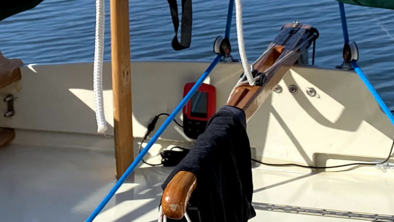

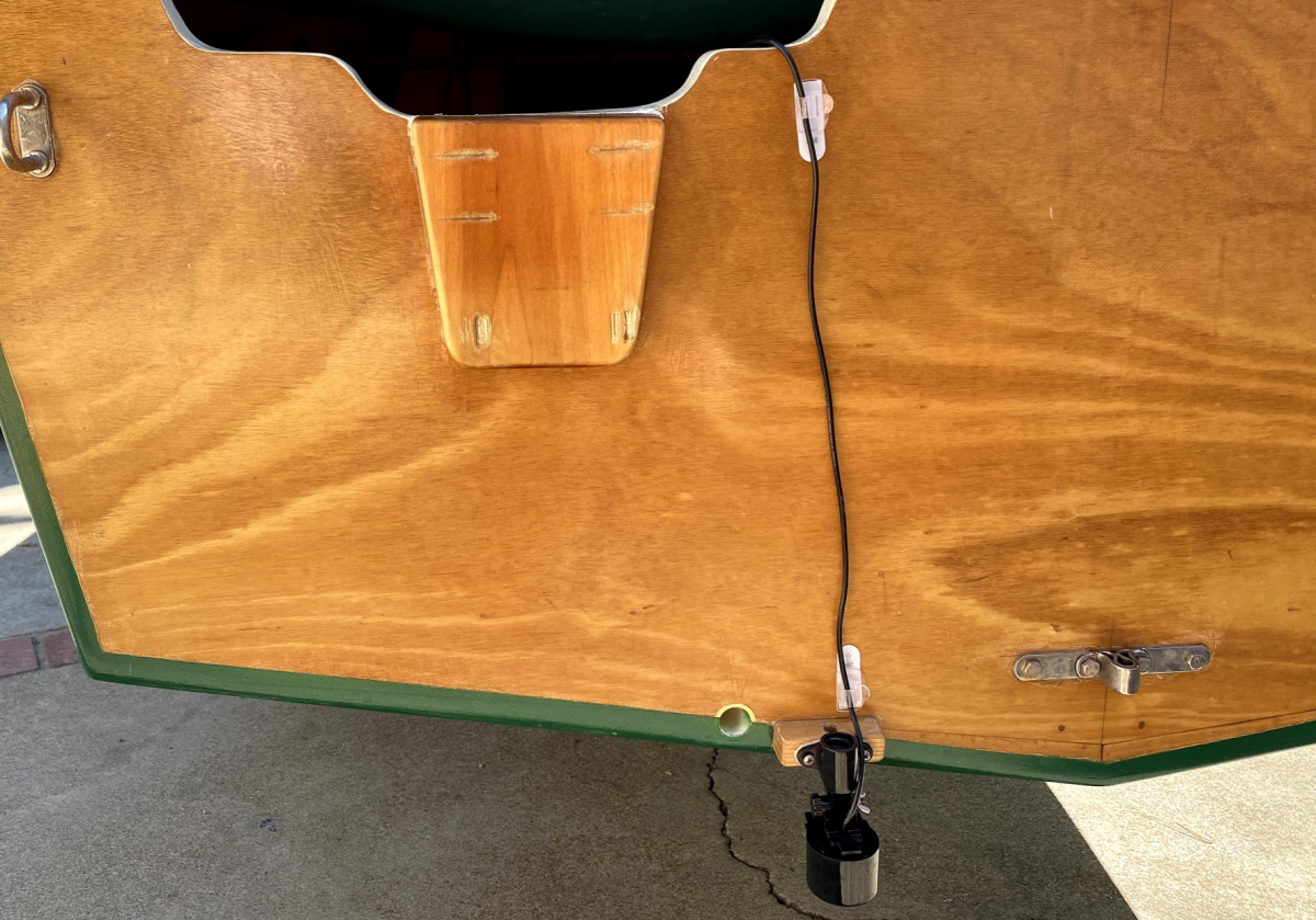

My current setup: the GPS is velcro'ed to the mast partner and the fish finder is velcro'ed to the transom with the transducer wires fastened using command outoor lighting clips (see photos below).

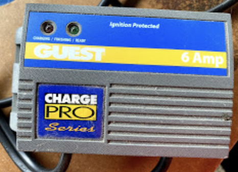

@Thrillsbe Thanks for the story about your LiPo batteries. I was leaning towards the LiPo for the weight savings and more charge cycles, but your story makes me doubt that I have the discipline to use it properly. Regarding motorcycle batteries, there are 30ah deep cycle batteries (like this one from amazon) which weigh a little more than 20 lbs. I would probably set it up with a guest charge pro 6 amp charger that I have from a previous boat (a bit overkill).
