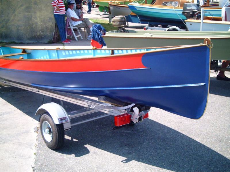

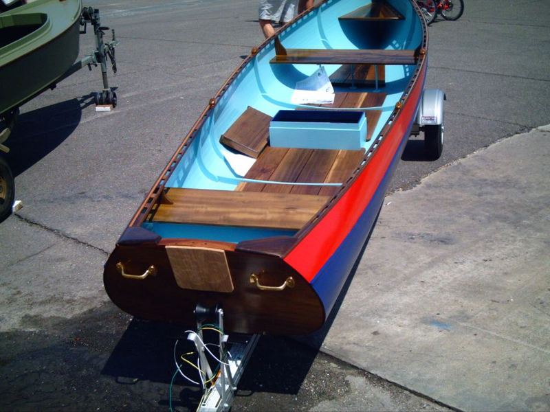

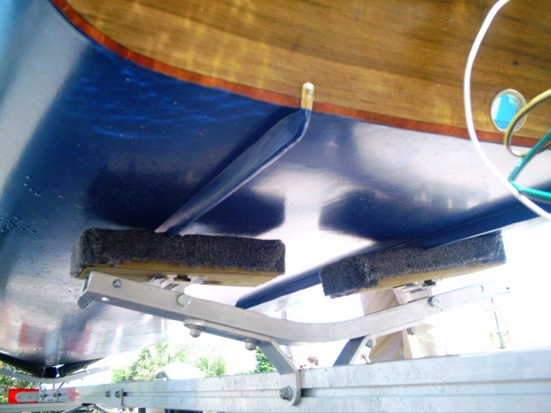

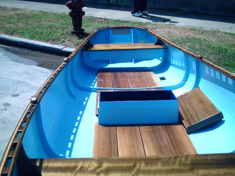

  2. Some more pics:

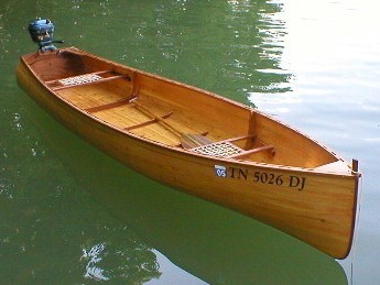

  3. Any thoughts on the stability of this design? I'm wondering if two people could stand up and fish comfortably without the boat sliding out from under them. http://www.robbwhite.com/sportboat.html
