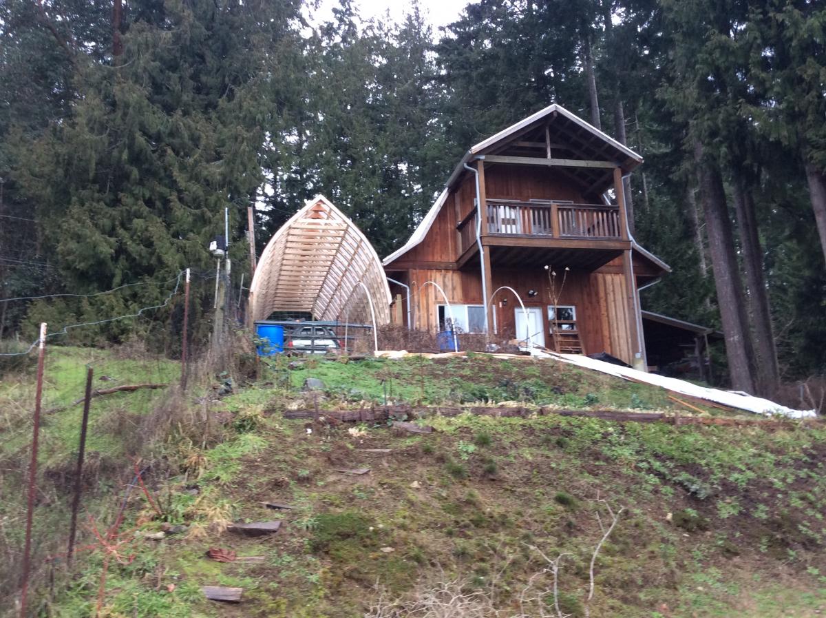

This covering is rated for 10 years. Stretched it out and hit it with a hammer and it didn't puncture. A sharp branch, who knows?

Don, I found this product online and it sounds good. I have lots of trees nearby so I will find out if it holds up. Seems pretty tough. http://www.agriculturesolutions.com/products/greenhouse-supplies/greenhouse-plastic/agtec-super-strength-clear-woven-greenhouse-film-12mil-per-sq-ft-detail Good luck. Cheers, Ken
Finished the planking on the OB26 last week. Been a busy few months! Ready for lots of fairing and sanding, fiberglassing, paint and then flip her over for pilothouse and interior construction. A "new home" for the boat in the form of a Bow Structure" was just finished and is ready for the boat after it is flipped over and the van is kicked out. Time for a break to find some sun and let my carpal tunnel heal! More pics of the building process if your interested. https://goo.gl/photos/42vU3BKQDsnMxbPp9

Carter, These projects bring out the madness and creativity in us:). I realized around the time I started the OB26 that the clearance height of my front doors might not work when I build the pilot house. Might have to take some trim off at best. One thing has led to another and this week a 36' long bow shed is going up. The boat will need a home when is done anyway. Got the planking almost complete and it looks surprisingly fair. I will post some more pics soon. Looking forward to seeing your project take shape in that inspiring space! Cheers, Ken
