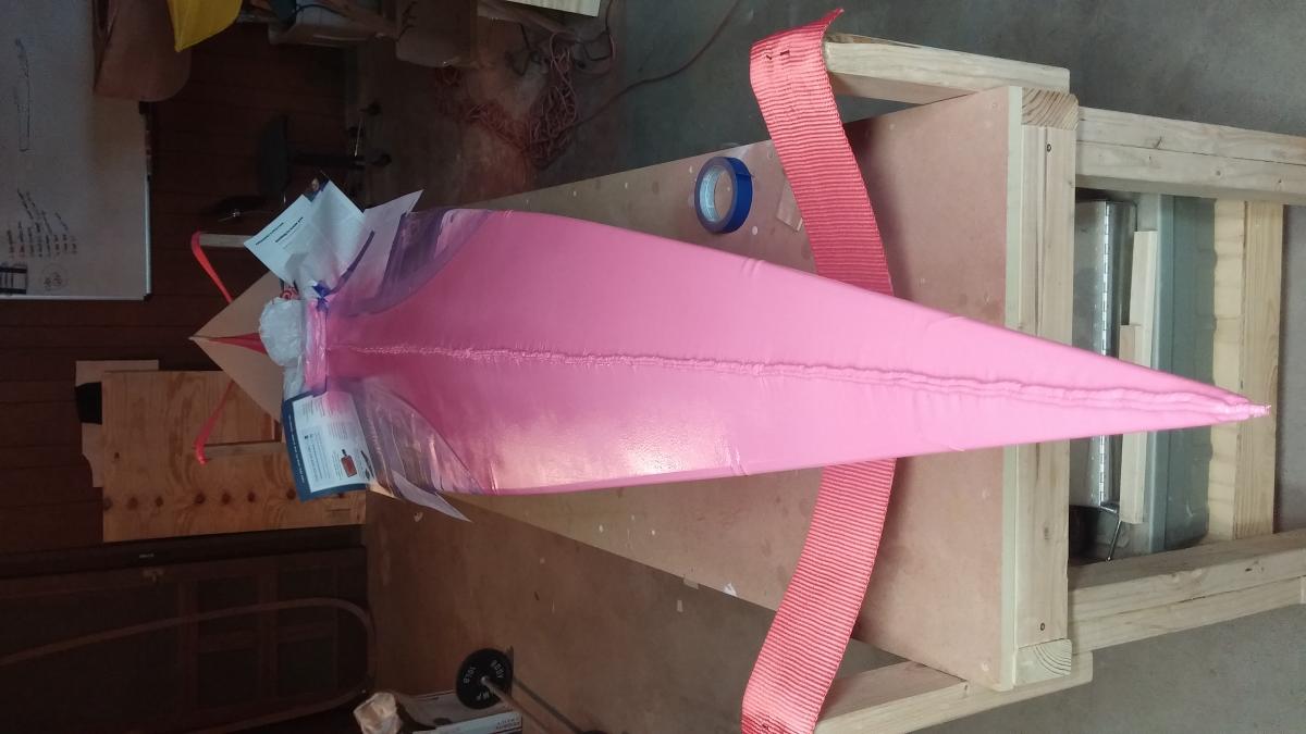

It's raining here all day, so I figured I might as well start with the graphics -Operation "Just a Tad' Pink" is underway! -

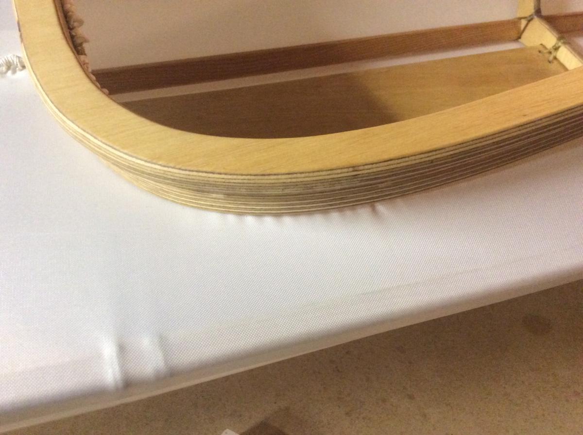

Ready for the base coat! I whip stitched the coaming after sewing on and that really helped snug things up around the compound curves this time, and it looks a little more sophisticated too I think. Worst wrinkles were at the rear coaming corners, and I think I'll just live with them vs. trying the heat gun. -

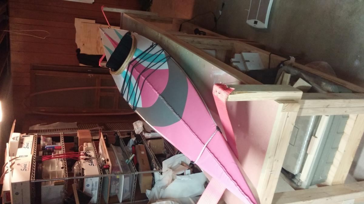

Obviously, I've already "launched", but tonight I get to call her "complete"!

Quickie shot of the graphics. Still need to do the aft deck rigging, and then I'll call her complete...but not yet finished.
