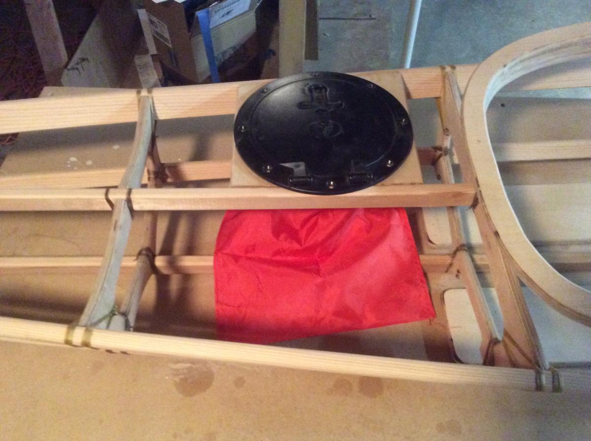

Cut the seat slats and got them routed, carved some spare stringer stock to fit and reinforce the chine stringers for the footrests, and made a mounting ring for the little 6" hatch. The hatch is a tight squeeze, but ought to serve its purpose nicely. I will need to stitch a curve in the seam to go around it though - the inner most mounting screw goes right smack in the middle of the aft deck stringer. Had to go with the premium 6oz, since the heavy stuff is OOS. I'm still concerned about the coaming area since the coaming ring is too stiff to flex and the fabric not shrinking, but I guess time will tell. -
Jeff, with the 6 oz. would you still recommend starting at the coaming and double stitching toward the bow & stern, or sewing the tips, stretching it on, and sewing tip to the middle?

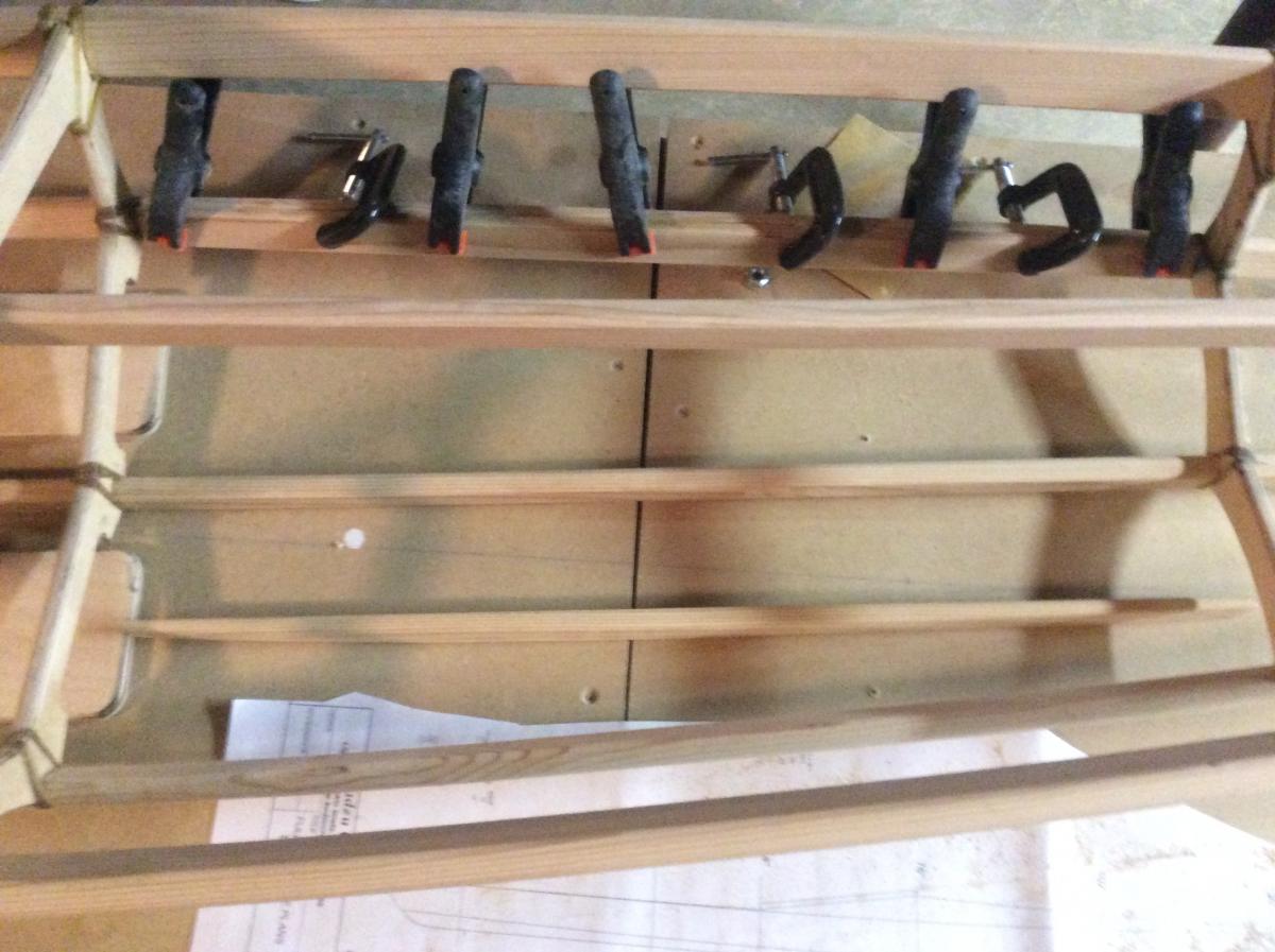

Got the brackets cut, leveled, and mounted on the work table(s), stringers and gunwales ripped, and started lashing a couple frames to the keel. Pretty sure I got lucky with the lumber and will get away without having to do any scarfs. We'll see how the week goes, but I might have a FROG by the weekend! -
