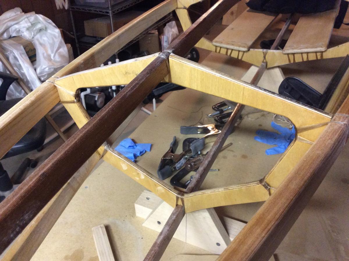

Ok, fabric starts in the morning! I contoured some spare stringer stock to reinforce things for the foot braces and glued it in place against the stringers. Seems stout enough. A couple shots of some mistakes, oops, and inconsistencies too. The bow didn't fit right with the deck and keel stringers and I made some shims to fill the gaps and lashed them in place. You can see the gaps on the mid frames from where I had to adjust the angle of the gunwales. And in an effort to recess the lashings, I file notches in the gunwales, but not for the stringers. The front frame also got a little thin at the top after I sanded it down after adjusting the gunwales. It's all character, right? Coaming still has a ways to go, but it might get wrapped up tomorrow since I have all morning to myself. Coleman seat looks like it will work wonderfully. Going to try the double corded stitch, we'll see how things go...

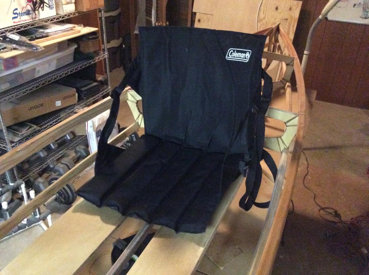

The Attwoods have three mounting lugs, so I think I'll use all 3 of them with a shim in the middle so it doesn't flatten out the natural bow on the stringer. Coleman seat showed up today and it looks like it will work wonderfully. Foot braces arrive Wed. The girls are doing a great job of applying the Formby's tung oil / wiping varnish / whatever it is every night while I work on the coaming form. Hope to get that finished tomorrow evening and see it my first attempt will take the curve. At this rate, I should be sewing by the weekend!

Got the seat slats lashed in today and cut some foot brace mounts from leftover stringer stock. Picked up some tung oil and Rustoleum at Lowes today and started baptizing the wood with the tung. I ordered some 15" Attwood footrests like the CLC kayak came with. Not particularly fancy, but definitely cheap enough and I won't be adjusting them very often, so the Sea-Lects at almost twice the price seemed like overkill. This brings me to several questions: The space for your feet is somewhat limited, so has anyone attempted to mount the foot brace attach wood on the outside of the frames like a stringer, but just recessed inside where the covering will sit? That would save a lot of interior room, but would require cutting notches on an already assembled frame. Pretty sure I can drill the notch corners and make some clean cuts with the Japanese saws, but it's still a little stressful just thinking about it. Second, I bought Jeff's cheap 6 oz poly. Do I just running / whip stitch it, or try the double corded stitch? I also opted to try a Coleman stadium seat for this boat - anyone have a report pro or con on this idea? At $13, it seemed like a very cost effective alternate to a $28 backrest + ? for a "kayak" seat. http://www.amazon.com/gp/product/B003399114 Lastly, on the double corded stitch, how does one anchor the cords when starting the stitch? Thanks!

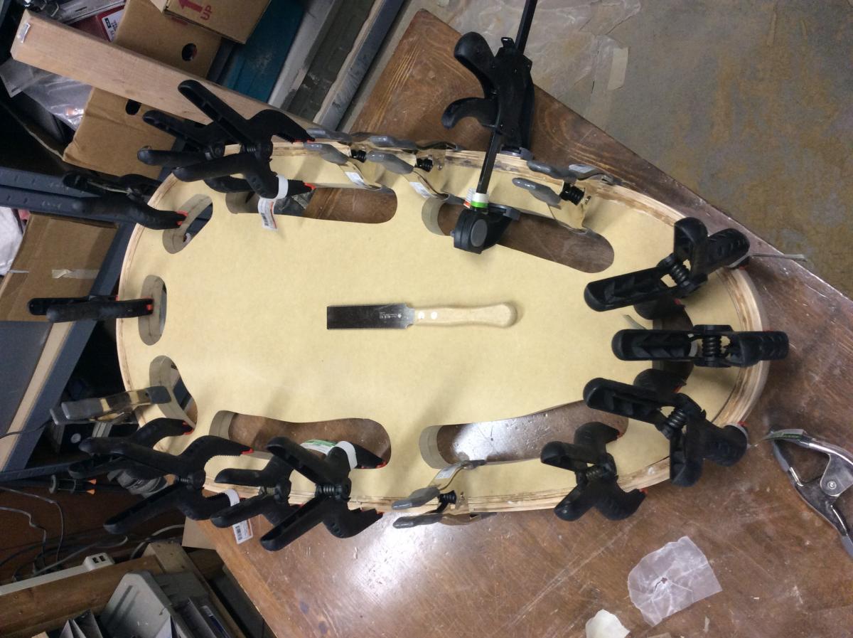

Finally picked up my 4'x8' special order from Menards yesterday. Also got a sweet piece of cedar for the tadpole! Got the bow and stern cut last night and the frames cut today. Wasted a bit of time trying to entertain the boy without getting either one of us in too much trouble. I don't think he was to terribly entertained, but we both still have ten fingers and ten toes. Borrowed a basic router to help clean things up a little. Still some sanding yet to do, but many back and knees have had enough for today. Obligatory progress pic:
