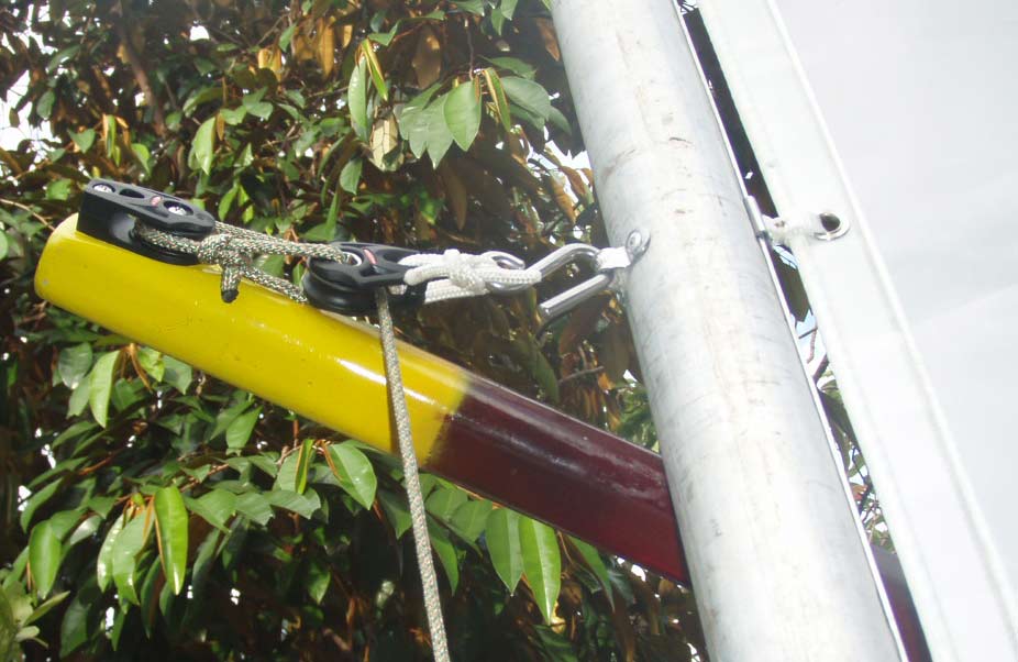

on the CS17 rigging plan, it doesn't really show how the mizzen snotter is rigged. does it cleat on to the sprit as shown on the diagram for the main snotter? or is does it simply cleat on to the mast? or am I missing something? I can't find it on the pictures on the CD either. i've never rigged a snotter before... how have you guys done it? also attached is a pic of the main snotter, not sure if the block attached to the mast is the right one, but this is what Carla sent. The main snotter leads to a block on the deck then to a bullseye which leads to a cleat on the side deck. that bit I got.. I've only gotten as far as rigging up the main, there's a tree in the way of the mizzen mast, so I have to wait until the trailer is done so I can wheel the boat out from under the tree.
