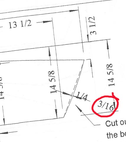

  2. Attached is a picture of a part of the sheet #1 for an 11' nesting spindrift, can anyone tell me what the 3/16 is a measurement of? [/img]
