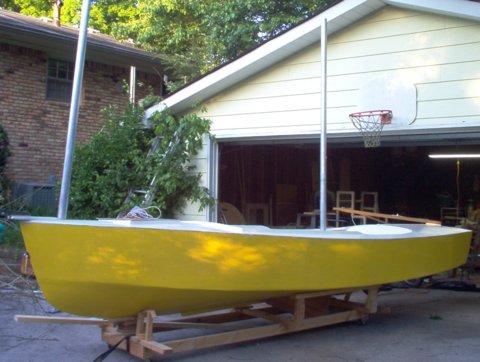

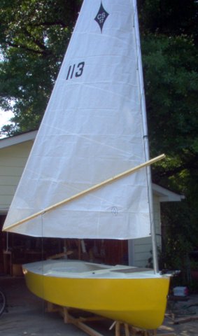

  16. A little more progress today. She gets to wear her Main for the first time!!

  18. However much money I have, it always seems I spend it all on my boat and realize I still need something else. When you get close time moves real slow don't it.
  19. Very nice boat!! I am within 2 weeks of launching #113. Let's get 'em all in the water!
