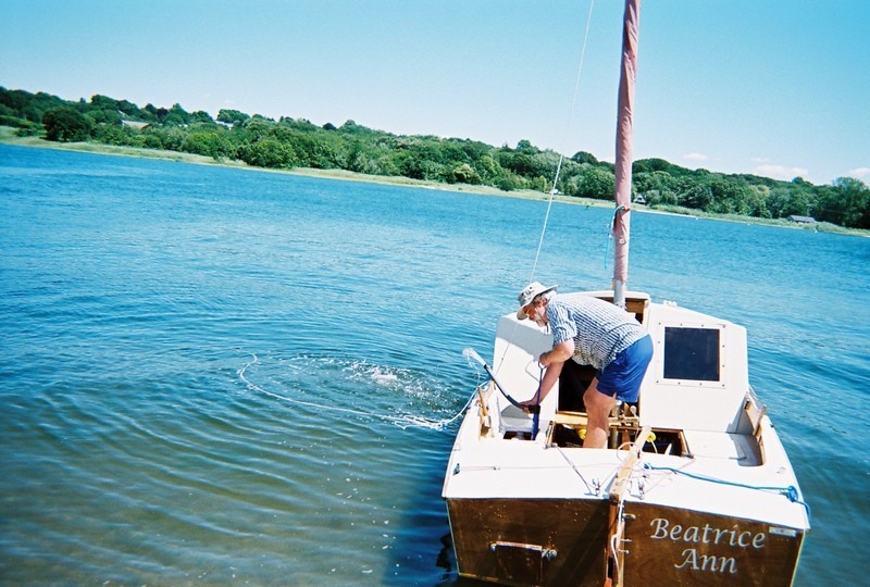

  18. Graham suggests wetting out the wood, then letting it set (so you know the wood is done absorbing it) before gluing with thickened. That way you also don't get a problem with the prior unthickened epoxy mixing with and thinning the thickened stuff.
  19. Paul, if I had it to do over again, I'd lead lines from both mastheads. The mizzen is much nearer the center of resistance, but with bow and stern both restrained reducing the load on the mizzen would be a good idea. I had expected the boat to go over about as easily as when I tested it 4 years ago. (Mizzen appears to be okay.) Absent flooding of cabin, I don't think the boat would turtle. A good breeze against the bottom in a port capsize could make a difference, though, so I will run a fat float to the masthead in risky conditions. As far as realistic testing goes, I didn't want to endanger my stuff, and I didn't want the predictable tumble of loose gear. I was relieved to see the batteries stay high and dry--didn't want them to short in saltwater! I will be adding turnbuttons to my seats to hold the raised bunkflats in place. When I first capsize tested, I had the boat empty but fully rigged. I decided that the sails confused the issue a bit: slowing the turtling and also slowing the righting. I was also reminded that the mainsheet must be released before righting--boat tried to sail onto rocks with me clinging to transom! I will be interested to see how your test goes; I'm guessing your narrower cabin won't hit the water until much further over, but you have much less opening to worry about.

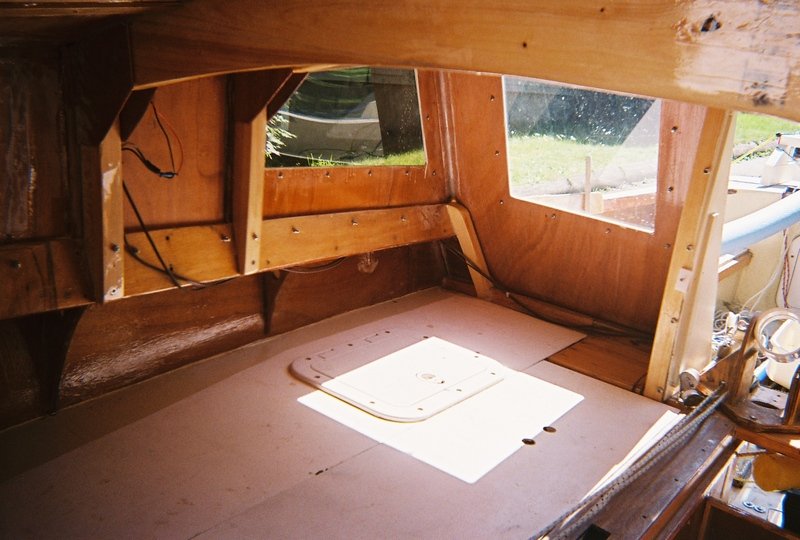

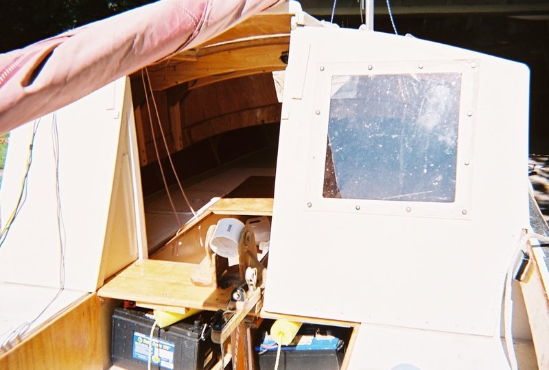

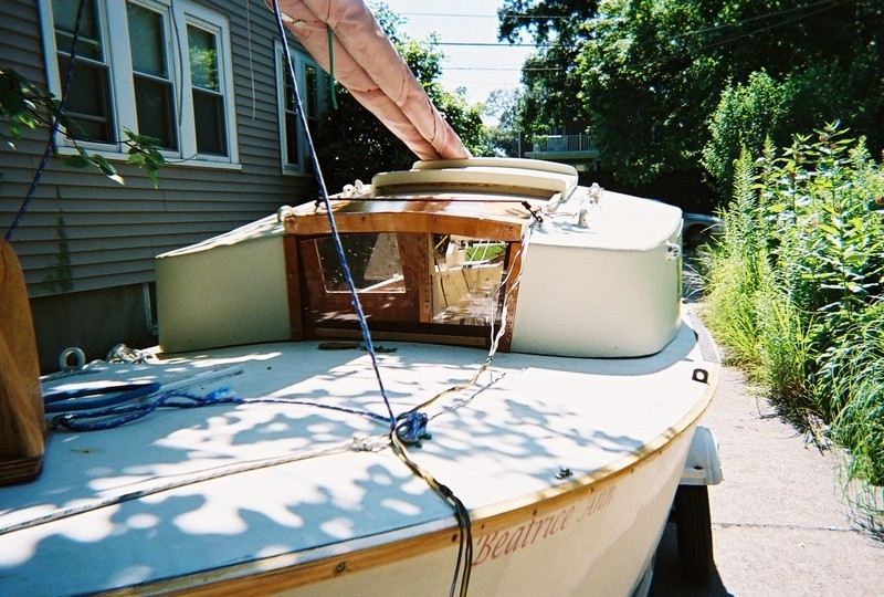

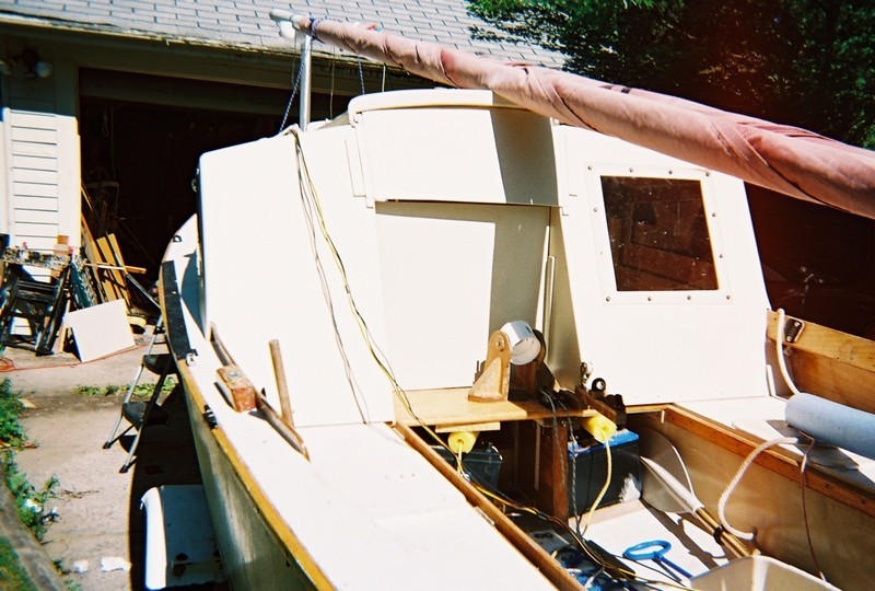

  20. The cabin in detail. 1. looking in from the cockpit. The aft bulkheads are anchored with screws to cleats glued to seats and thwart, and also to small under-the sidedeck bulkheads permanently installed. The big plexi window allows me to keep an eye on kids when they're in the cabin, and lets me look up at the stars at night. 2. The skipper's berth flat, looking aft. I leave this starboard floorboard in the raised position, giving me room for the inflatable kayak, its pump, & fenders. The two roof beams (made from 2X4s) are also visible. 3. the forward companion is closed by a tinted Lexan drop board that makes a very respectable front window. (Side windows are the same stuff.) The fore hatch cover simply lifts off. These are usually closed against spray. 4. The low bulkhead under the thwart should allow us some sleep during as much as an inch of rain without flooding the cabin. Another bulkhead is out of sight on the other side of the cb trunk. (When I have both boys out in bad weather, the youngest must sleep on the floor. In good weather, the skipper sleeps in the cockpit, leaving the regular berths to boys.) 5. Buttoned-up tight. A little rain drips in off the thwart; I haven't decided what, if anything, to do about it. Bug screens can close off the space you see between the upper and lower companion covers, the spaces under the thwart, and can also replace the fore (Lexan) drop board for more ventilation. Most of the time, the main companion covers live under the mattress on my berth. The sliding main hatch overlaps the fore hatch without touching. For more ventilation, the fore hatch cover bungees on top of the main hatch cover.

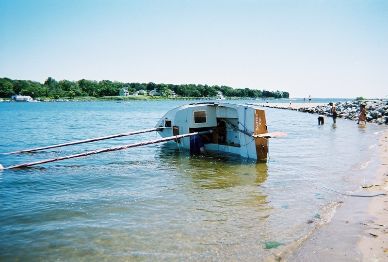

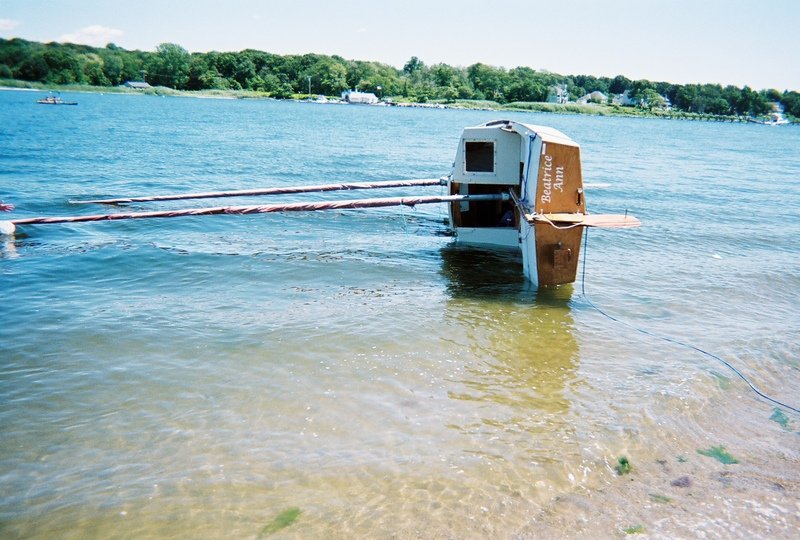

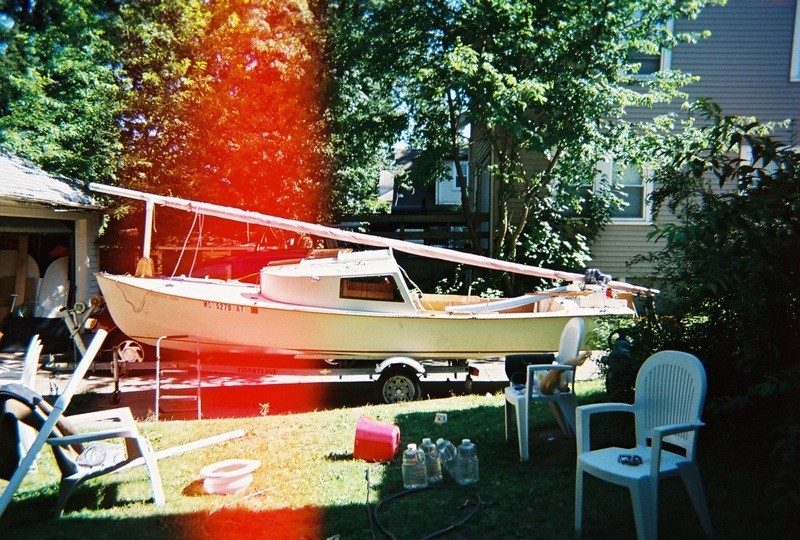

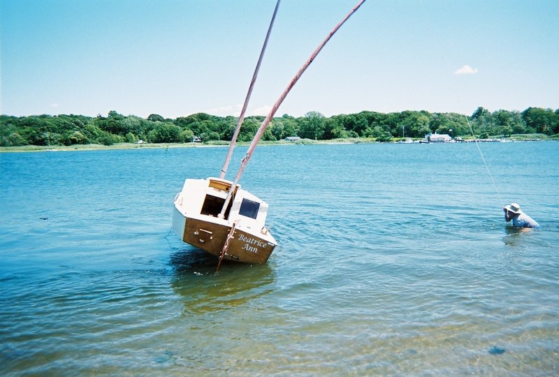

  21. The test itself. I'd originally planned several subtests: starboard capsize with locker hatches taped, then st with hatches allowed to flood, then port, etc. But difficulty of getting the boat over led me to go on to port capsize. (Since my dad was busy holding stern, he got no pictures of the that process.) Photos: 1. before. 2. this would have scared me, had I had this view. 3. masthead touching water, hatch edge still well clear. (Bottom drops off fast; at no time while capsized did any part of the boat touch.) 4. I'm trying to find the source of a leak into the cabin. (It was coming in between coaming and cabin edge. Garden hose has since shown me I have more cauking to do.) 5. Pumping out the seat locker. Unfortunately I got no photo with the seat locker flooding, but I was impressed that the hatch didn't get much closer to the water. I may add flotation anchored against the hull side in this locker so that it cannot take in so much water. 6. back in the driveway after the test.
  22. My cabin finally done, it was time to see how it would handle a capsize. I built a cabin because I wanted: (1) privacy, (2) a dry place to sleep, (3) a refuge from wet weather, (4) something to stop the spray, and (5) a place for kids. I also had an idea that a cabin would maybe reduce the amount of water that came aboard in a capsize and help prevent turtling by providing buoyancy high up. These last were very iffy: my two large hatches are offset to port, placing them directly above the sole on the port side of the cb trunk, and I feared the hatch edge would be at or below the water in a port side capsize. The boat was unloaded, the usual gear weight replaced with 13 gallon bottles of fresh water, about equally distributed between the space beneath the forward seat and the lazarette. Only the anchors in the forepeak and the two deep cycle batteries beneath the thwart (important as ballast) were left aboard. The boat was anchored, cb down, sails furled, and my father held a stern line when the boat refused to stay put when I pulled on the mizzen stays
