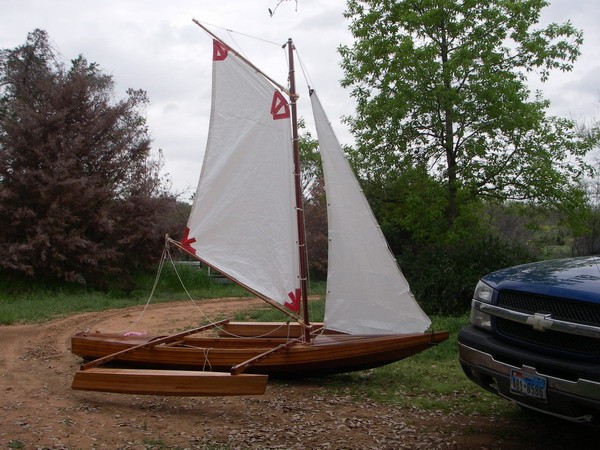

Getting to the stage I needed to decide on sail type, as most of the time I'll be single handed, talked to Graham and pretty much decided on sail track for ease/safty of reducing sail. I have a hobie with sleeve luff and like the round the mast furling but can't see myself going fwd in the CS 17 to roll/furl the main in mounting winds. Travis enjoyed checking out Pilgrim at sail OK last Oct, didn't notice the SS bands so obviously quite unobtrusive. PAR I have a few kayaks where Iv'e mounted pad eye's ect and used silicon sealer, think I'll go back and redo those with epoxy now. hokyhydro used lashing for the main , peak and jib halyards on my small tri, so far working great,just wanted to get opinions from folks with more knowledge/experience with rigs more substancial than my small kayaks/canoes. MM

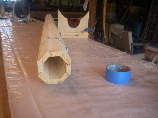

Folks I'm just about to start the birdsmouth masts for my Core Sound 17 # 342. have to get masts done to be able to size the mast bearing then progress the decks ect. My question is, other than screws what are the bet ways to mount hardware ? I will be blocking in area's where needed. I may go to aluminum one day but I like the old traditional style and I'm not a racer. Thanks in antisipation. MM

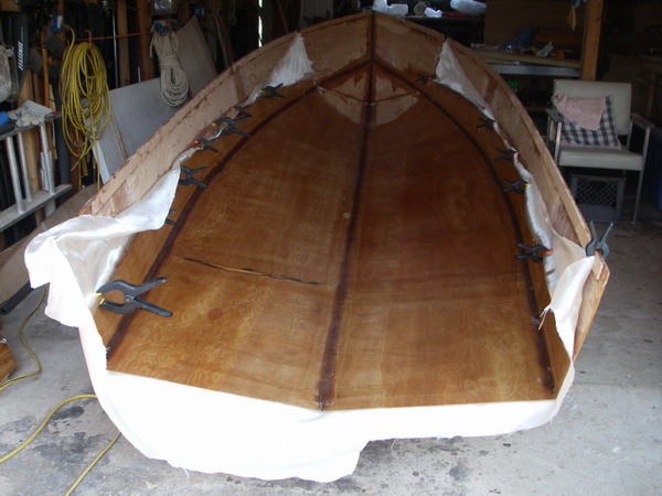

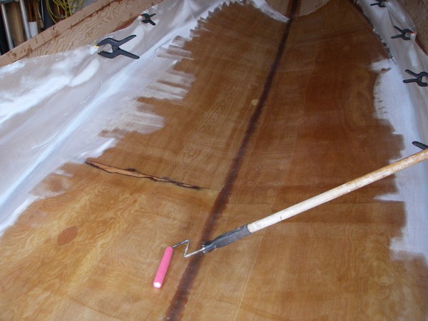

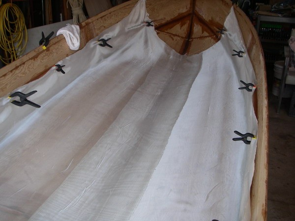

So onto the glassing,allowed 12'' overlap at keel giving me 2' total doubling in the working area. After fill coats on to fitting outer keel, inner keel batten and beefed up Transom. Going to have to make desition on mast soon, Spruse hard to come by to do birdseye mast(my preferance)Have a carbon mast on my Hobie but not sure on mast thickness for the CS, The internet will get a workout tommorow. MM

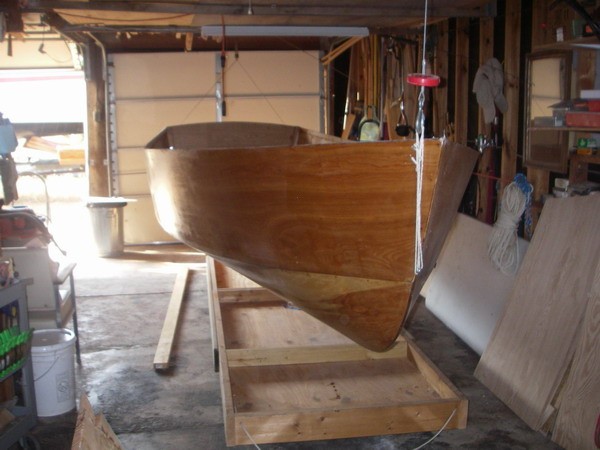

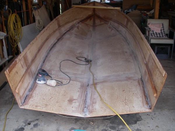

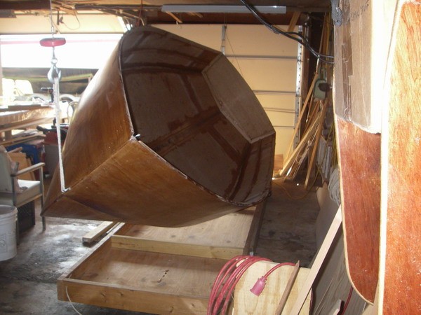

Next as I'm in the boonies I had to devize a rig to turn hull on ownsome, worked fine allowing me to suspend hull and rerig my work table. Then more of the fun stuff sanding/feathering taped seam, ready to glass inside hull.

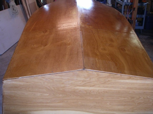

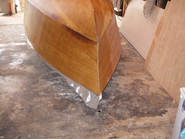

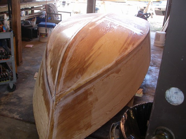

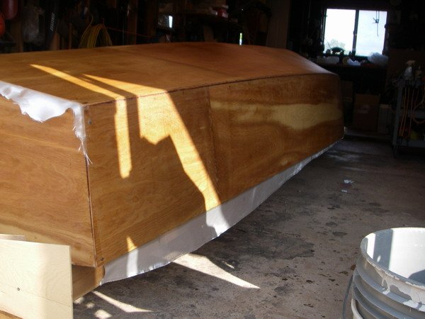

slow but sure progress ( Busy time of year with shows/messabouts and river trips ). Had a visiting friend help to turn hull so I could radius/fill and tape outer seams. Also glassed entire outer hull, no water getting into this wood !

Thanks folks, I had already doubled up on the transom, is now 1/2''and will add the recomended cross member at mid hight and top. I have an external motor mount which I may use, will see as to what rigging is best but I'm a good ways from that stage, did glass the hull today though. MM
What would be a good schedule for reinforcing the transom to accept a 5/6 hp??. I have the hull upside down ready to glass entire hull (seams/keel are taped). MM

http://www.duckworksmagazine.com/04/s/articles/birdsmouth/index.cfm#online-calc Her is the Duckworks link. Made several paddle shafts and masts for my small trimaran from inexpensive pine and western red cedar, so far without failure, even in good (20+) winds,actually pretty fun when you get into it. MM
Also made my small trimaran mast using the birdsmouth method. No spruce to be found so I used western red cedar and redwood, came out nice and light, and has withstood 20 mph + gusts with no hint of trouble
