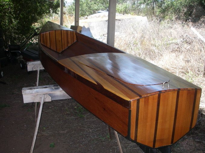

  1. I pondered this, I wanted access to all areas for airing out while not in use. So 8'' deck plates are installed,as further insurance I have enough 5 ltr wine bladders that can be inserted then inflated. havn't done the acid test yet (capsize)but have same set up in my decked kayaks and trimaran and it definitly works. MM

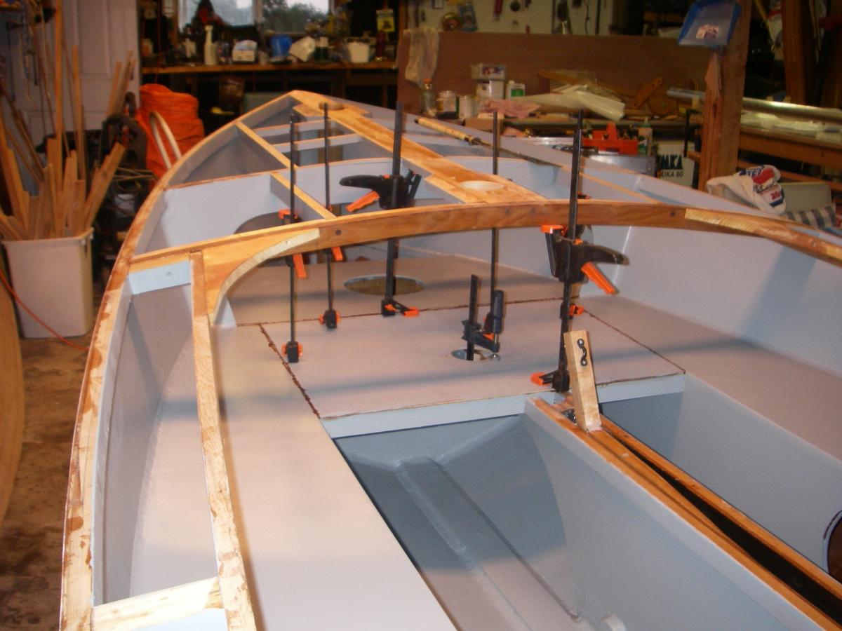

  11. I made this set up for my 17' Core sound build. very worthwhile to be able to move boat around during the build proccess dificult to see the wheels, steerable one end only,4'' dia from Harbout freight,platform is 1/2" ply and 2x6 pretty much able to reach most area's inside the boat exept the bow which with some trepidation I got inside to work on with no problems. MM
  12. I'm using 1/8" X 7/32" rubber weather seal purchased at Lowes,worked out good for my flush fit kayak hatches. Just put on my Core sound seat hatches (built per plan)but until I do capsize tests not sure how well they'll seal. ]

  14. I opened the fwd bulkhead so I have access all the way to the main mast step.This allows me almost 8' and I'm only 5'7'' Not sure yet if that will means that the incline afloat will have my head lower than my feet,i.e not comfortable !!

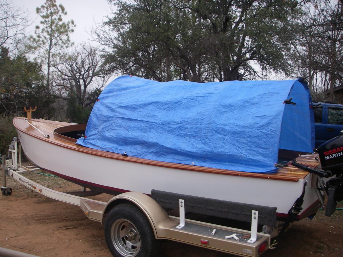

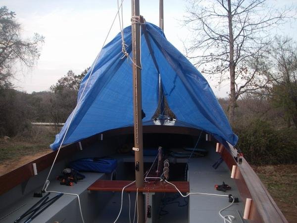

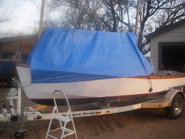

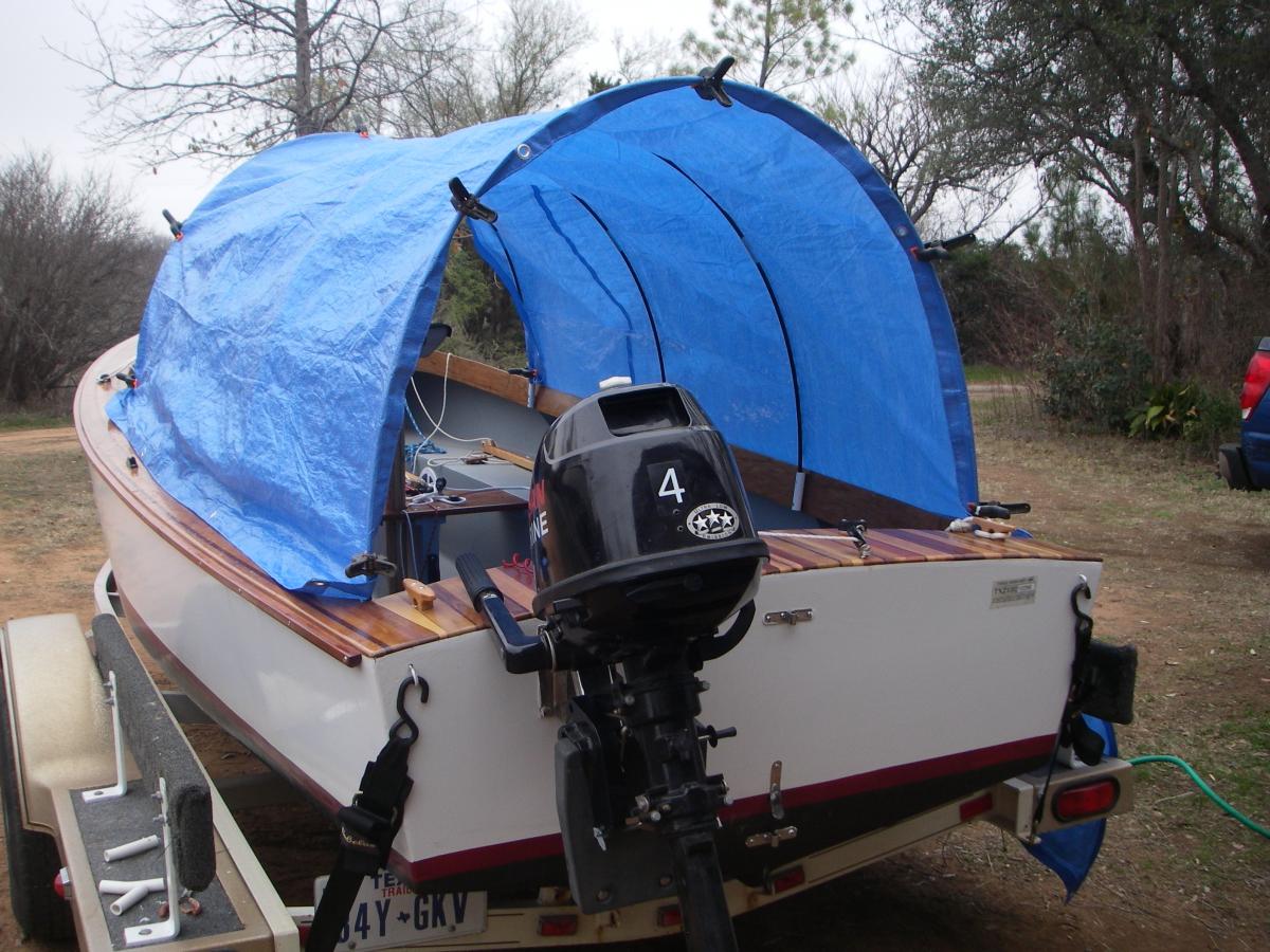

  15. On the KISS principle, using what is already in the boat (exept tarp).lashing the main spirit to the masts at head height with run off angled to the bow, then secure front through bow eye and the sides bungied or lashed to suction cups attached to hull. Both ends can close,as required, Now this won't keep bugs out, but with the hose pipe test it worked. MM

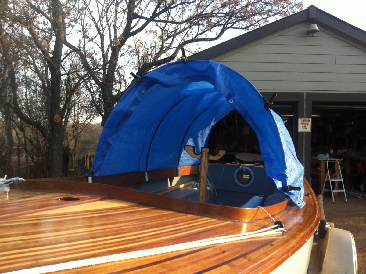

  18. quote '' One big problem with having a boom tent over the front cockpit is that it makes the boat sail around wildly at anchor owing to the excess windage up front. I nearly got whiplash during a thunderstorm last year!'' these are reasons for my inquirey, hadn't considered this aspect good to know!! I will be carrying regular camping gear but for those occasions when it;s not convienient to camp onshore, I want something I can set up from inside the boat. still playing with ideas' now have a couple more I can try, thanks. I wasn't able to delete my double post in the edit mode sorry. MM
  19. anyone care to share their onboard camping setup, ( canvas/tarp ) with masts stepped or not, playing with idea's now. Before I waste time and materials ,I feel sure others have tried this before, and all or any thoughts would be welcome. MM
  20. Anyone care to share their ideas for onboard camping setup (primarily canvas/tarp setup) for CS 17, with masts stepped or not. Playing with idea's now, but I'm surely not the only person to consider this. MM
