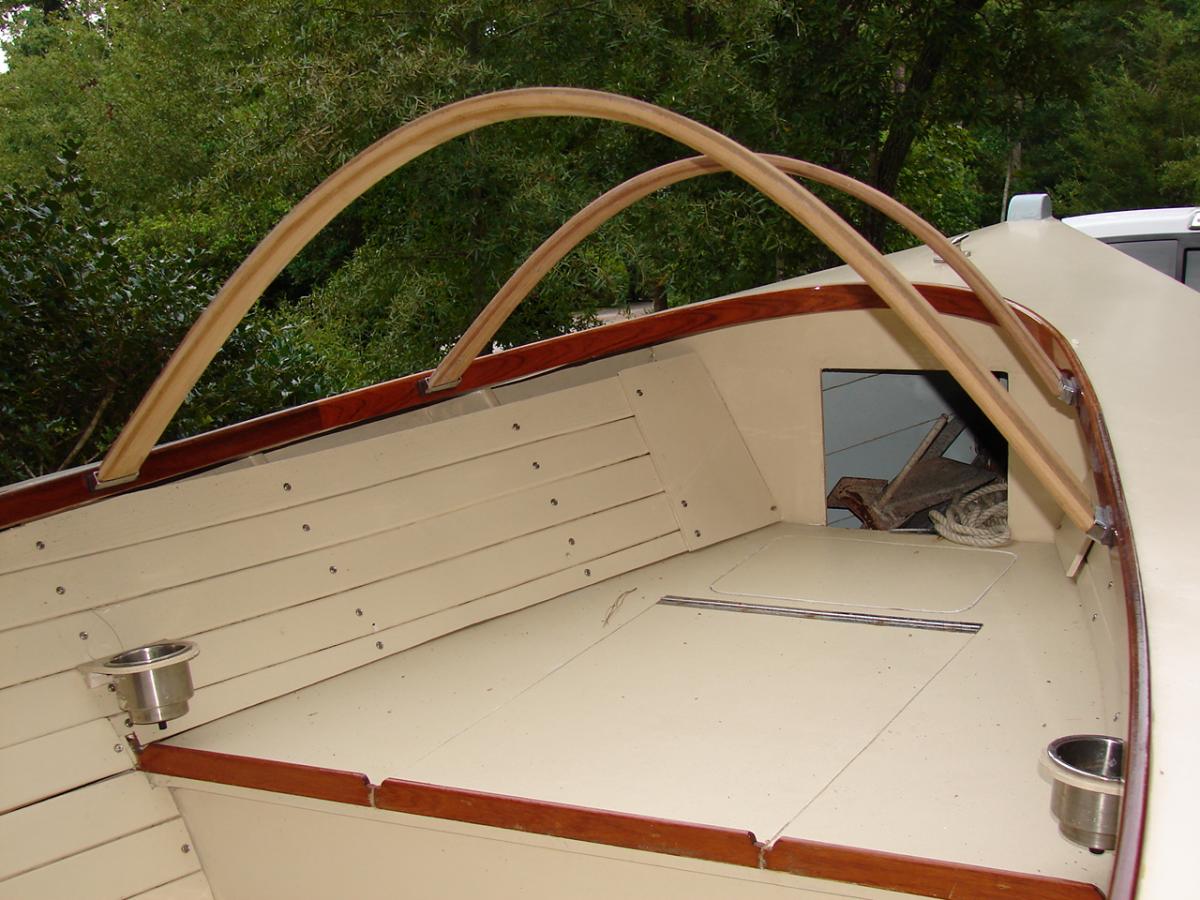

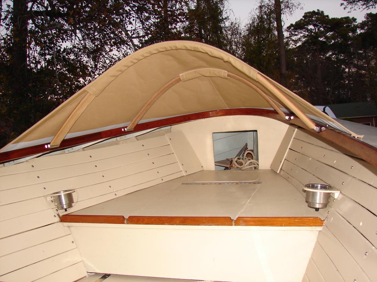

Oyster Posted January 27, 2016 Posted January 27, 2016 I just used bow brackets angling them up a bit and used snaps on the covering board. I laminated teak strips together for the wood. Quote
Jim Stumpf Posted January 27, 2016 Author Posted January 27, 2016 Thanks Oyster, Looks great, I like the setup. I thought about a very similar setup but was trying to avoid any hardware on the cockpit interior. Very clean and simple, just the way it should be on a small boat. Thanks for your comments also PAR, I am a fresh water sailor, greatlakes, so hardware failure is not a big issue here. I like the idea of the hammock clip and am toying with the idea for a cockpit cover on my canvas canoe, where the hook is up under the gunwale. Quote

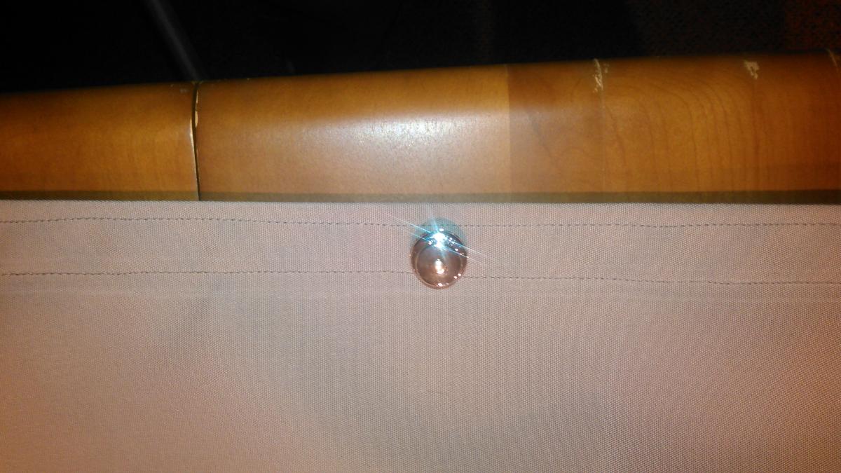

Hirilonde Posted January 29, 2016 Posted January 29, 2016 If people do go with snaps keep in mind they need maintenance. A touch of white grease, or petroleum jelly each season goes a long way. Epoxy syringes work great for this, along with a Q-tip. Quote

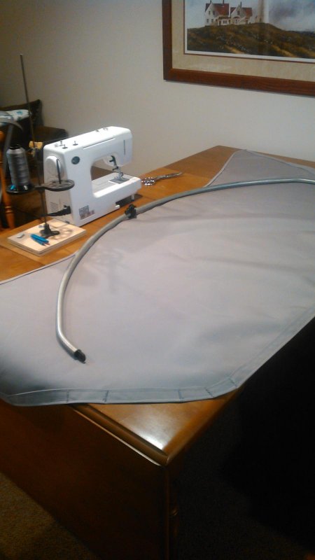

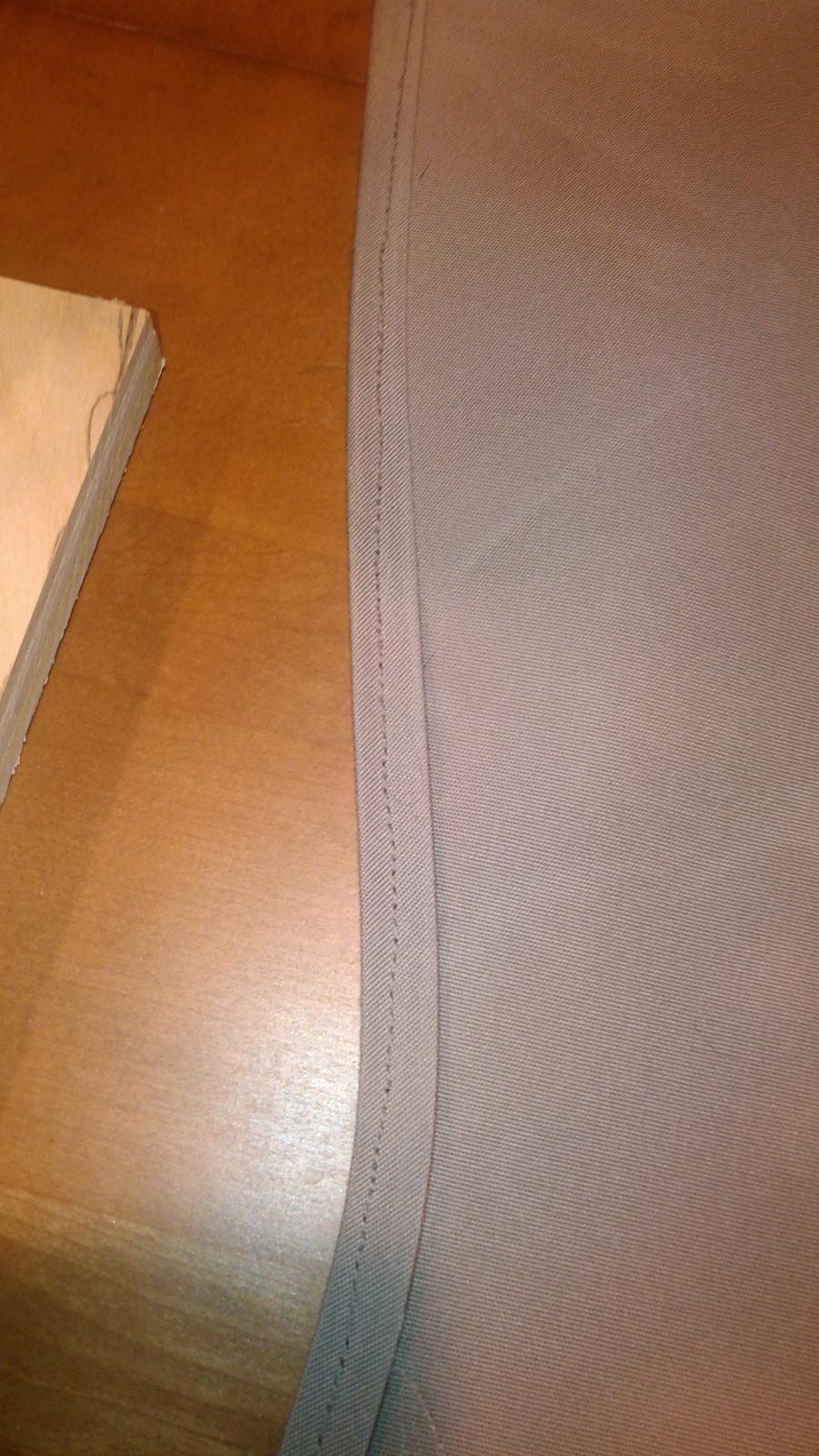

Jim Stumpf Posted January 31, 2016 Author Posted January 31, 2016 Mini update, Here is where I am this morning,. Fabric cut edge banding on the free edges and hardware hem in place at the coaming. This morning I hope to get the fabric tubes in place that will house the pipe hoop and then mount the whole thing on the boat. If it fits I will layout snaps if it doesn't I will take a nap and start again next weekend. My sewing machine is struggling and my stitch work is not my finest but I think she will be fine. Quote
