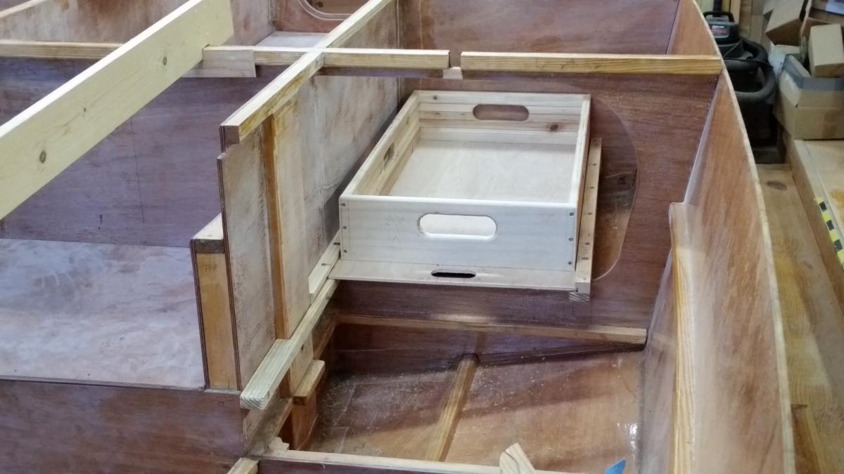

Pete McCrary Posted October 1, 2015 Author Posted October 1, 2015 Here's an update on the "pull-out" galley (or whatever) . . Here is the port-side drawer in stowed position. The sides are made of "door jam" stock which I found at Home Depot. It's labeled as pine, but it's more like cedar and very light. Each drawer weighs < 5 lbs. The drawer is pulled part way out. It can be easily placed on a bunk cushion (which will be ordered at 3"). Or even carried on deck. Or loaded in your shore-side kitchen and carried to your trailered boat. Each rail is made of a base to which is attached another rail with a 5/16" x 3/16" rabbit cut. This (rabbit) captures the 1/4" bottom of the drawer which extends 1/4" beyond the drawer sides. These rails are removable. They are screwed to cleats which are permanently glued to the bulkheads. On Blk#4 there will be a "dog" ?? which can be rotated to capture or release the drawer from forward movement. The starboard-side drawer in stowed position with camp stove and other stuff. I had guessed that the drawers were big enough -- but I wanted proof before embarrassing myself. Lastly, the galley drawer is pulled all the way out and placed as if it were on a bunk. More likely, I'd carry it to the cockpit for actual cooking. The drawers and rails will now be removed until the boat is ready for fitting out. Quote

Chick Ludwig Posted October 2, 2015 Posted October 2, 2015 Good plan and great execution. A portable galley unit is always a good addition. Will your dish pans, pan/pot, plates, etc. be in your port side drawer? I have the same stove as you. I like it. It would be helped with "rails" to hold a pot in place. Quote

Pete McCrary Posted October 3, 2015 Author Posted October 3, 2015 Good plan and great execution. A portable galley unit is always a good addition. Will your dish pans, pan/pot, plates, etc. be in your port side drawer? I have the same stove as you. I like it. It would be helped with "rails" to hold a pot in place. The port-side drawer is slightly smaller. I'll sort out placement of equipment after several overnights. After assembly and installation I realized that the bottom extension serves no purpose. It'll be cut off. Quote

Pete McCrary Posted December 19, 2015 Author Posted December 19, 2015 Hi Chick,.. The proof-of-concept was just dry fitted together. At this point I have now screwed and glued the drawers and rounded over all the edges. Next will be neat epoxy and maybe (later) paint. Of course, I haven't actually used them yet -- but I'm sure they'll serve me well. I've trimmed (off) the bottom extension that I thought would be useful to pull the drawer out -- but it actually just got in the way. I used cheap plywood (3/16") for the bottom. Makes it much lighter, and will probably be ok. But if I were to do it over, I'd probably find some real 1/4" for the bottom. After I'm on the water and put them to use, I'll post a review on performance and whether the skimpy bottoms were sufficient. The plywood bottom extends slightly and slides on rails. I added a cleat above the rails to keep the drawer from bouncing or falling out in a knockdown or bumps on the highway. Quote
