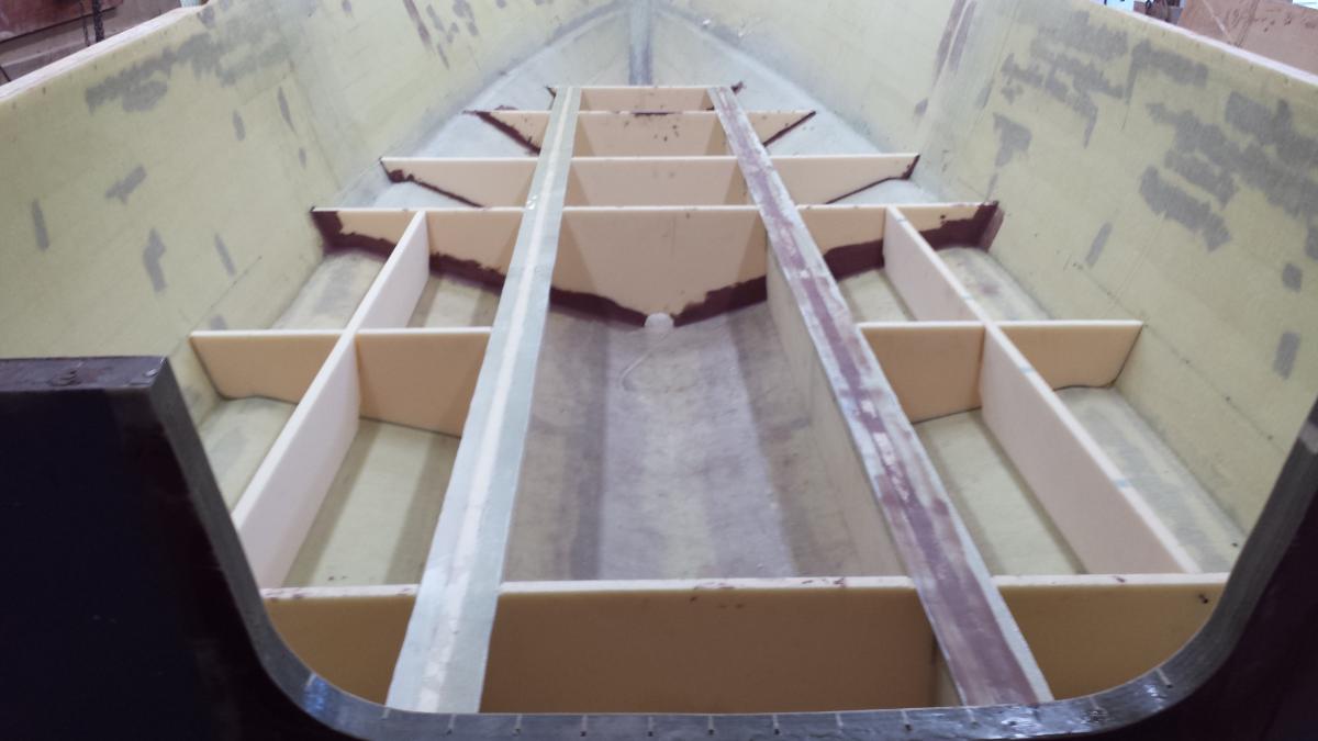

hightechmarine Posted July 30, 2014 Posted July 30, 2014 Finally a little more progress. The floor grid is in. Little backwards from the wooden boats. Tab everything in tomorrow paint and then some fun things like plumbing and wiring. Miyot you have been very quiet you must have caught a million fish by now. PG Quote
Miyot Posted July 31, 2014 Author Posted July 31, 2014 Hey Hightech.. Looks real clean. Are your stringers wood or are they foam? I've been pretty busy. Our vacation pretty much got blew out. We came home early from the beach. We have run the boat some but the weather has been weird here and when we can go the kids have something else going. Fishing hasn't been good here, it is an odd summer and unsettled. So while i'm waiting for fishing to pick up I started another boat build. I had one full sheet of ply left over and a pile of scraps as well as some Doug Fir and some nice oak and Mahogany. Just enough I think to build a little 12 foot runabout. Ordered the motor yesterday. A 25 HP Merc. I will complete the frames tomorrow and have the stringers, chine and sheer clamps, etc. cut out. I should have set up about complete this weekend. I'm making no effort to make a beauty, but I am being accurate. I need a boat to bang around and run up on the sand and gravel bars so thats what I'm doing. Keep the pics coming. Dave Quote
hightechmarine Posted July 31, 2014 Posted July 31, 2014 All foam just say no to plywood. Too bad about your vacation. Weather has been crazy here to. A tornado touched down two communities over. We were enjoying sunny and calm at the same time. It was nothing like the poor souls in the mid-west but scary enough. The runabout will be a fun and practical tool. There is nothing in the world like building a boat. I'll send more pics as I progress. PG Quote
