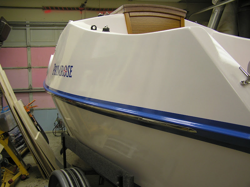

I used ss rails on top of the wood rub rail on Primrose
