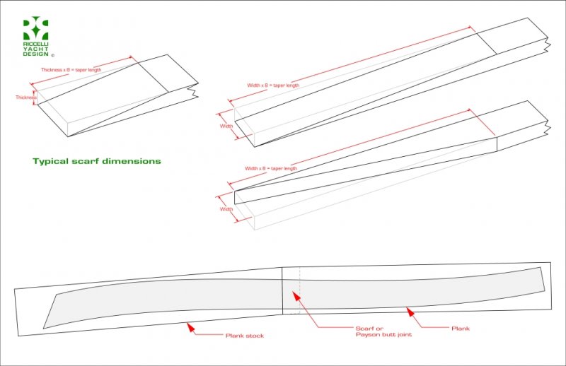

P Doug (WA) Posted November 3, 2011 Posted November 3, 2011 Planning ahead, how may feet of polyester covering do I need for a Curlew? And another: When cutting a scarf joint for a stringer or the gunwale, which is the best way to cut, A or B?? Quote
Kudzu Posted November 3, 2011 Posted November 3, 2011 I hear arguments for both and I don't know that it matters? I do my 'B' style because it is a little easier to clamp together. Your drawing is not to scale I assume but just in case, the B angle looks to shallow. It should be longer than A. Angle doesn't change with width. Quote

jerryg Posted November 11, 2011 Posted November 11, 2011 Anyone have a rule of thumb for the angle to use when cutting a scarf joint? I'm figuring somewhere between 10-20 degrees? Quote
Norman Colter Posted November 11, 2011 Posted November 11, 2011 If you search the forums you will find 8 to 1 ratio listed. One inch stock, eight inch scarf. Hope that helps. Have fun. Quote
Kudzu Posted November 12, 2011 Posted November 12, 2011 I agree with one minor caveat, at least 8:1 not less. Quote
jerryg Posted November 12, 2011 Posted November 12, 2011 I fed the ratio into my calculator and came out with around 7.9 degrees. So I guess anything between 5-8 would work. Thanks for the info! Quote
