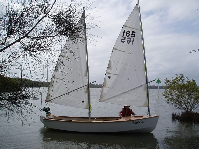

Peter HK Posted March 13, 2011 Posted March 13, 2011 If by racing rig you mean battens/roach then I chose that option. As to sailing comparisons I wouldn't know as there are no battenless CS17s around here to race against, but one expects it would be faster. Sail area on mine, according to the sailmaker's computer, is 139sq ft. As you can see from the photo I have a full length batten at the top and 2 reefs ...I've only had to put in one reef so far. Masts are the same. Cheers Peter HK Quote

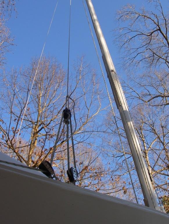

paul_stewart Posted March 23, 2011 Posted March 23, 2011 Chris, The asymmetric spinnaker tacks much like a jib. We also used the mizzen stays'l as a jib out on the bowsprit. To prevent those sails from breaking the main mast we have back stays that are 3-to-1 running back stays (RBS) (see image below). At all times at least one RBS is slack; both are slack if no sails are on the bowsprit. We have bungee lines that pull the RBSs neatly closer to the base of the main mast when they are slack. It turned out that the RBS was not needed in light-to-moderate air. But, you never know when an unexpected mast-breaking gust might strike, so we always used it. Adding the spinnaker added a few lines: halyard, tack, sheet, port RBS, starboard RBS, plus the bungees to keep each RBS neat. We also stretched a bungee around the tip of the main spritboom to help keep the spinnaker from snagging on the spritboom when tacking. I'm the one that is pretty good at tweaking the boat for relaxed cruising. Alan (aka SOS or Alanosauras) is the one that expertly turned the boat into a kick-ass racing machine. Photos here: http://messing-about.com/forums/index.php?/topic/7215-everglades-challenge/ --Paul Quote
