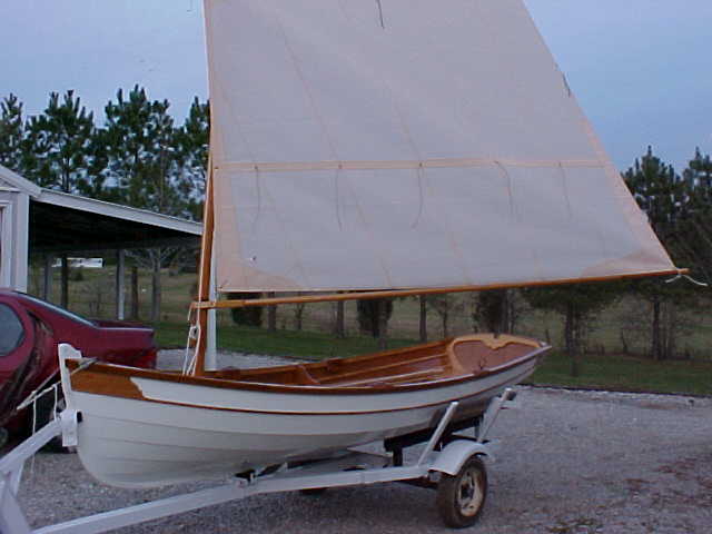

Jon I Had a lug rig on my Penobsot 14 ( I believe it was a called a standing lug ) and it was a nice rig for the boat. There is the dipping lug, standing lug, balanced lug, chinese lug and the solent lug according to Bolger. Bolger said in his book 103 sail rigs, ( I'm going to paraphrase ) basically this rig is a dog. I disagree, it wouldn't go to the wind super tight but respectable. It was easy to rig at the ramp, having a short mast and a yard. I could store the sail rolled up and laced to the yard in a 4" PVC tube with end caps on it. Made it nice for storage and storing on the boat while trailering. The mast was short enough to stole in the boat also.
The only real problem I had was, down wind in a very fresh breeze she would get a bit squirrely, A lot of cat rigs do you know. But I don't know if that was the hull, rig or the person at the helm.
Mine was a traditional standing lug, not as Peter's. He may have been able to get more out of his with the battens and curved leech.
Over all I liked the rig, but don't know how it would be on a spindrift.
Here's a pic of mine, couldn't find one right now of her under sail.
