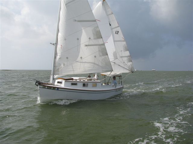

Travis Votaw Posted July 11, 2010 Posted July 11, 2010 The 10.3mph on PILGRIM registered with the GPS was under full sail with the miz staysail flying. I think we were in one of the shallow bays on that trip without too much current, if any. The old girl was pretty well maxed out for my comfort and we soon took in the staysail and tied in a reef. I don't think the hull would ever plane, but it is fairly light displacement and has a pretty flat run run, so I believe her hull speed could exceed the standard calculation method if pressed enough. Just my opinion - maybe Graham can weigh in at some point. This pic is from last year's TX200, and as you can see, she is moving out pretty well :smile:. Quote
