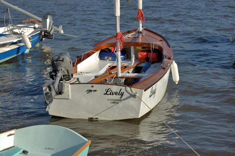

I've been inspired with this nice photo of "Lively" having a Sea Pearl aft in the background:
I will appreciate your comments.
I suppose that if the motor and the board/bracket could be easily removed on the water and stored in the boat while sailing it would be OK.  It isn't so much the stability as what happens when the boat heels over while sailing.  I have a friend who uses a home made side mount bracket for his Rozinante as there is no transom to mount on. The bracket mounts just a little aft of amidships.  He keeps his tiny kicker and the bracket stored below and uses it extremely rarely.  I would think that even if you designed a workable bracket like you show that a short shaft motor would still work poorly in any kind of waves.
I'd be very worried about the forces on the transom that would be created if you heeled at speed and dragged your motor bracket.  You'd have to really reinforce the transom--just in case.
In gusts, my boat has often heeled far enough to put the outboard end of that motor mount under water.
You should be able to fabricate a bolt-on mount that sits low enough on the transom for the short shaft motor.  Actually, the lower you can get it the better (within reason) because the mizzen sheet likes to wrap around anything that is above deck level.

I'd be worried that motoring in anything other than calm conditions wouldn't be possible as, with any roll, the prop would ventilate as it's so far from the midline.
