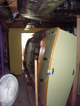

  the 3'6" is the draft with the centerboard down.  I'll go measure the space where I rolled my CS17 out of my "shop" and post it in a few minutes.
Very cool, Scott.
I won't bother to post my door dimensions since it was wider.  I had about an inch to spare but my boat left the shop upright.  I removed a section of wall in the screened-porch shop and replaced it after the move.
Adam, my shop is 18x18 but the boat wasn't the only thing happening there.  People have built these boats in quite small spaces, probably approaching 8x18 with the aid of a wheeled dolly to move the boat out to work on it.  Obviously, the more room the better, but it doesn't take much if you're determined.

Great photo!
I have a 15' x 25' heated basement that would be such a nice place to work. There is a door straight to the driveway with only two steps down...but I think it might be just too tight to get the boat out. It has a 30" wide door, which sounds too small already, and the door is on the long side of the room so the boat would have to go through at an angle. Any advice to figure it out for sure? Do you think the CS15 would fit?
Otherwise I have an unheated garage I could work in that would be fine I'm sure. It floods a little sometimes and the floor isn't level but those are probably not such big problems, I could still do sub-assembly in the basement.
You could easily remove the door and it's jam, which will offer a few more inches. Given a choice between a nice heated work space and a uneven, sometimes partly flooded place to build, the heated space makes much more sense, even if it means a new door and frame when you're done.

That is good advice. If I remove the jam I should have at least 34" and that was enough for Scott. Scott, do you think your boat would have fit if there was only 15ft of "run up" on the other side? The boat would have to start its way out at a little angle for the first couple of feet.

I don't think the 15' run up space should be trouble; there was a fair amount of space to play with right up to when the coaming starts- and I build a pretty high coaming.  You should be able to angle it in for at least a couple of feet.
And removing a jam and a two by four or two is always easy enough after you've built a whole boat!
