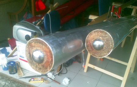

I've also heard about a metal ball under a mast - centrally placed and partially hidden in the wood - to help rotate smoothly, too.

just glued in  those metall balls - they are of 3 cm diameter each and come from bearings.
