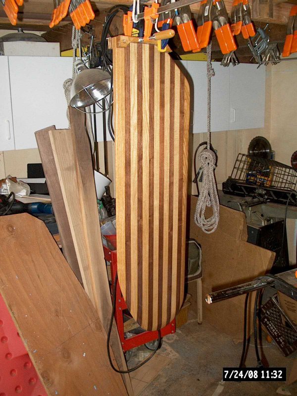

Plywood centerboards MAY warp, or (as in your case) MAY NOT.  Properly constructed laminated boards won't.  We've been doing this in Graham's boat class "forever."  Take a piece of plain sawn 2x fir and cut it in strips whose width is just a bit more than you want the thickness of the centerboard.  Turn the strips on edge, reverse every other one end for end to reverse the grain, and epoxy them together, making sure that you keep it flat.  Now your finished board is made up of reversed quarter sawn strips.  Now shape the board and you'll have one that not only stays flat, but looks great.  I've never seen Graham do this with a rudder, but there's no reason you couldn't.  Rudders aren't as apt to jam.

I plan to use the laminated strip type on the Spindrift I am building....it looks way too pretty not to use. :)

The tendency for solid wood to warp is minimized by the vertical lamination and alternate flipping of each laminate orientation.  The natural tendency of an individual piece to warp is minimized by the canceling effect of flipping adjacent pieces.  Plywood can still warp, especially if it is subjected to any unbalanced force or moisture for an extended period of time.  Inferior plywood can warp with no apparent cause.  We are experiencing a lot of this in Chinese plywood right now.  Awful stuff.

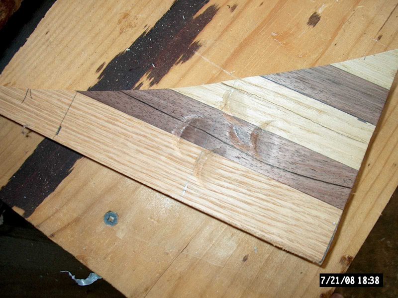

This discussion just gave me an idea.  What would the effect be if the strip construction used a V groove, male on one side of a strip, and female on the mating side of the next strip.  It would be a sort of tongue and groove and should be strong.  Biscuits or dowels would not be needed then either.
I have thought of mating surfaces, too, but I don't know if the grain orientation would be a factor.  The stress on the overlapping portions of a vee would be on the grain's weak axis.  Also, half the glue would be in tension, half in compression - I have no clue what that would mean for the strength of the bond.
Worse, I just bought a biscuit joiner.  I dread the thought of not being able to play with the new toy!  ;D
Here are a couple of other centerboard questions.  I bought Douglas Fir for my centerboard.  Is that suitable?  All I could find were 4x4s, so I've ripped them into 2x2s (about 1 3/4 per side).  I could stretch my clear-grain wood if I used rectangular, not square, strips for the laminations.  Understanding that the grain needs to flip-flop as depicted in Graham's plans, is there any problem with fewer strips in the lamination?
Also, I don't have clear-grain in enough full-length pieces.  Is there any problem with interspersing partial length strips between full length?

Greg, biscuits are a better choice because the diagonal stress is at 90 degree angle and although you may increase the surface area by 50% or so with V slot, you reduce the stress capability because it probably mates at close to 45%.  As others have noted, maximize the strength by  increasing the angle against the grain is maximized around 90%.  It is also dependent upon the relationship of the grain orientation.  Alternating the grain increases the strength and minimizes the potential to warp, does make the wood susceptable to rough surface when planning as I think I noted before.  Biscuits are fun and easy and provide additional strength points over a large join at 90 degrees and it does not take many spaced evenly apart.  I used a 3 by 2 alternating join with the biscuits.  Between first board 3 biscuits and next two, next three and on and on.  With the epoxy you should get a really strong join.  Concern I would have with a "V" cut is the slippage between the pieces when you try to press and clamp.  Even with biscuits, the boards will slip and it is really important to have FLAT surface to press pieces against.  I push and HOLD DOWN, even weight down sometimes against clamp bars, and then I am more able to apply higher consistant and constant pressure with the jaws of the clamps.  Again physics, minimize ability to misalign as pressure is applied and the work you will have to do to push hold down or pull in the strips to keep them flat against clamp bars.  (Trust me, it ain't never going to even or level, just do the best you can and it will work out).  It is not uncommon in my experiance when joining strips that they will "buck" as the uneven edges come together and are pressed together, usually because  I join edges in the rough (ruff), not necessarily true to square and they move, but taking time to square is very time consumming (eats up good wood too) and I do not think necessary when you are joining with thicken epoxy, and adding an additional 1/2" or more thickness to the board you are making.  Making the boards thicker (as far as I am concerned) makes it more more easily be planned to square and true, as I am sure you know.  Of course making strips as square as possible is best to prevent slippage when clamping, but you will still have to press the wood down with hammer, blocks and back, into the pipe clamps for flating and squaring as best as possible that you can, when max pressure is applied.  I use my son's weights to help keep pressed across the joins.  Does it always work, NO, but it will come close enough to make it good to plane in if you make sure you add enough thickness to allow thorough planning of any piece as you know.  I would always go with the biscuit joiner, read many acticles and data that indicate it works best for butt joins.  Choice you have to make is how close should the biscuits be, can't tell you a thing about that, I did mine at around 10 to 12 inches apart over a 5 foot work piece, like I said on a 3 -2 alternating setup.  And again, it is critical to get really good and I think thickened epoxy coverage with really good epoxy.  8)  Hope this helps, just more info from a dumb engineer.
