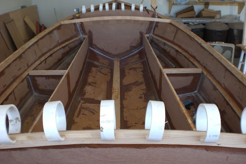

Randy C. Posted July 5, 2008 Author Posted July 5, 2008 Where did I go wrong? I started laying out the seats today. The seat stringers are level from the aft bulkhead up to the center seat bulkhead(69" mark), then they go uphill. They're off about 3/4" at the foreward bulkhead. I thought I had the keel pulled together tight before I did the epoxy. I guess my cuts were a little off. Any suggestions on what to do??? Quote
Randy C. Posted July 5, 2008 Author Posted July 5, 2008 Ray, I have the boat level according to DWL and the seat stringers do just what you're saying. So, do I draw a string line from the top of the seat stringer forward to the top of the seat stringer aft and cut the seat front straight and let the seat sag a little in the middle? I think this is what you're saying. Then put the drain at the low spot of the seat top..?? Quote
Randy C. Posted July 5, 2008 Author Posted July 5, 2008 Ray, That makes sense. I really didn't think using a string seemed right. Thanks for clearing that up for me!! Back to the shop. Quote

Randy C. Posted July 12, 2008 Author Posted July 12, 2008 I'm working on the seats. I have them epoxied in place. It would be easier to do the fillets and tape from the inside. At what point is it O.K. to get in the boat to work on it? I weigh @ 180 lbs. Quote
Randy C. Posted July 14, 2008 Author Posted July 14, 2008 Ray, Thanks, I did the fillets and tape early this morning. I just reached over the side. Quote
