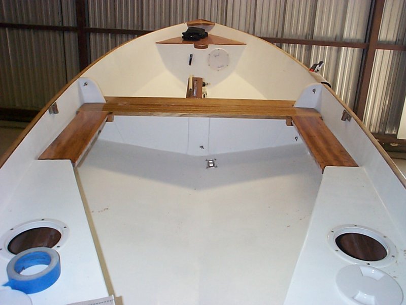

Steve Day Posted March 12, 2008 Posted March 12, 2008 I used the "screw-in" handholes with the "O" ring seal in my Spindrift and they have worked very well. I placed them so that I could reach all of the floatation area with my hands to get stuff out of the compartment easily. I store spare connecting bolts, registration, flares, etc and have had no problem with leaks since I put the boat into commission in 2004. Here are a couple of photos of the "hatch" placement. These are the best I could have put into this boat. I have used them before in other applications and will use them again in future applications. Steve Quote

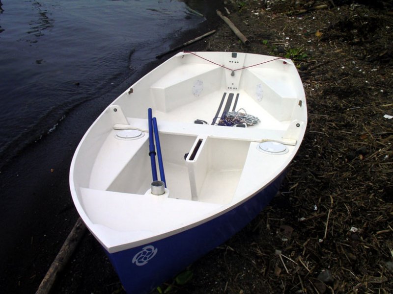

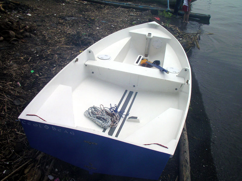

PinoyPiper Posted March 12, 2008 Posted March 12, 2008 here's how the seats and hatches are laid out on mine, 5" and 6" screw in round hatches with O-rings. Quote
