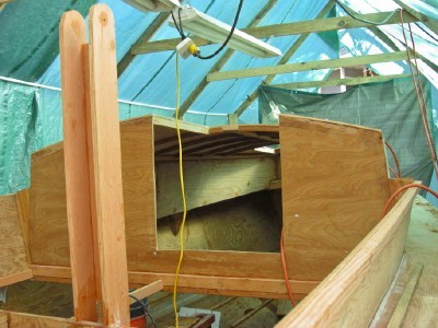

Norman Colter Posted September 22, 2007 Posted September 22, 2007 G'day all, Been having far too much fun. Got her safely rolled and leveled. Main and mizzen mast tabernacles made and installed. Cabin aft bulkhead installed. Deck knees in, and cabin carlins. Seatback carlins too. Scarfed a three foot piece onto an eight then ripped it down the middle and the foredeck ply at the sametime. Cabin sides cut and dry fit. Seatbacks installed. Centerboard tackle purchased and beginning to be installed. Here's some pics. Norm Quote

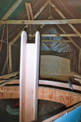

Norman Colter Posted October 7, 2007 Author Posted October 7, 2007 Finally bought a digital camera. Worked a little on the boat this evening, took a picture at quitting time, and posted less than fifteen minutes later. Isn't technology grand. Norm Quote

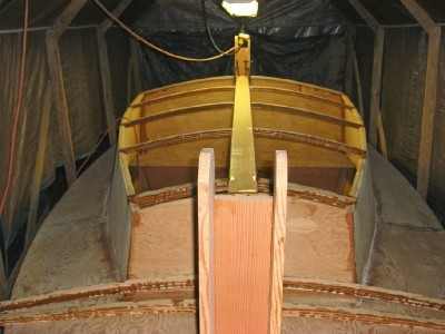

Norman Colter Posted October 8, 2007 Author Posted October 8, 2007 And still having fun! Thanks Love these Monday holidays. Once the epoxy sets I'm ready to skin the cabin top. Then the thrill of cutting into boat. Norm Quote

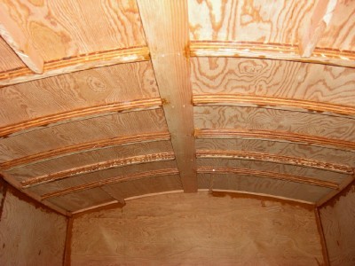

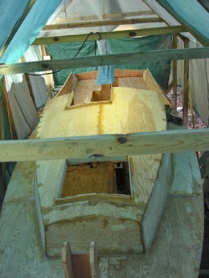

Norman Colter Posted October 14, 2007 Author Posted October 14, 2007 More progress. Yes there is an extra, and the spacing is not per plan. But it holds me real well. Norm Quote
Howard Posted October 14, 2007 Posted October 14, 2007 Good progress Norm. Fun it is! On the fore and aft plank on top of the cabin beams, on early photos, that plank looks to be laying on top of the cabin beams like it was to be inset flush into the beams. In your last photo, you can see the bottom of the plank, making it look like the ends of the beams may be chopped off and notched into the side of that top cabin plank. Just curious how it goes together. I would think for the decking to lay flush, the top of the plank and deck beams would also have to be flush. Quote
Charlie Jones Posted October 14, 2007 Posted October 14, 2007 I'm wondering the same thing- that beam SHOULD be notched into the deck beams. I'm also wondering where is his forward hatch framing?- He's gonna want that for ventilation. Quote
Norman Colter Posted October 15, 2007 Author Posted October 15, 2007 The cabin beams and the center plank are flush. The hatch frame is there. I made the cabin beams by laminating three layers of 3/8 ply in a jig to give me the curve. Then notched them to the cabin sides and the center. It hasn't been warm enough to epoxy, but the ply is screwed down and it holds my 200+ without deflecting. The plan is to cut the hatch and companionway after epoxy. Norm Quote

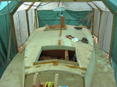

Norman Colter Posted November 2, 2007 Author Posted November 2, 2007 G'day All, Had a couple warm days this past week. Probably a wet and windy weekend ahead. Might be time to clean up the shop and start preparations for indoor work. Lofty goals; two masts, two cabin hatches, two cockpit hatches and two lazarette hatches. Here's this afternoons view. Norm Quote

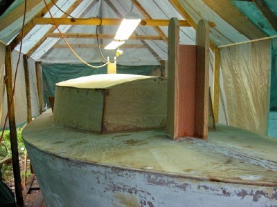

Norman Colter Posted November 7, 2007 Author Posted November 7, 2007 G'day All, The remnants of hurricane Noel tried to take down my boatshed last weekend. Had to climb up to pull the tarp back on and got a perspective to share. Pretty much done with outside epoxy use for this year Norm Quote
