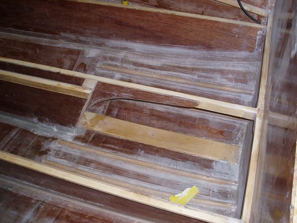

I have looked at the pictures on the CD and the plans and I am still not sure of the answer. On a CS 20, does the starboard side of the centerboard case have an arm extending forward as the port one does or is it just cut at an angle to the top of the case to match the king post? It appears to me that it does not have the arm. Am I right?

I do have a question, why does the design only extend the port centerboard stringer to the forward bulkhead? Would it not be stronger if both side extended to the bulkhead? I am sure that it is not necessary, but I already have the right size stringer, which I will have to cut off for the starboard side. I understand that a lot of this unnecessary modifications can quickly add a lot of weight. Would it interfere with something?
Re the stringer, I think you nailed it in the question. You can always make it stronger and heavier, but if it is already strong enough why would you. I doubt it would get in the way but it's not necessary.
In boatbuilding of this type it's important to add LOTS of lightness, so that the performance of the finished product is all that you hoped it might be.
Go on - cut it off.
Peter HK

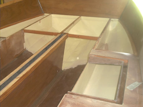

By the time you get the two cross supports in at the rear edge of the seat decking, and the center two installed that support the deck, you'll have all the strength you need. Plus adding the second stringer forward would interfere with seating those cross braces. You'd have to notch one side or the other anyway. I usually notch at a angle so the cross piece sits inside the fore and aft stringer, but is only in at the top level- the angle is as much as the vertical thickness of the cross part.
If that makes any sense. If not I'll set up a pic tomorrow ( today?) and show you.
Remember - every un necessary pound you put into the boat is an extra pound of dead weight. Also a pound of payload taken away. And you gain not much of anything. You paid for Graham's expertise- use it.
