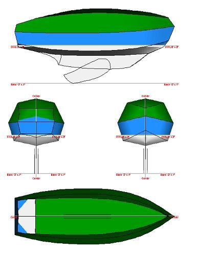

lewisboats Posted April 13, 2006 Posted April 13, 2006 Despite the fact that I know it has too much windage, it has buttocks lines that tend to match my own and a rather chubby front end that also has a disturbing familiarity... I persist in building this rather odd design of mine. It may or may not have any practical application being a rather slow and bulky single person lake and lagoon cruiser. Still, something about this ugly duckling insists that I build it, just to see if it works. Here is a picture of what it should end up resembling and I am building it here: http://www.angelfire.com/ego/lewisboatworks/html/GuppyIIbuildnav.htm and if you follow Duckworks Magazine each installment has shown up about 2 months after I sent it to Chuck. Steve Say...is there some reason I can't attach a 50k jpeg??? Quote

lewisboats Posted April 14, 2006 Author Posted April 14, 2006 Neat little boat. Do you have any other views besides those shown in the drawing at the top of each page? I'm curious about what the cockpit area will look like. What sort of sailing rig will you use? Are you planning to run lines inside ala Paradox? No on the views. There is a small (3'x width) cockpit with wrap around sides and there is a removable slot top to allow sail handling. Seeing as it is cat rigged with an unstayed mast it will most likely be a Gaff, Lug or Sprit sail. Here (I hope) is the picture I was trying to post. This is more like what it will look like as the picture on the pages is of the original which was about 9 ft long. Steve Quote

JeffM Posted June 24, 2007 Posted June 24, 2007 Steve, does this boat have a full keel, rather than the shoal keel/cb in your drawings? Looks like a full, solid keel in the photos. Quote
lewisboats Posted June 24, 2007 Author Posted June 24, 2007 That shoal keel/CB in the pictures is the same as what is on it. It sure looks deeper but it is only 12" from the center of the Vee to the edge of the keel. I am still debating adding the foil, and if I do it will probably be bolted to one side or another rather than going down through the keel itself...much less of a hole thru the wood to worry about. I don't even know if I could cut down thru the keel accurately enough to make a slot for the blade. Steve Quote

lewisboats Posted July 15, 2007 Author Posted July 15, 2007 Hey...I can design one of those too! FreeShip tells me I displace 2800 lbs at the shown draft of 39" with a length of 10 ft and a beam of 5'9". depth from top of cabin roof to bottom of keel is 7' 1.5" with an interior maximum headroom of 4' 10" (sole to cabin roof). Hang 500 lbs of lead on the bottom of the keel and a hull wt of 350 lbs and you have 1950 lbs of "stuff" you can carry...'course I don't see WHERE you would put 1950 lbs of "stuff" but that is just a minor glitch : Estimated gonads to the wall speed of 3.5 kts...probably more like 2.5-3 kts and you will be spending many moons doing a round the world in this baby...and boy...will you stink at the end. ;D Steve Quote
