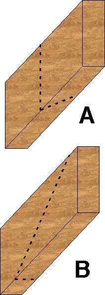

This may seem like a dumb question, but of the two scarf patterns I've drawn, which is most correct for scarfing stave lumber? A or B? The reason I ask is that I've seen both used on wood. A is used on plywood.
Would finger joints work to scarf these staves together?
I think B makes more sense for solid wood because it creates a joint that is much closer to being a long grain to long grain joint and because the faying surfaces are so much larger.
A makes sense on plywood though.
Howard- use B
And I personally would not trust a finger joint in this type of application. Finger joints are fine for unstressed use, but there will be a bending load on a mast- I'd go for the longest scarf and glue surface possible. Which is "B" in your drawings. That will also make the nicest looking joint in the finished spar.
I think the best choice depends on how the wood will be bent, doesn't it?
It seems to me that B is going to be more prone to splitting if the joint is bent around a compound curve (say a rubrail), won't it? In other words, of you both twist and bend the wood, won't the rotational force cause the B joint to bend and break? (Which is why B is bad for plywood, it would break as soon as you bend the plywood)
For the mast, though, I think B would be the superior one.

Scarf B is what I would have guessed, but I have a book in which a large 50 foot mast was built using A. They built a jig to use a Skilsaw to cut the scarf, but had to finish them with a handsaw, as the circular saw blade could not cut all the way through.

Noel, if the glue joint is made properly it will be stronger than the wood. There shouldn't be any problem with using scarf B in a compound curve. The one problem might be that the piece might have a hard spot where the scarf is and wouldn't make a smooth, fair curve.

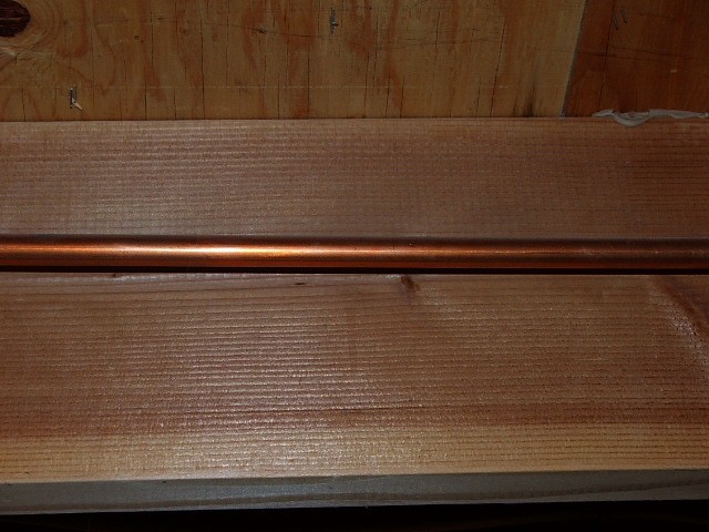

The hem-fir issue was raised as a possible substitute if I couldn't find the right mix of doug fir. I do have a 16' doug fir board, again...leftover and not used for anything for close to 15 years now. Parts of it are ok, but overall, it's not that good. But if I ripped the whole thing down, I'm sure I can find enough clear pieces to scarf together 8 - 18' lengths for a birdsmouth mast.
I snapped a photo of the board in question. The other pic is an example of some of my floor joists. Some of those are really good....but alas....already used. :wink:
