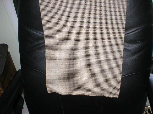

Proper fitting grates are a must, and removable. As far as wear, I am now using the non-slip material glued to the back sides for any grate strips. The water is the big issue, keeping your gear and feet above any decks, or boat floorboards. Even with coolers on the fishing hulls, I use it under the coolers and the cooler rarely slides much if any in weather conditions.
Click twice for clarity. West Marine sells it, and even our local bigbox stores now carry it.
