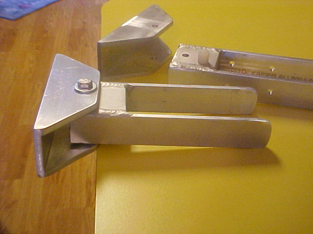

Scott Dunsworth Posted October 31, 2005 Author Posted October 31, 2005 Here are some pictures of the semi finished gudgeons. I still have to drill some of the mounting holes and polish them up. The nylon bushing in the picture is not the right size. I have to stop by lowes and get a couple along with four nylon washers. When installed there will be no metal against metal anywhere. The only concern I have, is these gudgeons will only alow the rudder to turn a little past 45 degrees from center. I can make them turn completely 90 degrees by rounding the corners of the rudder piece. Don't know if that is necessary though. Any thoughts? When I got done paying the welder the total investment is $55. Scott Quote

Designer Posted November 4, 2005 Posted November 4, 2005 Tim, we sell that same Racelite gudgeon and pintle set for $19.20 and we have two larger sizes but none of them big enough for Scott's rudder, he did the right thing to build his own. Charlie is right about rudder stops being set at 35 degrees but I disagree with him about not grinding off the corners. I am not concerned about Scott using too much helm, I am concerned about stressing the pintles. The distance from from the pin to the corner where it would hit the gudgeon is probably about 1 1/4" and his tiller is 48" long which would give him a leverage of 38. Imagine that he pushes the tiller over with a force of only 20#, that would equate to a force of 760 # at the pintles. What about the boat running off the trailer and the water hits the raised rudder blade and slams the rudder over against that stop. Rudder stops are usually set about a foot from the rudder stock so that the stopping forces are not so large. Quote

Tom Lathrop Posted November 4, 2005 Posted November 4, 2005 Scott, Looks like a good job. One question that occurs to me is the strength of the pin bolt. It looks kind of small, especially regarding the point Graham brings up about shock loads caused by hitting the stops. Even in Indiana, I'd be concerned about stainless and aluminum being close to each other although the nylon bushing may adequately separate them. Nylon may be a bit soft for a bushing. Delrin would be better. Quote
Scott Dunsworth Posted November 5, 2005 Author Posted November 5, 2005 Thanks for the insight on the leverage thing Graham. I can see how you could rip the gundgeons right out of the boat. Its not a big deal for me to round off the corners where the rudder will turn the full 90 degrees. Tom the pin is 5/16ths and it does make contact with aluminum where it passes through the gundeon. THe nylon is pretty hard. I drilled the hole 1/2 inch in the pinnacle and inserted the bushing. And nylon washers on the top and bottom. With them all together the action is very smooth with no slop. If the bushings don't last to long it will only take a few minutes to push the old one out and insert a new one for 97 cents. Some of the factory made sets I looked at had nylon bushings. Thats where I got the idea to add them to my home made hinges. Quote
