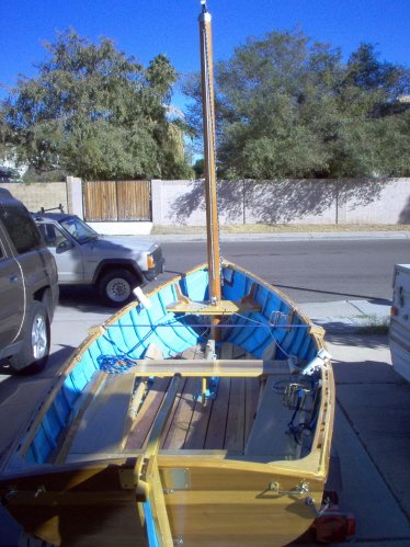

  1. Back in approx. 2002 I built a small row-boat that also came with options to use as a sailboat. It is called The Great Island Rowboat and I got the plans from Duck Trap Boats. I was ambitious back then and built all the options for sailing it i.e: built a mast, rudder, dagger-board, and sprit-rig sail and had a lot of fun doing it. I even took some sailing lessons back in 2005, but to this day I have yet to take it out sailing. Used a lot with elect trolling motor, but no sailing because need to fix problem with the dagger board. The problem is the dagger-board is too thick and gets stuck in the trunk or slot making it a pain to get in or out. The thickness of the dagger is approx. half-inch made from wood and I managed to set in some lead discs for added ballast (not that it was really needed). I am questioning if it makes sense to just keep sanding it down so once it is re-varnished it will slid easily in/out of slot or should I re-make it with thinner material but then re-enforce for strength with some metal plates or something?

  4. I built a Great Island Rowboat (see image) from Ducktrap boats 7-8 years ago and it was fun to build and use over the past few years. However, now that I am older and with knee and back problems at my youthfull age of 53, I dont sit in this boat so well anymore. My primary interest now is fly fishing, so looking for a wood boat or thin wood and fiberglass design of construction that I know I can do. I want a 12-16 ft LOA and wider beam than my boat below (4' 4") that is real stable so can stand at time for fly casting. My other concern is good deep or high seating (however it is defined) so my legs dont cramp or back get aching as it does with my current boat. The rear seat in my boat is approx only 6-8 inches off the floor deck and middle seat is maybe 10-12. I also want something with more freeboard as current is to low and near water at stern if Isit all the way in back. I have looked at a site called Montanaboatbuilders.com tha has some really nice speciallized boats for fly fishing but yet most dont seam to have a stern for mount of a motor. But I am unsure of boat designs that offer best stability. I have looked at many skiff, drift and prams but which would have the stability and seating that i am asking for? Please make suggestions.
  5. It has been quite awhile since I posted here last. Finished up my Great-island rowboat and sail rig last year and it works good. Only problem is I have gotten older stiffer and need something with more leg room, able to stand in a bit and do my fly fishing from. I am starting to look to see if I want to build a bass style of boat. I have seen the one bass boat listed on glen-L.com but wondering if anyone here might have a link or direction to a site with a different looking bass boat, so I can look at all the options.
