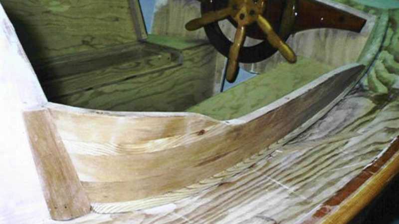

kydocfrog Posted September 20, 2005 Posted September 20, 2005 I have abbreviated ones. They should show in the posting I did called "making progress" DocA Quote

kydocfrog Posted September 20, 2005 Posted September 20, 2005 Opps. Called "Progressing." In the lower picture, the splash coaming ends just an inch or two past where the picture is cropped. I figure some protection and still some ability to sit out if I need to. DocA Quote

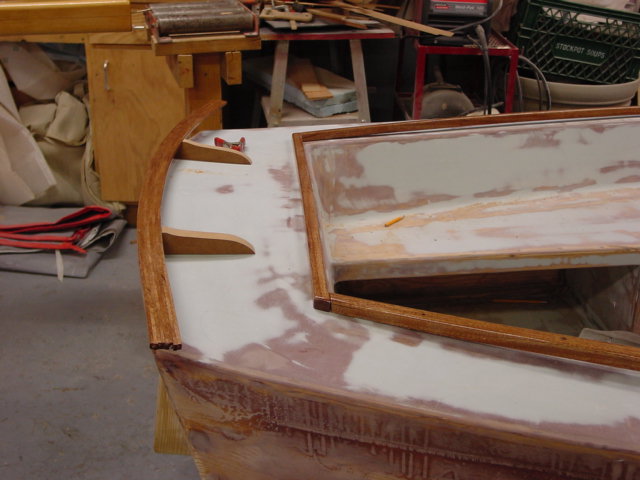

capt jake Posted September 21, 2005 Posted September 21, 2005 Though it is not completed in this photo, you get the idea. [/img] Quote
