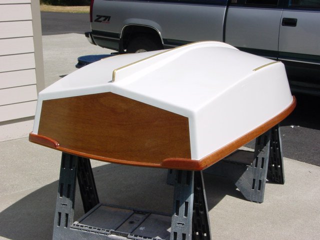

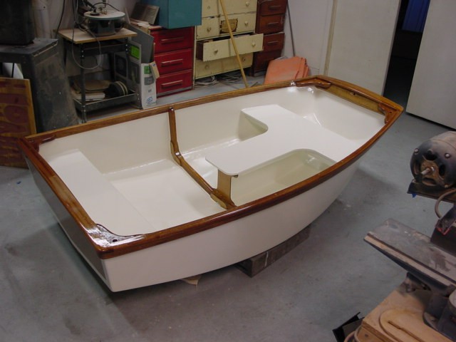

capt jake Posted August 19, 2005 Author Posted August 19, 2005 What an outstanding feeling! 4 hours since the last coat and I removed the masking. It is beautiful IMHO! I am so impressed with spraying, and now that I am well, less intimidated; I will have to spray from now on! Sorry Ray, no more brushes and rollers for me! ;) I should have bought one of these set ups many years ago, but was to intimidated by it all. Hey, I had a set back or two getting it set up, but now I am sold! That yucky paint ain't so yucky anymore. ;) Quote

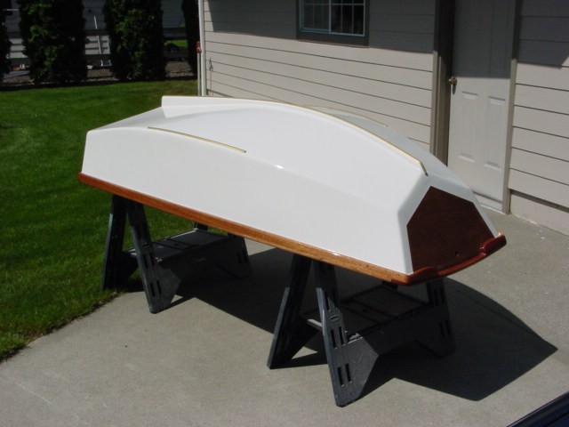

capt jake Posted August 19, 2005 Author Posted August 19, 2005 I am sure that inquiring minds want to know........so here ya go! 3 hours and a spray gun. Quote
John Turpin Posted August 19, 2005 Posted August 19, 2005 Great looking MiniPaw. You obviously know what you're doing! Quote

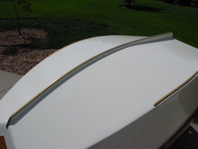

Charlie Jones Posted August 19, 2005 Posted August 19, 2005 looks GREAT Jake. I added some runners on the bottom of ours also, because we have these coarse shell beaches around. Mine aren't brass Quote
Craig Posted August 20, 2005 Posted August 20, 2005 That looks great Jake. I got tires of fooling around tipping the Allgrip on Tom's Hard Top and finished the outside from the canvas rail to the edge with a touch up gun at about 25lb. Came out great. I kind of like that All Grip but it's too pricey for my boat. The stuff dries like iron. Quote

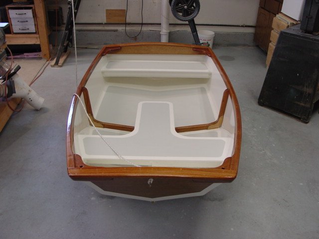

capt jake Posted August 24, 2005 Author Posted August 24, 2005 Aside from the overspray (which is rather sticky due to the slow drying paint I am using) I really like spraying. After getting over the intitial butterflies, it goes pretty well. The nice thing about this oil based paint is that it gives sufficient opent time to deal with runs if you get them. I have wet down a rag with mineral spirits and wiped away one whole section as I was learning. Bad part is (as stated above) the overspray doesn't dry prior to 'landing', but the up side is that the overspray blends well if it lands on a freshly painted area. Spraying the inside of the mini is a bit of a challenge, but it is far superior to roll and tip as I have 3 coats on in about 2 1/2 hours. Naptha gives a good balance of thinning and flashing fast enough to apply one coat every hour or so (better than minieral spirits). I was told not to use acetone as it dries too fast and would cause the paint to be brittle. One or two more coats and I will be done for the day. Tommorow I will mask off teh non-skid areas and roll those on. Quote
capt jake Posted August 25, 2005 Author Posted August 25, 2005 OK, I am nearly done. I have to put on the contrasting non-skid and set the oarlocks. Painting with a spray gun is much nicer than a brush. The inside was done in three hours and the masking removed after another 4. Quote

capt jake Posted August 25, 2005 Author Posted August 25, 2005 This paint (Benjamin Moore M22) doesn't specify a thinner. Only Mineral Spirits for clean up. The store manager is the one I got the information about Naptha from. Actually, I think the Acetone would be a little hard to work with because it kicks off so fast. If you are spraying a large are with no pockets or voids (like the cockpit on a Weekender) it may do quite well. When I had the Weekender painted (automotive urethane enamel) we had to go back and polich quite a few ares because of the overspray. The longer open time allows for teh overspray to settle and blend in a bit. Of course it sticks to everything else also. It has also been a long time since I held a gun (20 plus years), The inside of my shop door is now a nice white color from test spraying! Added light in the shop! :shock: Quote

capt jake Posted August 25, 2005 Author Posted August 25, 2005 I just returned from the paint store. The owner stated that the main reason they do not recommend thinning is that many people tend to thin it too much and not apply enough to build the film thickness. I was applying wet on wet, thus blending the coats together, he stated that this woud be the way to do it if you thin it. The paint companies basically consider a paint that is thinned too much as no longer being the product they designed (as he said). Just got a contrasting gray; thinned it with naptha and added teh non-skid. I will wait a few hours and apply the second coat. Quote

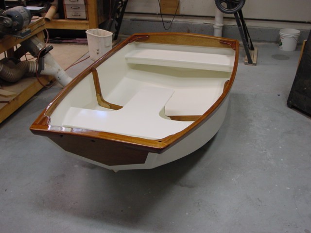

capt jake Posted August 26, 2005 Author Posted August 26, 2005 I'll get some pictures in the AM. I am not happy with the way non-skid additive and paint go on. In all cases that I have applied it, it appears blotchy. I just finished rolling on another coat without the additive. Now on the next boat (when I get the go ahead) I will try to replicate what Devlin does (of course teh next boat will be quite larger). Hopefully Joel (boatbuilder.org) will chime in on this. Joel explained that they simply take paint (I don't think they thin it) and shoot it on with a gun. They dial the pressure down to where it comes out in a really rough orange peel. Any of you who have seen the non-skid on a Devlin boat will know what I am refering to. It looks very nice, kinda like a smoother version of the texture on a sprayed on bed-liner. Quote

capt jake Posted August 26, 2005 Author Posted August 26, 2005 OK, all done. There are a few things 'missing' yet; let's see who guesses it first. Another straight coat of paint on the non-skid seems to even out the color, though the 'sand' (for lack of a better term) is blotchy. Oh well. Hmmmm, picture do post in the opposite order as uploaded. Interesting???.. Quote
Charlie Jones Posted August 26, 2005 Posted August 26, 2005 Looking Great!! Now put the locks on her and go rowing I used the Interlux Interdeck on Tehani- we're really happy with the way it turned out. I've also done nonskid like is shown in Bingham's "Sailor's Sketchbook" with excellent results. I've used that on 3 boats so far. Of course you COULD make your Mini look like this Quote
capt jake Posted August 27, 2005 Author Posted August 27, 2005 Good going Charlie, no oarlocks yet. ;) Say, what is Binghams method of non-skid? Also, interdeck; that is a pre-made non-skid? I simply bought the additive (like a powder) and added it to the paint per the instructions. Quote
