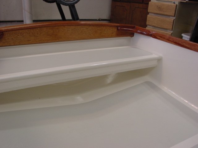

Guest Posted August 27, 2005 Posted August 27, 2005 OK, all done. There are a few things 'missing' yet; let's see who guesses it first Water. Quote
capt jake Posted August 27, 2005 Author Posted August 27, 2005 Water. Never thought of that! :oops: I'll fill it up tommorow and see if it leaks. :shock: :shock: (legal notice, don't try this at home as it will most likely cause you boat to leaks severely when it comes loose at the joints.) Quote
