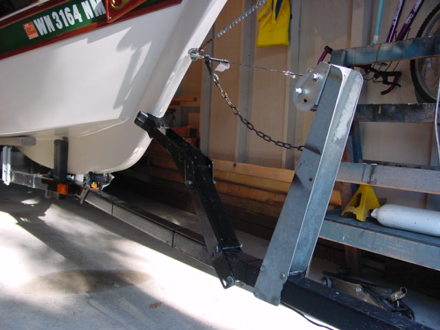

This is simply 2 pieces of 2x8, wrapped with marine carpet and attached to the stub of the toungue. It is at just about the deepest part of the forefoot but does not go all the way up to where it would hit the bottom of the hull. When we load the boat it can be quite a ways off center until you guide it into these two guides. The boat then centers itself quite well. They are 'fairly' snug, or should I say that there is little room between them. The carpet is just barely touching the keel.
Another tidbit is to separate you bow brace (or whateveer they call it) from the winch. I found that if the winch was located with the brace (as most are) it was a pain to get to and depending upon the incline of the ramp, the bowsprit may cpontact it while retriving.
I have since fashioned one brace for the bow and one for the winch. The one kicker here is that when I lowered the bow brace (to help clear the sprit and dolphin striker) the geometry is off when you bring her out of the water. In other owrds, yoiu can't pull the boat (with the winch) all of the way tight to the bow brace. Remember that when the boat comes out of the water the transom will go down, thus raising the bow (on the trailer) sliightly. This puts a huge load on the brace. I winch it up to within about 2" (yours may vary depending upon design); pull the boat out of the water to the point where the transom is just barely in the water. Then go back and winch her up the rest of the way prior to complete pull out.
