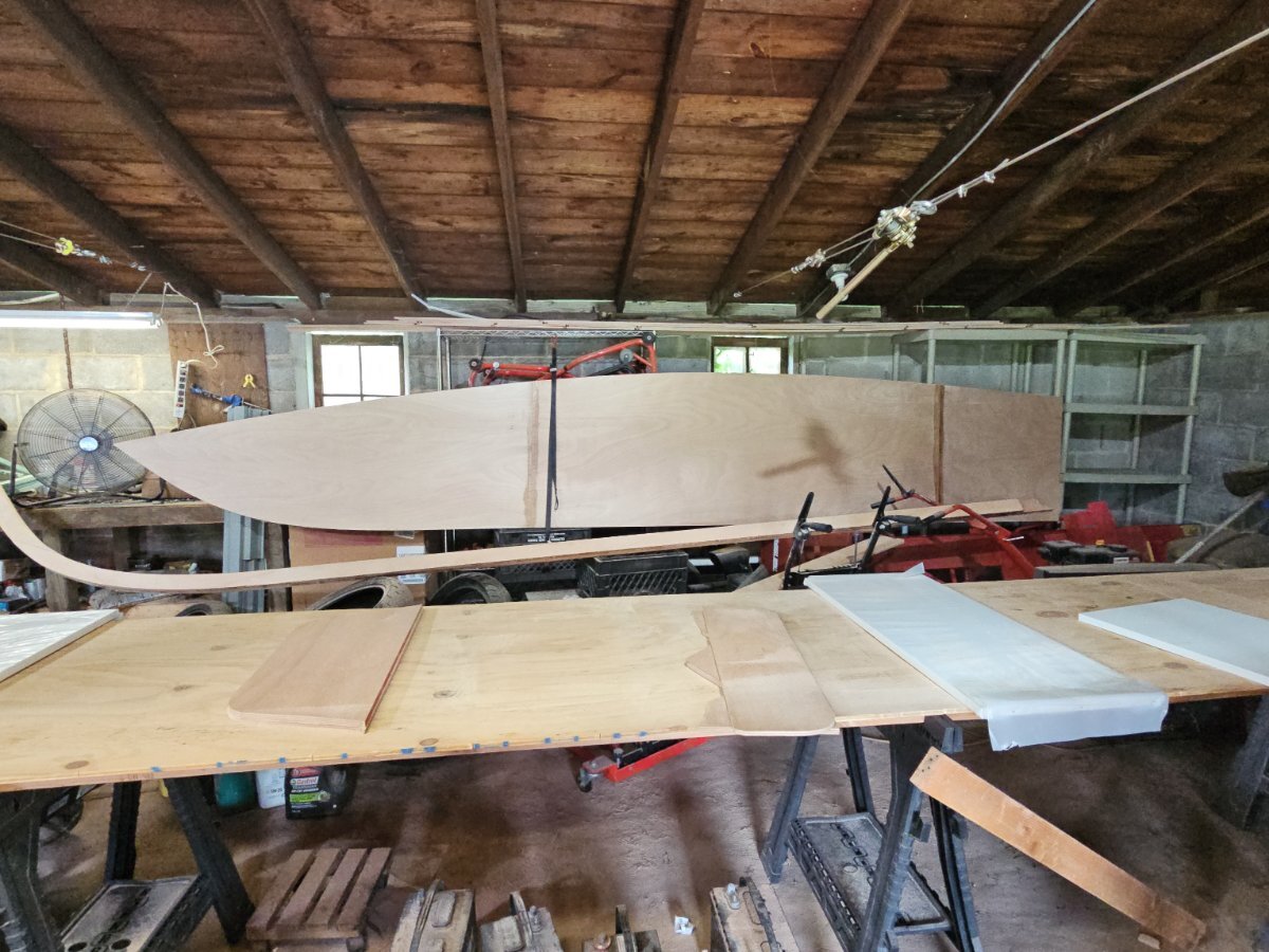

I came up with a way to glue up the long panels indoors, it just prevents me from doing much of anything else while I'm waiting for the epoxy to cure. I just have the sides which I will be doing later today then all of the long panels are done and I can start making the strongback/jig. The scarfs came out really good except one which I must have placed a little over the mark when I glued it, there is a step up in thickness that can't really be seen but you can feel it when you run your hand across. I should be able to fair it out easily once it's installed. I clamped and screwed everything together before cutting things out and planed to the lines so everything is mirrored nicely.

I used the West scarffer. I temporarily removed the guard on my circular saw and used an 8" blade with it, that gave me the 3 inches with my saw. I practiced with some scrap to get it set up (it is a little fiddley getting the perfect angle) and only had one that I had to trim back and redo. If I was to do it again, I would have just used planes but it was too hot in the shop so I went the "easy" route.

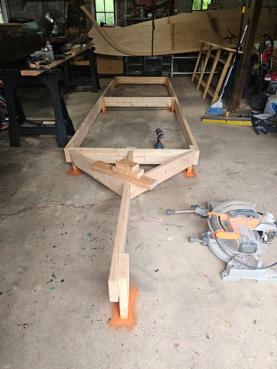

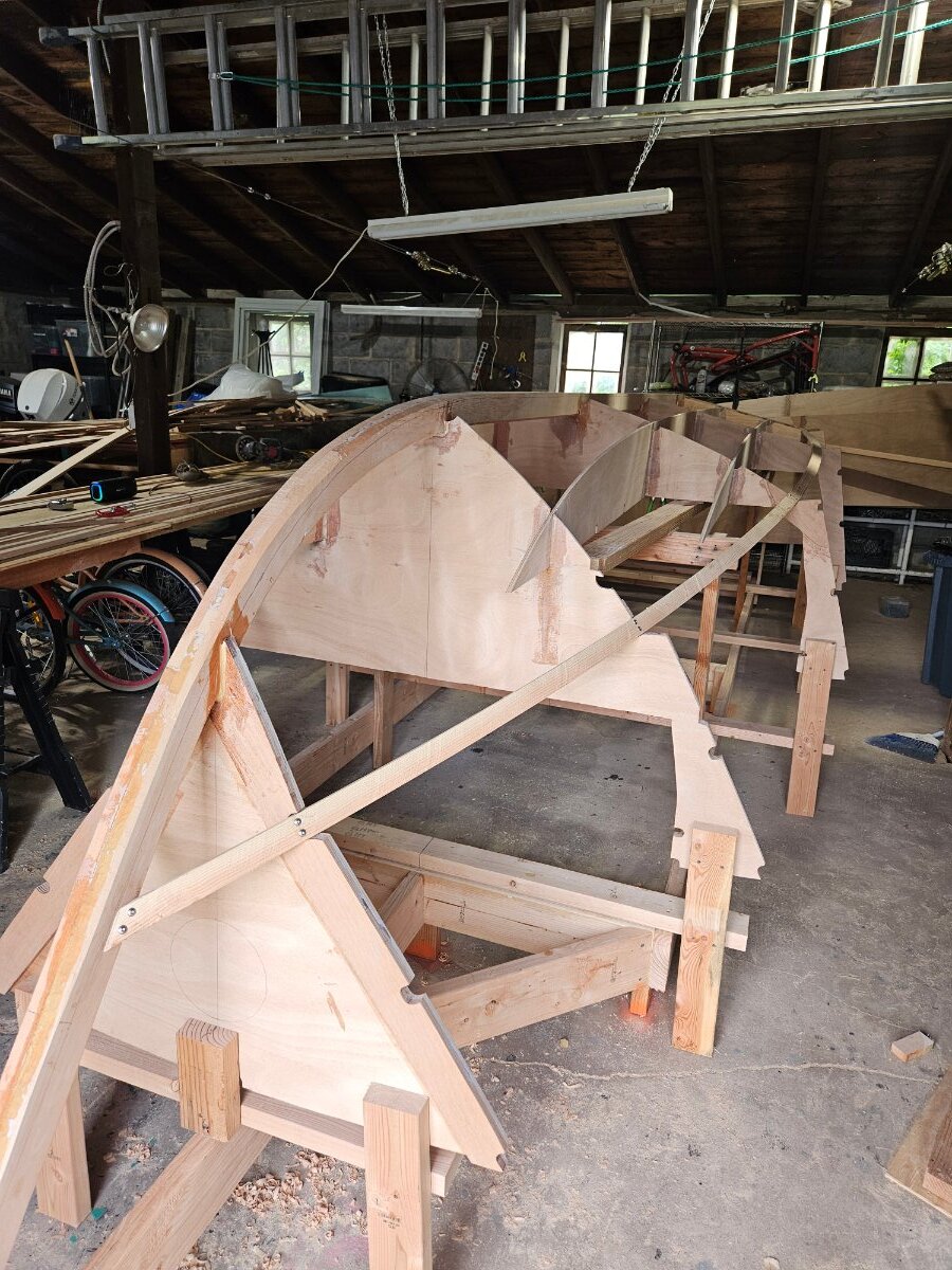

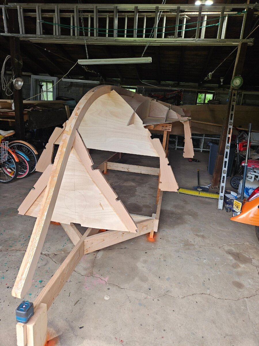

Got a strongback knocked together squared and leveled. I threw down some spray paint on the floor so if I need to move it, I can put it back in the same location and maintain level. I will be putting a few more legs on it once the uprights for the frames are in but I can walk on the edge without deflection so it'll work as is. One step closer...

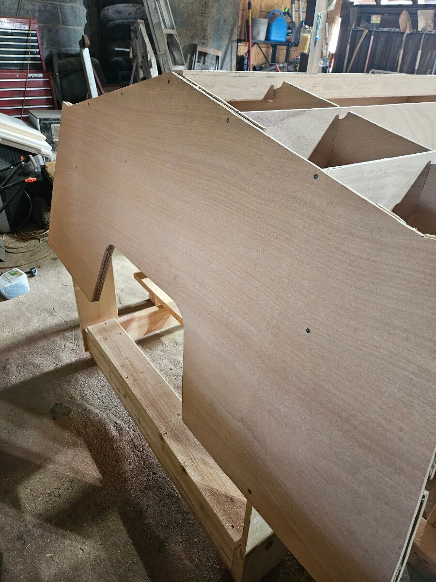

I got a little impatient and wanted to see how everything fit together. I do have to clean up some edges and fine tune a couple of areas but it slotted together nice and square. It may be a little bit before I start gluing things together but seeing a bunch of plywood look like this really got me going! I wish I had more time to devote to this build but it is what it is. She'll get finished eventually.

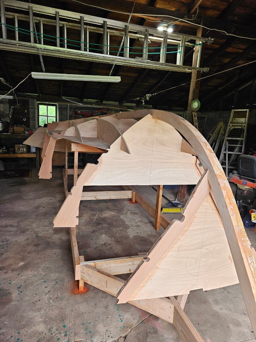

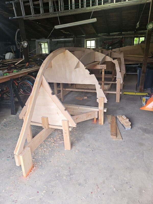

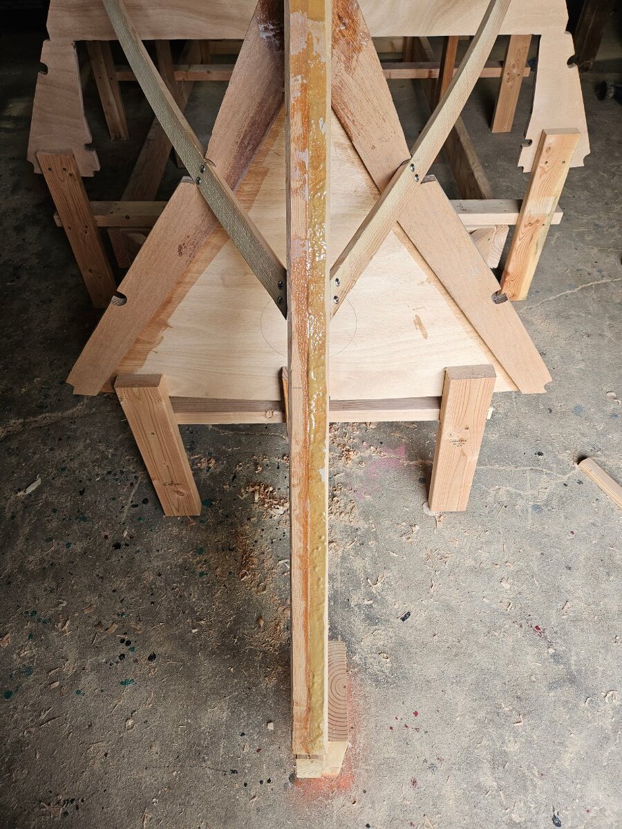

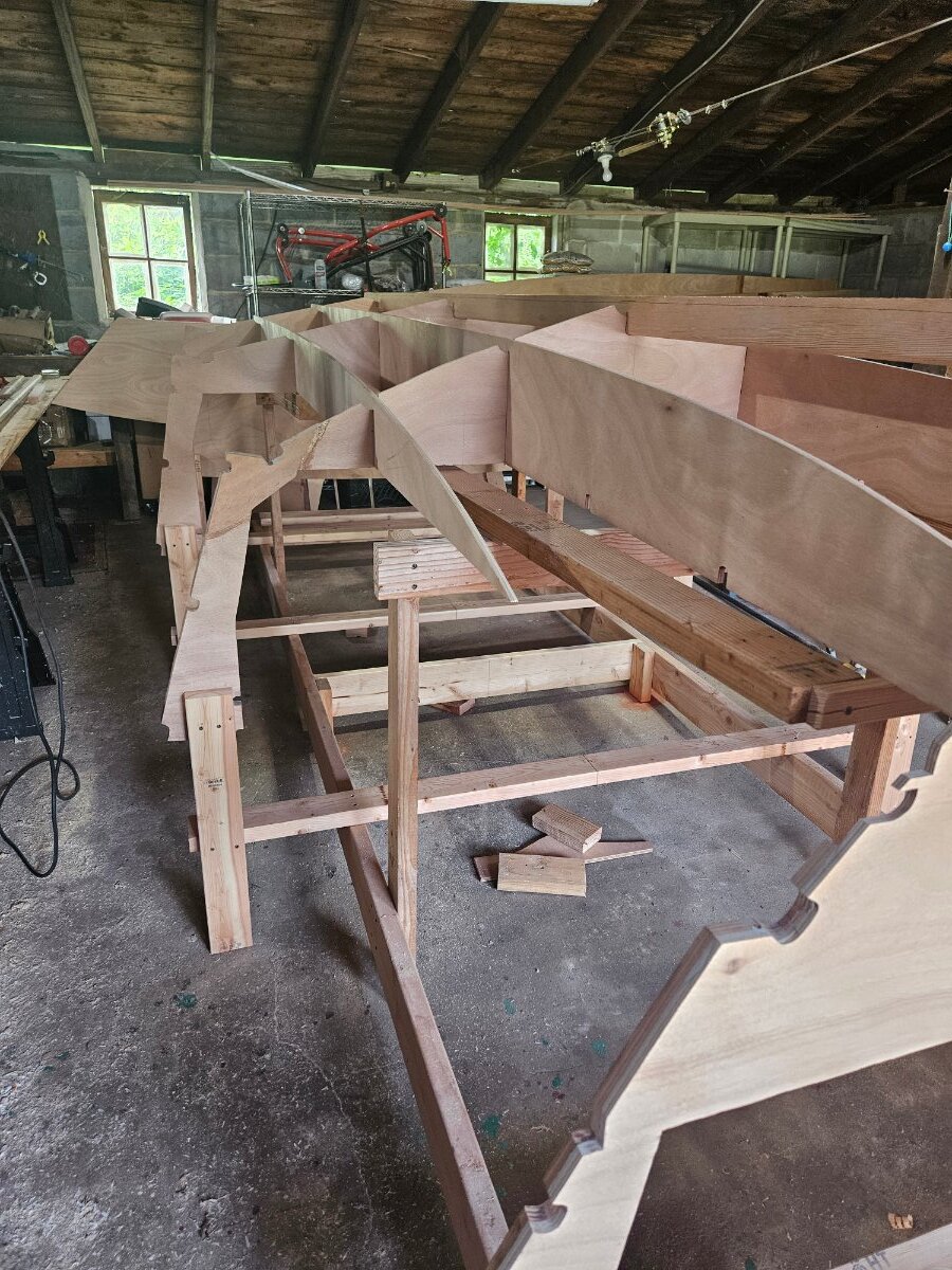

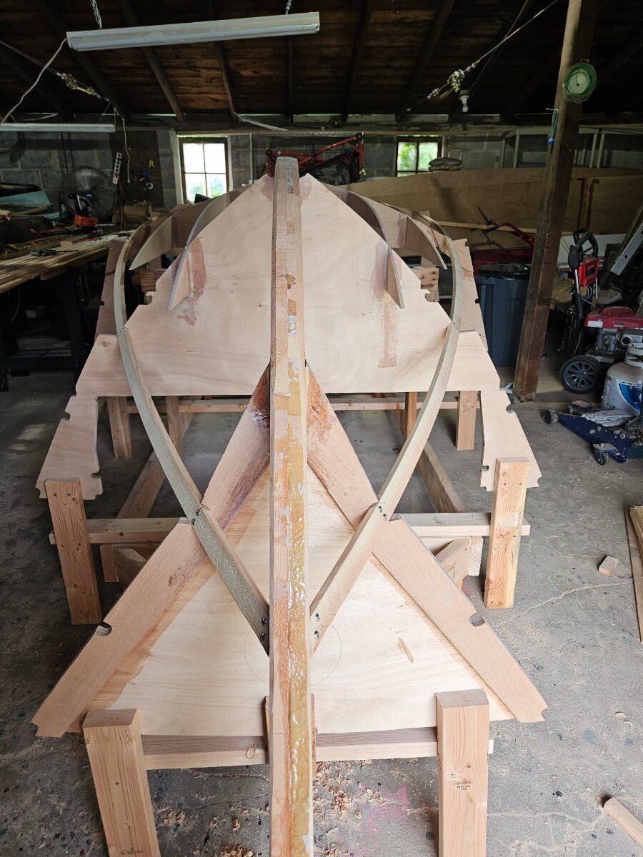

Thank you Frank for your tireless work on the forum, it is greatly appreciated! Bit of an update. The way I had things set on the strongback set things a touch too high for me (I'm short) so I lowered everything a bit so I could reach better. I got everything squared up and leveled and added some more support to the frames. I had some difficulties hanging the transom until I asked for tips and used some temporary screws. I got that fitted and glued, did some fillets on the fames and stringers, and fitted the chine battens. I will glue those on Thursday and start shaving down the keel. I didn't have any problems with those battens, even with using douglas fir. Maybe it was because I used 2x stock and the way I ripped them made them pretty much quartersawn. Or I just got lucky. Either way, I'll take it!
