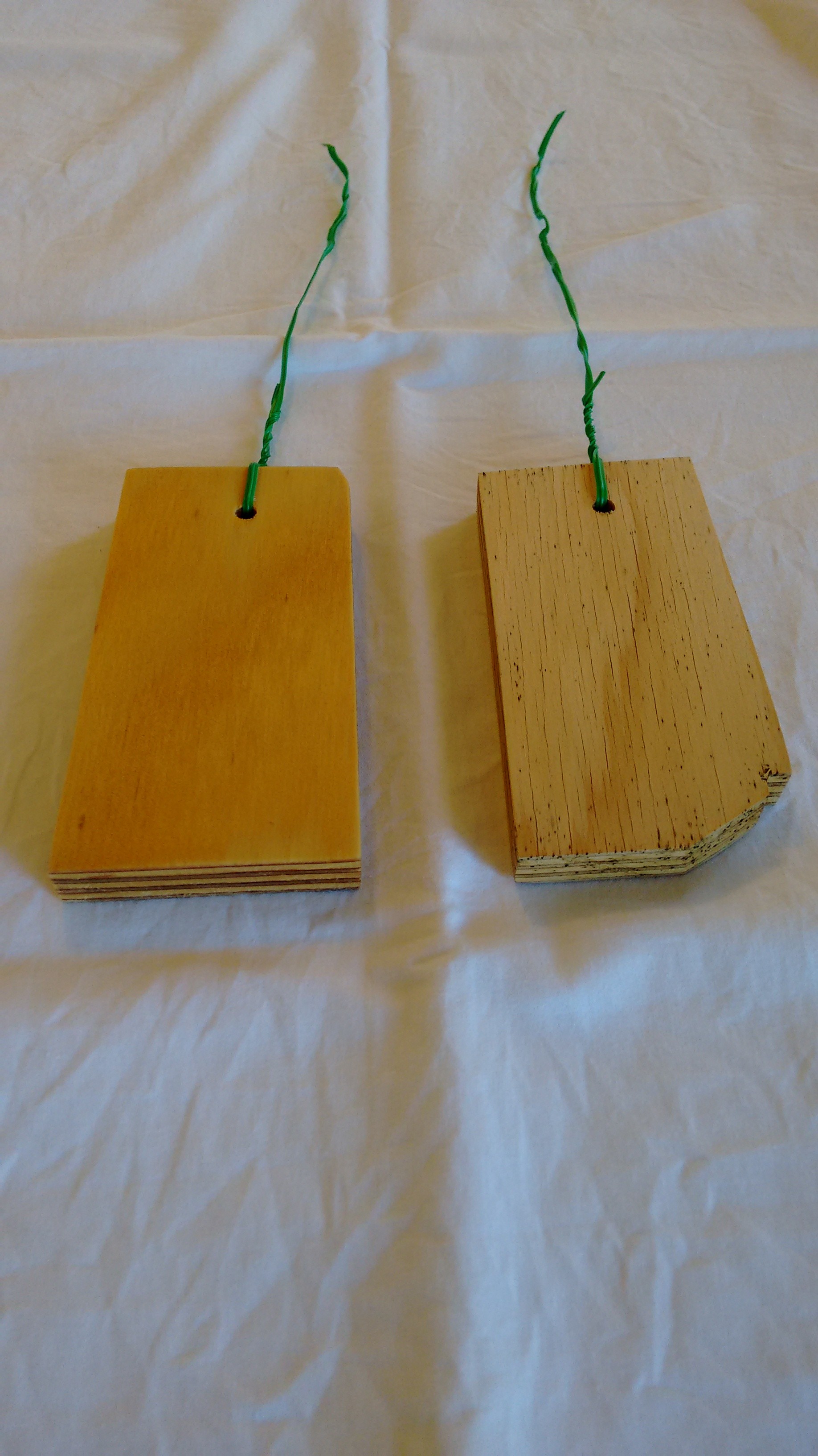

Quiet Posted August 25, 2017 Posted August 25, 2017 Earlier this year I put up a few posts regarding sourcing suitable plywood in Australia. I ended up going with Hoop Pine Marine ply and am currently cutting the frames for a Ravenswood. (Very slow progress I know, but that’s another story). At the time I thought some simple testing of the plywood might be in order, so I took 2 off-cuts and hung them on the back fence over winter. One was left raw, the other coated with 2 coats of pure tung oil. Winter here tends to have a lot of heavy fogs that hang around all morning and lots of nights below freezing. Once things get damp they can take ages to dry. After a full winter the tung oiled sample is like new. The raw sample has numerous small mould spots all over it as a result of staying damp for extended periods. Neither sample looks remotely like delaminating so the glue seems fine. The raw sample also has fine cracking along the grain on all exposed surfaces. My guess is this is a result of the water that soaked into the plies freezing and expanding during the night and so cracking the timber, much the same way it gets into fine cracks in rocks and eventually splits them apart. That’s just a thought bubble though and if people have other theories or better explanations I’d be happy to hear. The samples are back on the fence now. I want to see how they cope with our hot, dry summers. In particular I want to see how the tung oil stands up to our rather ferocious UV levels. In the meantime, back to the Ravenswood. Thank goodness it isn’t a race. Quote

Quiet Posted August 28, 2017 Author Posted August 28, 2017 Thanks Benhardt57, I looked at them early on in my selection process and might trial the ply at a later date. Problem was, I couldn't be sure the Baltic Birch they sold was the same as Jeff recommended. Heard lots of good things about the Hoop Pine so ended up going with that. So far it seems to be really nice to work with and the glue is definitely waterproof. Andy00, I promise I won't hang the kayak from my back fence. Having said that, it's amazing how much protection the tung oil gives the wood. The test sample really does look like new, with none of the dirty weathered appearance timber gets when left outside raw. Thanks for the inspiration picture. There's not much I can do about the current slow progress and it's nice to see completed craft. Gives me something to aim for. The building is fun in itself as well so whilst it will be nice to see a finished kayak, I am thoroughly enjoying the journey along the way. Quote
