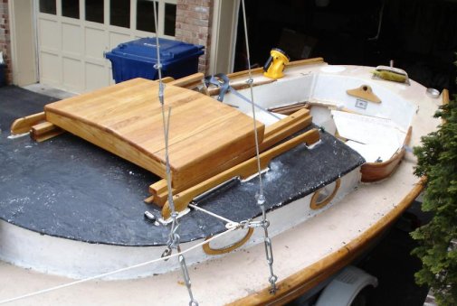

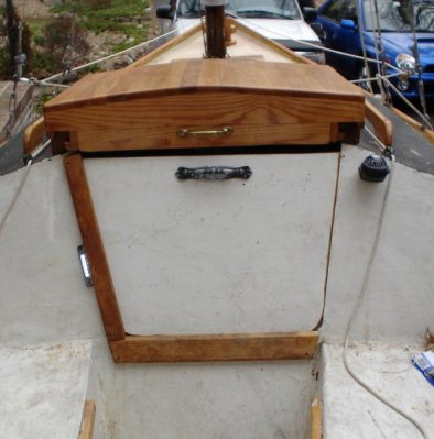

  4. Also need to put a stopper on the end to prevent it from flying off on the highway during transport and to create a good transition from the bulkhead part of the hatch to the cabin roof sliding hatch. Right now, as you can see, there is a gap and one of the peices holding in the bulkhead portion is missing. Once I find that and reinstall it I will add the other LED cockpit light (as seen in the following picture).

  7. I think this is a neat looking hatch. My only concern is how much does the system weigh? Did it change the boat's balance any? What is PL Premium? I am not familiar with that glue. The hatch does weigh a lot, I really couldn't put a number on how much. I'd say more than 10 pounds, but I really have no idea, next time I am in Allentown (where my boat is right now), I'll check how much the hatch is since I do need to rebalance my boat. The batteries and anchor in the forepeak has put my center of gravity too far foreword without a larger crew. I'm not sure on how much it threw off the balance, certainly not more than my batteries. The 3/4" thick oak is also a bit heavy big for the application. You could easily do something sufficiently strong with something 1/2" and in a lighter wood (cedar is good for both its resistance to decay and its low density if you're looking for lightweight). PL Premium is a construction adhesive sold at Home Depot and a number of other places. It is sold in tube canisters like caulk. It is not the best for brightwork like hatches because it when gets everywhere it's tough to get out and it dries hard in a really ugly brown color and it can have a bubbly texture. More information on it in boating applications can be found at this site: http://www.simplicityboats.com/pl_premium.htm. I haven't had any trouble with it besides getting it off of things. In retrospect I should have used it more on my boat than I actually did.
  8. Found a picture of the hatch in action from last week. I still have to attach the bottom of the inside track pieces and figure out what I am doing to the back of the hatch. It slides pretty easily from head on but is tough to do it from an angle. It's red oak encapsulated in epoxy and with varnish over that. It was glued together using PL premium. Red Oak is not the best choice, but the wood was free and I already had some oak on the boat, so it made sense at the time.
  9. Those hatch drawings and pictures, except for the second one which is Barry's, are from the hatch I made Fall 2003 for my Weekender. I should be able to find some pictures that I could post of it actually being attached to the boat. The slide works pretty well. I am still trying to figure out if I am going to have to build a turtle hatch shell to keep water out of the cabin, since it can get in from the back and I need to make a new connection with the vertical part of the companionway. Just one of the many projects I have going for this Spring.
