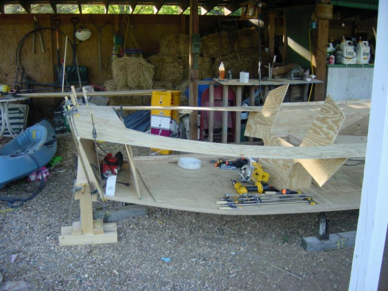

Got some help this weekend and was able to get the sides on. Okay forgot about the small triangles that needed to be cut on the bow until my buddy said "whats wrong with the front". Looked and looked and then looked again too long. Then said "Oh! thats is in the plans you have to cut those to fit after". He looked at me all day. Cut and fitted them yesterday will have to have him back to see that it fit fine. Tonight was working on the upper rub rail and it is looking very nice. Still a clamp forest and just dry fitting. Did not get much done my daughter's 7th b-day and had to replace the alternator on my wifes truck. Was on the way to a party at church with the kids and it went out but it was nice that the party came to us. Will post some pictures of the sides when it is cleaned up but will at least post one with the b-day girl and little sister from this weekend. I say crew but they say captain and admiral. At this point they think that my job will be to scrape the barnicals off the bottom.

Got some work done this weekend after completing the honey do list. It it so cool that it is starting to look like a boat. Still need to attach the upper deck. Only a week back from my time line. Funny how you think this will only take 2 days and it take a week when you find a problem. NO there are no clear pictures if the stem it is looking good but still needs to be cleaned up. I have to tell you about the problem so I am not going to post a picture until is is looking nice.
I got the stem rebuilt and put the stringers on the upper deck. Let everything dry ( it was killing me). and just 10 min ago went out and pulled the upper deck back to the transom and it went clunk and fell right in to place with the exception of the port side companion way. Need to made the gap for the stringer 1/8 wider. It was a goodnight and goodnight. Will post pic's of repair after it looks pretty. Jay

Okay Have my new wood and my cut has be cleaned and squared. Test fitted everything with adding 16" (NO I only need to add 8.5" but wanted to be able to test fit and then cut down the bits when I had the correct numbers) Still have no idea how I could have been so far off. Even if I installed the stem parts upside down the high would have been wrong but so would the angle and my angle is fine. Maybe I cut the lower angle wrong and then install the parts wrong and I got the wrong height but the correct angle. Don't know and not going to worry about it anymore. Thanks again to everyone and I just want to say that it was wonderful that I posted the problem and within 20 min I have 6 - 8 replies. It let me get right to work on fixing the problem and not walking around and around the boat grumbling under my breath. I will post some pictures when it is complete.
