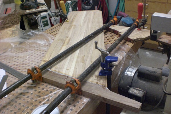

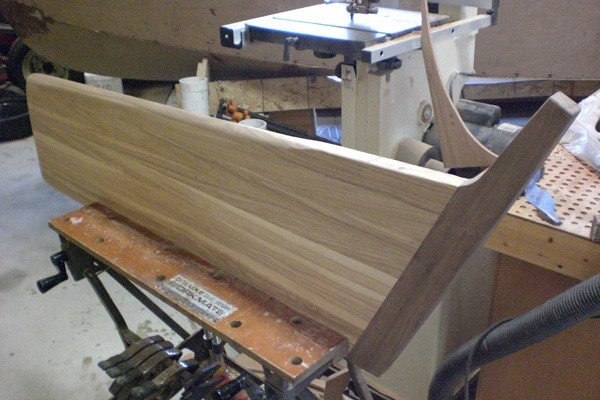

Here are some pictures of the centerboard and the trunk sides. The centerboard is made from Ash and Walnut. The Ash is from a tree I cut down and the Walnut came from a tree my son cut down from his backyard. One of the members of the woodworkers guild I belong to has a sawmill and cut them into boards for me. It's been stacked and drying in my basement for @ a year. Rod, Good looking oars. A good idea with rocks. Hopefully I won't have to use oars too much, but you never know.

I have finished building the centerboard. The plans say that it's best to fiberglass the inside of the trunk and the centerboard. Is it necessary to fiberglass the centerboard even if quarter sawn wood is used instead of plywood?

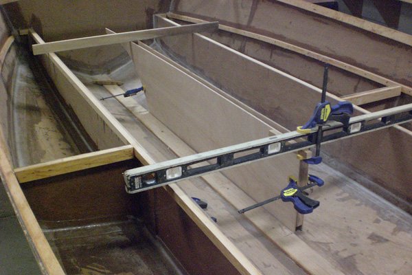

Rod, Thanks for the pictures. I don't know why I was having so much trouble figuring this out. What is the purpose of the curve on the front of the CB trunk? Is it just for looks? Randy
I'm done building Christmas presents and it has cooled off(it was 4 degrees this morning), guess it's time to start working on the boat again. I'm getting ready to build the CB trunk and probably making it harder than it really is. I'm a little confused. Does someone have a closeup picture they could send or know where one is? Thanks, Randy
