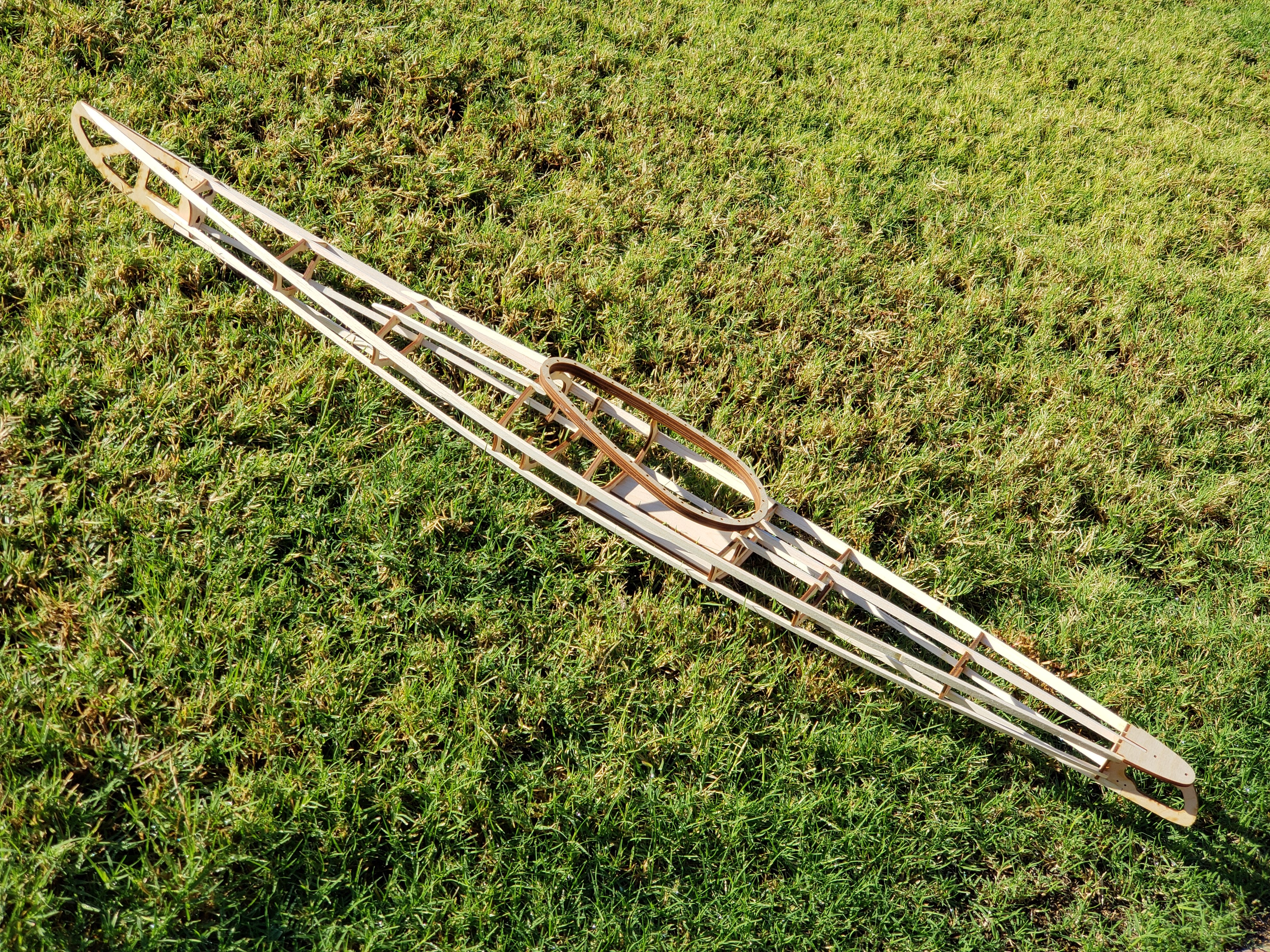

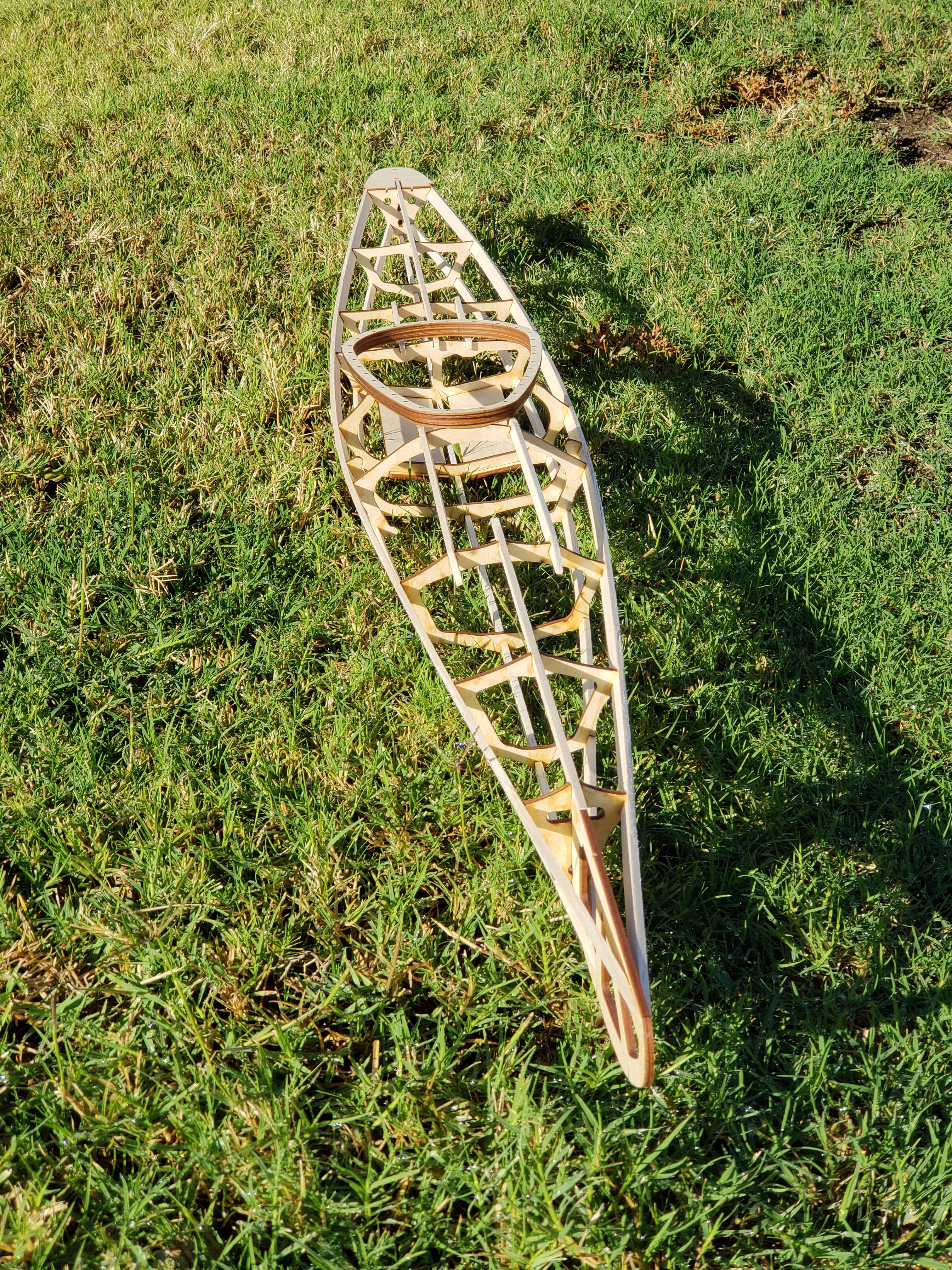

  9. It was cheap and easy. It assembled in a couple of hours, including the strongback and the stringer splices. I won't cover this one because it looks amazing like this. I was going to dope and tissue it like an old model plane. It was about a square foot of 1/8 ply and 3"x36" 1/8 balsa. I'd like to make one of each from the books and also a Nimrod.
  10. I built this one for motivation to build a real Curlew. I'm excited for that build. This is 4:1 scale. My foot fits perfectly in this one. My other kayak, Barta has a mix of hand-made and laser-cut frames. The real Curlew will have all plywood parts lasered. This was lofted from the book using the plywood coaming option. The coaming support is integral to the custom under-the-knee frame. My only question about the design is how well the frame near your feet handles the bending load of 3 deck stringers ending right there. I imagine that it holds up well because I have not heard about any failures.

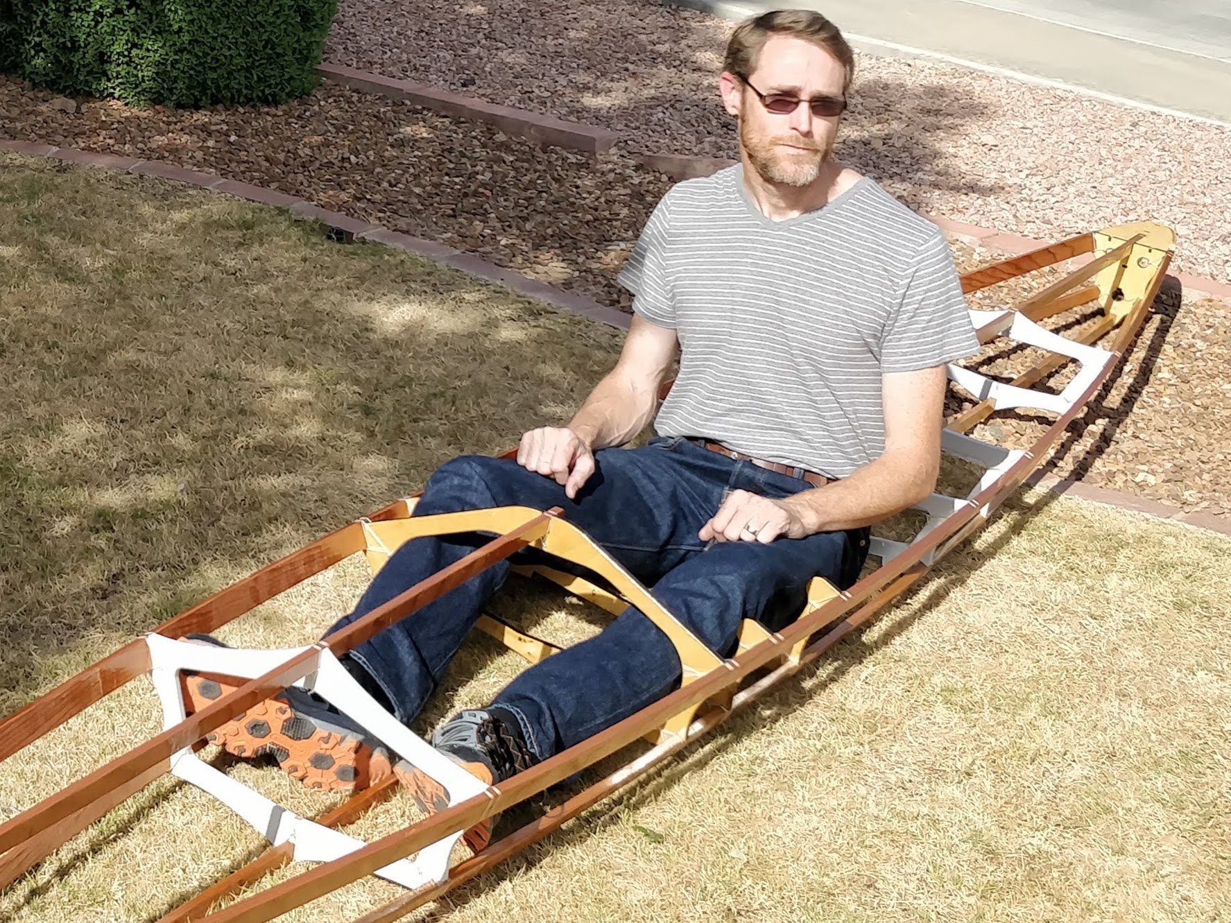

  11. At 6' 3", this is how I fit into the 17' Poco Barta with my size 14 shoes. I lost a couple inches of room after adding foot pegs.

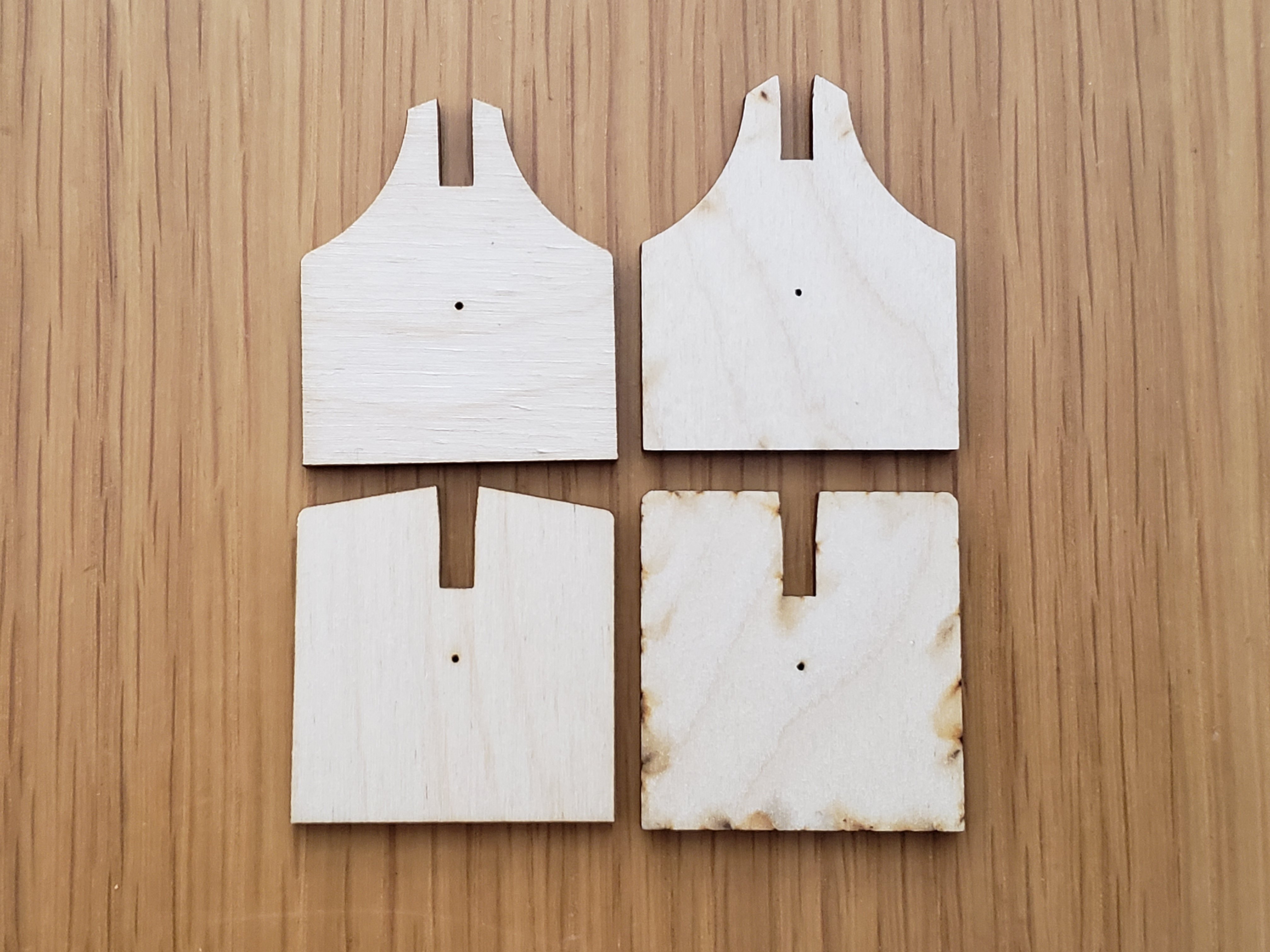

  12. Ok, I think I see it too. It looks like you'd clamp them with Titebond III to their appropriate bow/stern piece.
  13. I'm not familiar with Shad's design, does the bottom notch at each frame accept a bow/stern or a stringer?

  15. I wondered if anyone would notice the 1/8 ply. It's a 1/4 scale prototype for my daughter's full size Curlew. The bow and stern assemblies tab together.
