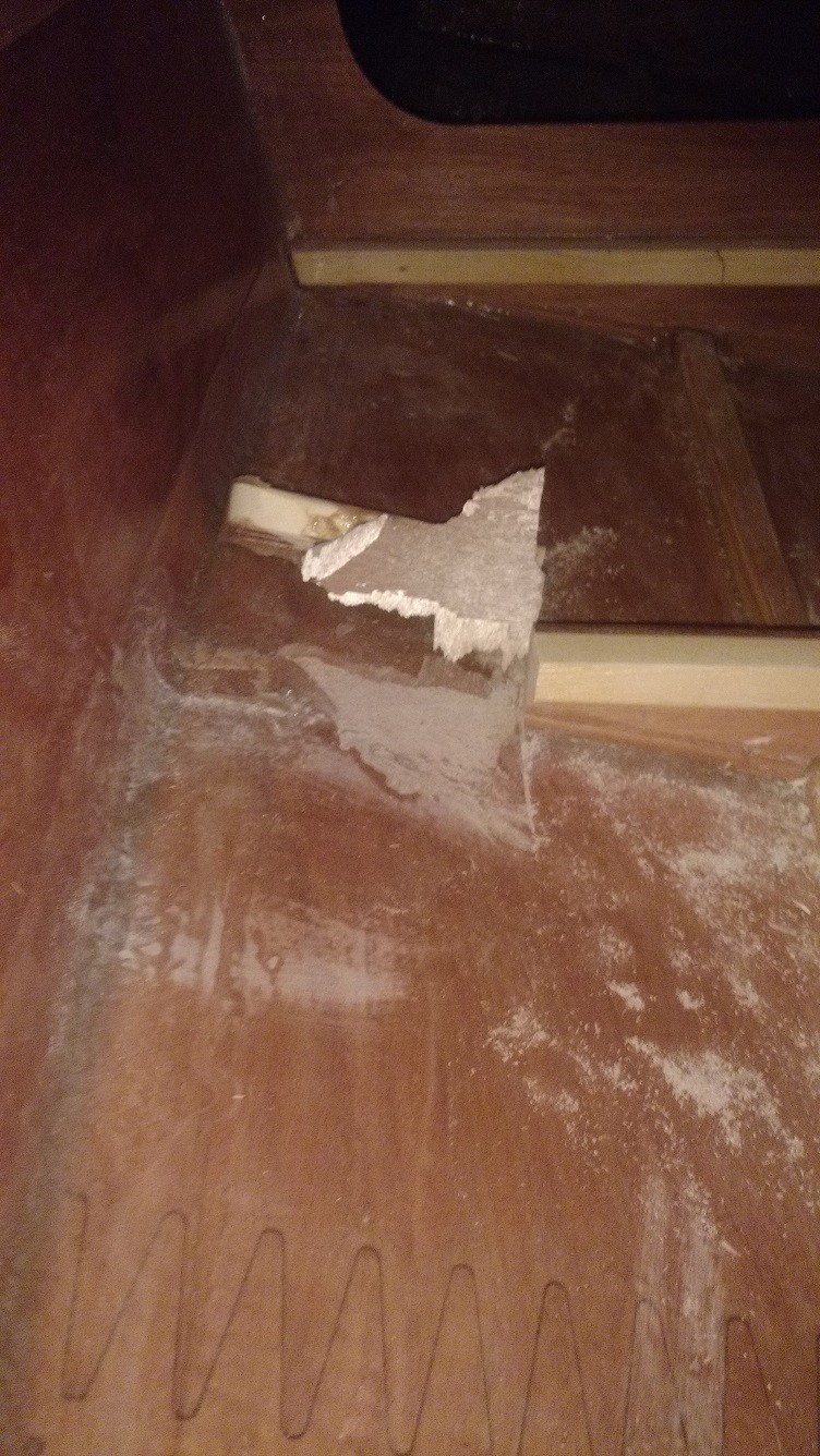

  2. Chick and Graham, Thanks for the feedback. It is all so much easier to see AFTER the failure. I'll get her straighten out and fixed up in the next few days. There still remains another question, though. The longitudinal trailer bunks are designed to carry a big motor at aft on the boat and don't provide much or any support forward. I fashioned a small support under Bulkhead 1. But I don't think I made it high enough and as a result, most of the weight of the boat was supported under Bulkhead 3 where the webs broke. How do I adjust the height of that forward support so that boat weight is properly distributed, i.e., not "high centered" like it was but not suspended between the bow and the stern either??? Hal

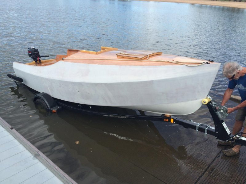

  9. Well it's official. I splashed Just In Time last week (Sept 2nd) and verified that she floats! Unfortunately, while my motor seemed to work just fine in the garage, I couldn't get it started at the dock. After a little carburetor surgery at an adjacent beach I was able to get it running at and slightly above idle. But it needed a lot of choke to run at higher throttle. Still my daughter, Rachel, and I had a good time on our first mini-cruise. You might note that the paint is a little less than stellar and that I don't have many places to tie things. She has the bow eye, two transom tie-down eyes and one cam cleat. And my cabin hatch attachments are less than rock solid. Screwing into 1/4" plywood with the hope that the screw points won't protrude and rip something is always a bad idea. During the next few days I became much more familiar with outboard motor shops. But I finally found a good Nissan shop who confirmed that the carb has TWO overflow tubes and that the critical jet is accessable from inside the float chamber. So I was able to clean out the gunk and get it running like it should. After waiting for the Labor Day crowds to dissipate, I've gotten out another couple more times this week. Motor runs fine. Though I forgot to bring the GPS I'm pretty sure I'm pushing 9-10 mph with just me aboard. With my friend, Paul and some more supplies, we confirmed about 8 mph. Despite great performance, I've realized that I am NOT a motorboater. The noise and vibration is inconsistent with my expectations of being on the water in a beautiful boat. So I'm working on getting at least a downwind rig functional yet this Fall. All in all, the boat's performance meets all my expectations. She's solid and dry under the mild conditions I've seen so far. And seems so light compared to my my expectations that I'm blown away. I look at this enormous hull (compared to my other boats) and expect heavy and slow. But that couldn't be more wrong. Now I can't wait to get the sailing parts done and get her on a broad reach in some decent wind! Hal

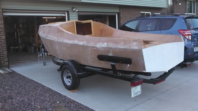

  12. Ok, Ok! I like to see your pictures too. So, hopefully, I'll be able to figure out how to post a couple of mine: This is my baby sitting on her new trailer and enjoying the outdoors for the first time. The trailer needs some sort of hull support forward because the nice bunks are designed to balance a tail-heavy motorboat. What's one more thing to build, eh? I DO like my trailer, though. It has a fold-away tongue and can fit inside the garage. That will help keep the rain and snow off. The white transom is the result of two coats of Awlgrip Epoxy Primer 545 which came out pretty good for a primer. The bottom, which you can't see, is also done that way. Those two areas were all I could squeeze out of one quart of paint. Now that I see how awful the boat looks with white filler in various places along the sides, I guess I have to get some more primer and clean things up a bit more. After much consternation about what paint to use, I think I'll stay with two-part epoxy primer so I don't close the door on an LPU finish. But I'm shifting to System 3, water based primer. Hopefully the smell will be a little easier to take. The plan is to make the boat "presentable" for a first launch in August and then do the fine finishing this winter. This picture shows my hatches from the outside. Sorry, you can't see the bungie cords that will hold them in place. Not because they are on the inside of the cabin. But because I haven't attached them yet. There will be one, double cord over the aft part of the aft top hatch that will button things up when I am outside of the cabin. That one isn't installed yet either. I probably won't get to that part of the project until I return from a week-long raft trip on the main stem of the Salmon River starting soon. I PROMISE, I'll post some more pictures of that hatches when they're available. Holy Cow! I just previewed the post and saw that I got the pictures in ok. Amazing!
