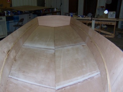

    CS20 #80
    Thanks for the tips guys. I'll probably need all the help I can get. Jeff, did you put the forward bulkhead in before tightening the bow wires? At the bottom of the "HULL PANEL INSTRUCTIONS" sheet my plans say "Drill and wire tie the butterfly. Wire the bow firmly and the keel line loosely. Open the butterfly out, the bow is drawn in and the wings fly out to the sides." That's how I did mine and was pleasantly surprised at how well it worked. The 12" butt and tape joint attaching the sides to the bottom didn't seem to have much strain on it and I didn't need to tighten the bow wires after unfolding the panels. I do like your all thread bolt idea for closing the gap at the bottom of the forward bulkhead. I have about a half inch gap that I'm going to try to close with some more wire adjustments but if that doesn't work I may try the all thread.
  21. Brad
    CS20 #80
    Jeff, did you curse like a sailor and use a big hammer? Graham seems to have left that part out of the instructions.

  24. Starting to resemble a boat.
