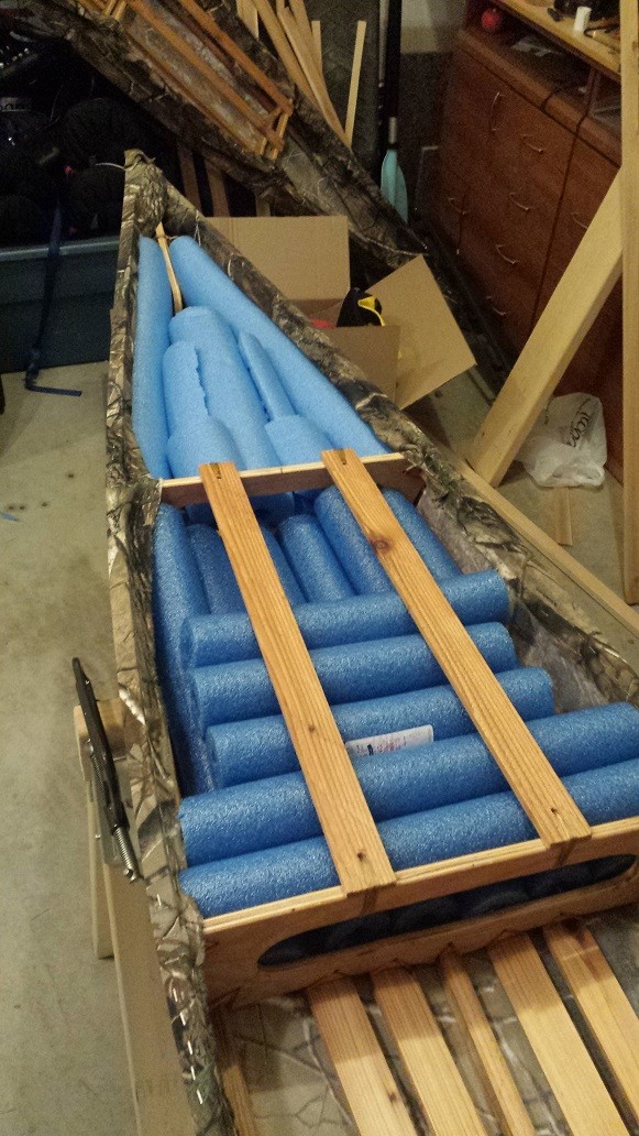

  2. Thanks - looking forward to building a rowboat next - maybe Flyfisher - possible in Sept - as the water may get too cold in October to kayak (for the kids, in case they flip it) and it is fishing season. I must add - that the flotation works really well. Unfortunately, one of my kids flipped over. He had trouble getting out of the boat, but kept his head above water. I swam to him, after jumping from my canoe, and flipped him back over quickly and easily. The boat was full of water, but was still able to paddle - due to the pool noodles. We spent the next week practicing getting in and out of the kayak. Point is - there is no substitute to having a parent nearby, preferably in a boat, and practice, as well as some solid flotation.

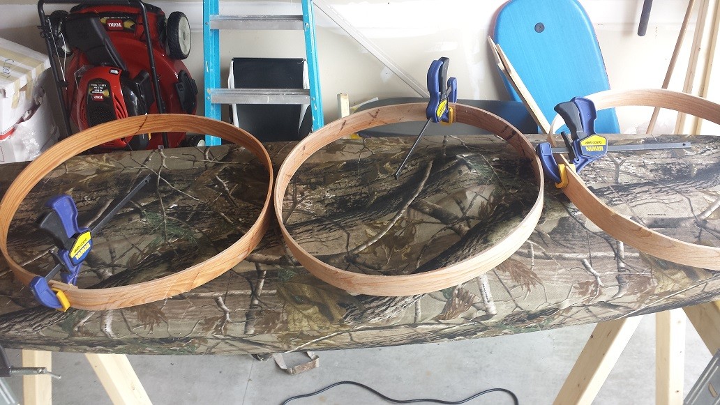

  4. Here are the pics - same fabric from the ebay seller - it takes on a darker color with the Spar - I was able to pull the cloth tight and did not use an iron.

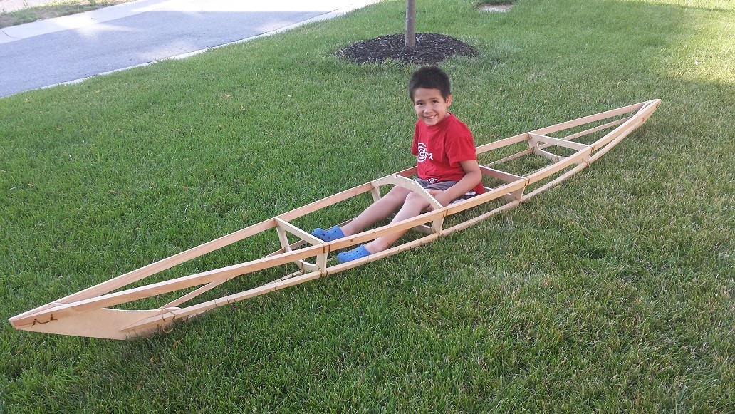

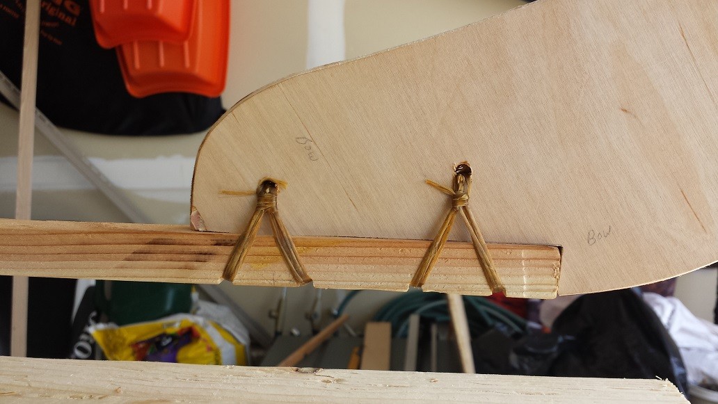

  8. I wanted to share what I have been working on and what I have planned, in case it helps anyone in the future. I am building two kayaks for my kids. They are both twins and 7 years old - so I am building 11' boats for them. I started by reading Jeff's book which came with a few plans. I have to add that the book is very well written and very easy to understand. I have been using the techniques described in the book to build my kayaks. My next project will be a Ravenswood. Being a kids kayak - I was not too anal about my materials. I used Purebond baltic birch from Home Depot. I found some 11oz, uncoated camo poly as well - (kids choice) to use as a cover. Western red cedar stringers and lashed everything on the boat - no screws, no glue. Pool noodles for flotation. The boat is not Jeff's design, so please don't ask out of respect to Jeff's design. I have used his book extensively and plan to purchase plans for Ravenswood.
